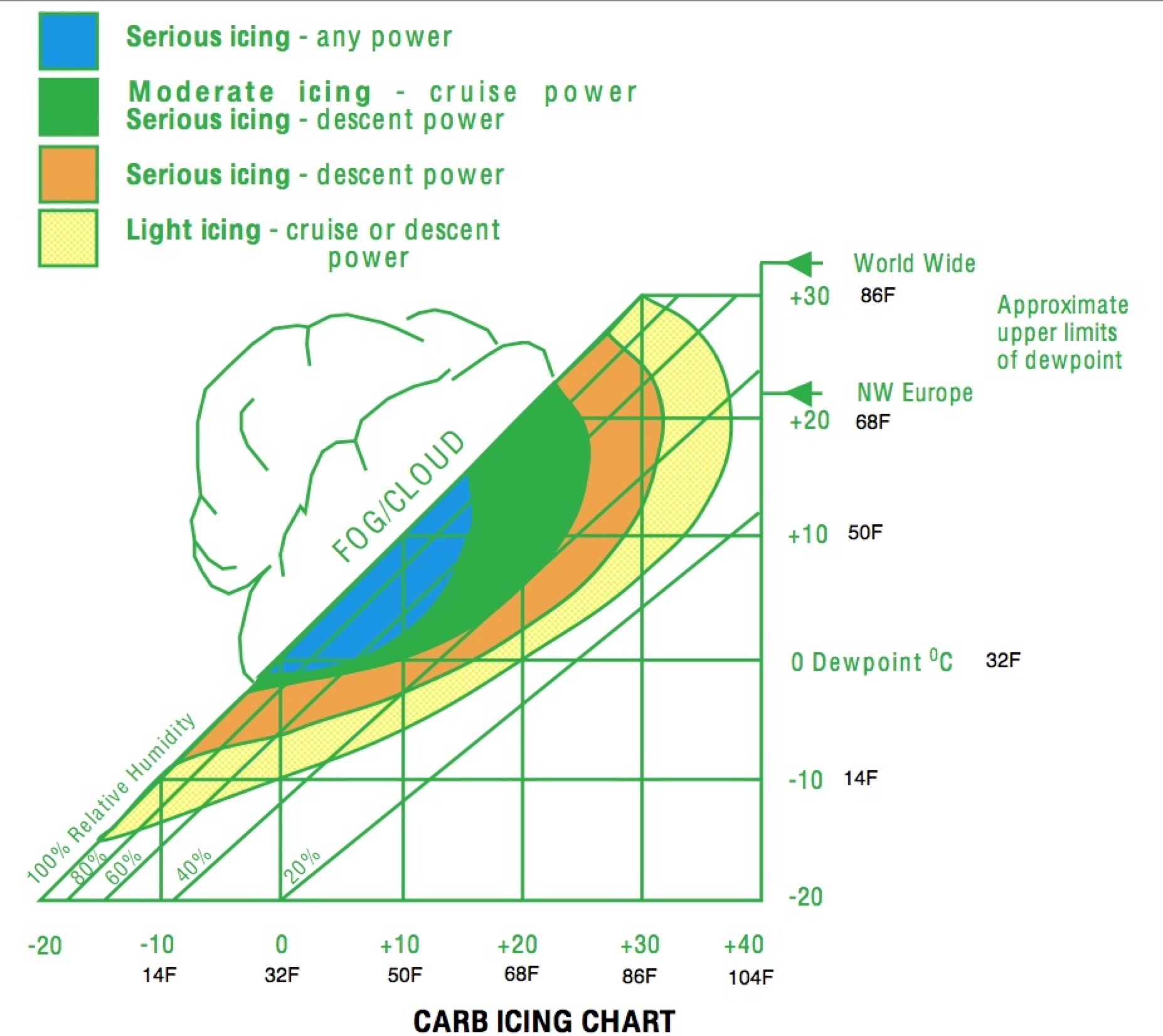

PostPosted: Wed Jul 29, 2009 10:43 am    Post subject: Re: Power loss Reply with quote
Carb ice is actually quite possible in high humidity conditions at 80F. See attached jpg image of a carb icing chart.

It _does_ sound like carb icing. I hesitate to say that because I chased
carb ice on one other hot humid day and the problem turned out to be
jetting related, and carb ice is nearly impossible to prove... but
conditions were certainly right... 80F on the ground, chilly and 99.9% RH
at 2000' where I was flying at low cruise power. I now think the jet
change I did right before had nothing to do with it, just a coincidence.
