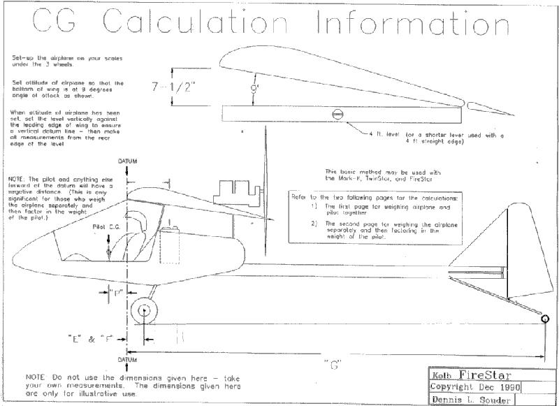

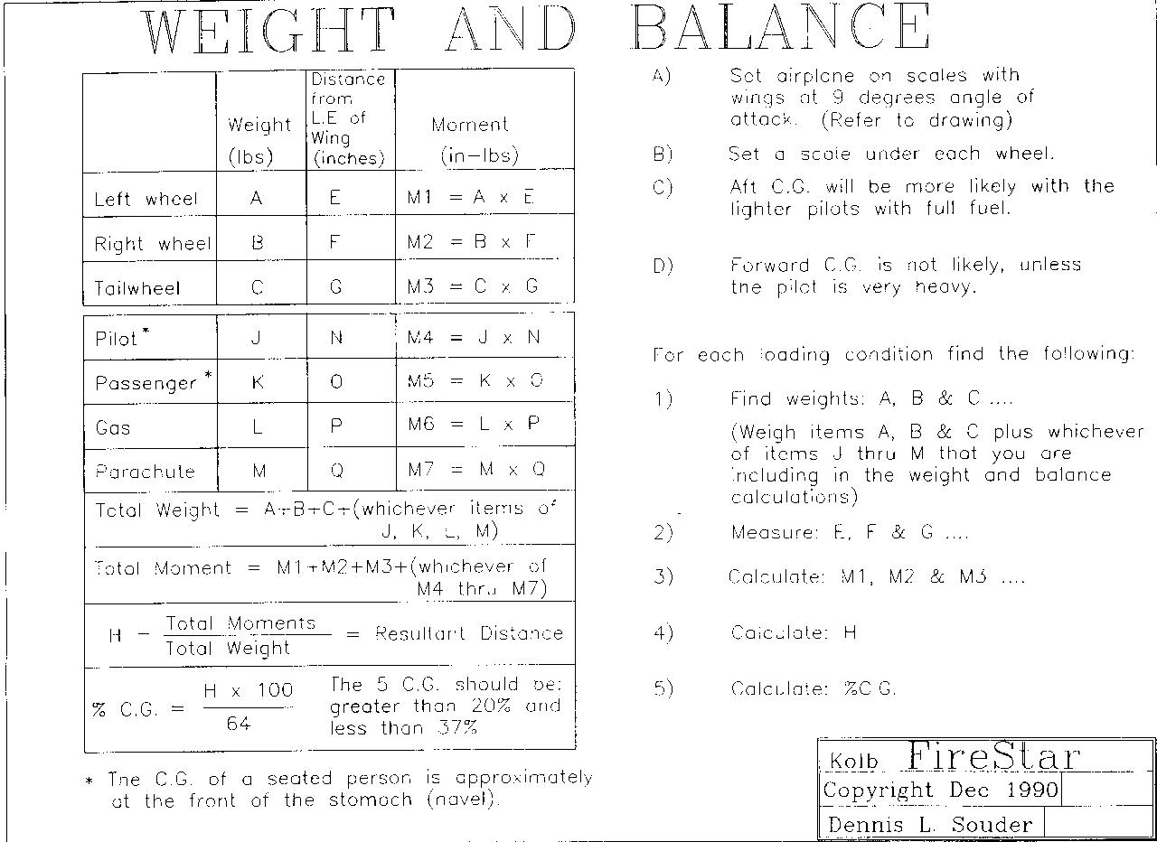

The plans for the Mark3x say the bottom of the wing should be at +9 deg. when doing the W&B.
The form that comes with the certification guide from EAA states the aircraft should be weighted in level flight attitude.
My question to those who've had their Mark3x inspected ------ What attitude was used for your certification W&B ?

PostPosted: Wed Aug 05, 2009 3:26 pm    Post subject: Re: Weight & Balance for certification of Mark3x Reply with quote
I don't have the book in front of me ,but how we did it to my m3x was we put a level from the trailing edge of the wing (not the end of the flap) and brought the forword end of the level down 7 3/4 inches from the bottom of the leading edge of the wing,the raised the tail until the bubble was level.That was level flight.then dropped a plumb line down from the leading edge and that is where you measured from for all your stations.
chris ambrose
M3X/jab 43.3
N327cs
Possums
Joined: 03 Nov 2007
Posts: 247
PostPosted: Wed Aug 05, 2009 3:43 pm    Post subject: Weight & Balance for certification of Mark3x Reply with quote
chris ambrose
M3X/jab 43.3
N327cs
Here's how we used to do it.

PostPosted: Wed Aug 05, 2009 4:01 pm    Post subject: Re: Weight & Balance for certification of Mark3x Reply with quote
That's it ! I couldn't remember exactly if it was 7 1/2 or 7 3/4....but that is how I did it..

PostPosted: Wed Aug 05, 2009 5:40 pm    Post subject: Weight & Balance for certification of Mark3x Reply with quote
Chris
How long was your level?
chris ambrose
M3X/jab 43.3
N327cs
http://forums.matronics.com/viewtopic.php?p 56248#256248
ces308
Joined: 03 Nov 2008
Posts: 317
Location: houghton lake ,mi
PostPosted: Wed Aug 05, 2009 5:49 pm    Post subject: Re: Weight & Balance for certification of Mark3x Reply with quote
It was a 4 feet level....it went from the wing trailing edge to the leading edge. I would not go buy the horz stab....do the wing thing...my tali wheel was up quite a ways...
