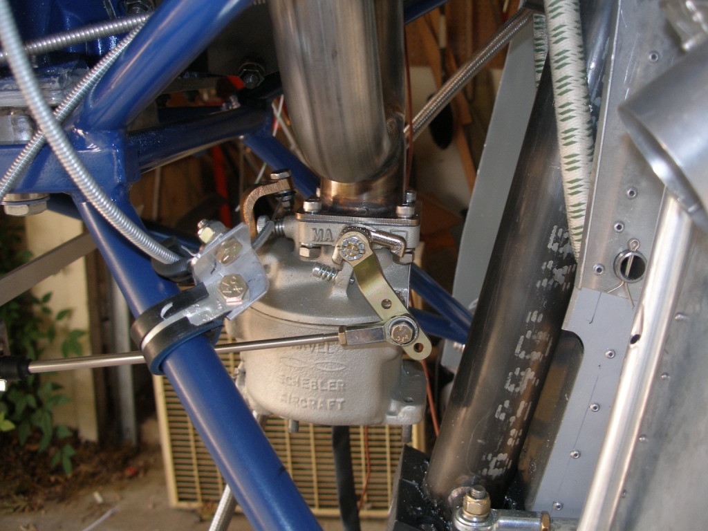

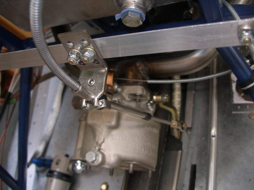

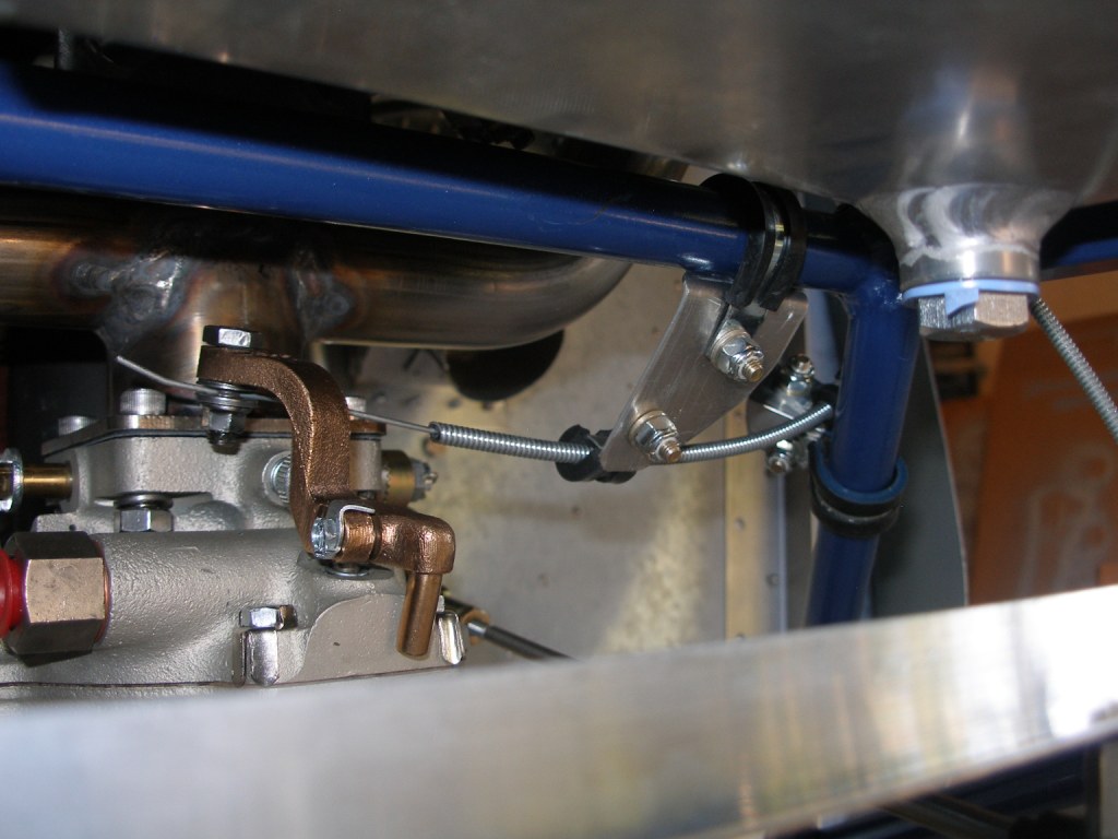

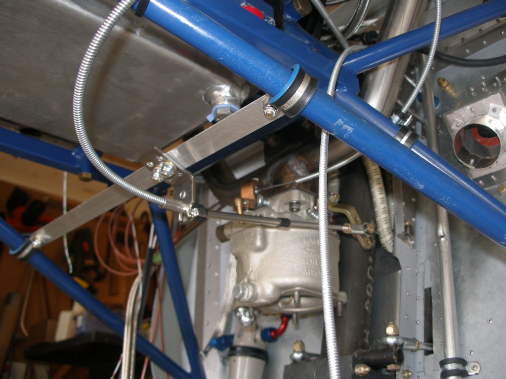

Carroll,
I ran the throttle cable forward past the carb, then looped it back to the throttle lever. That way, there is no "reversal" required. I can send a drawing and photos if you want.

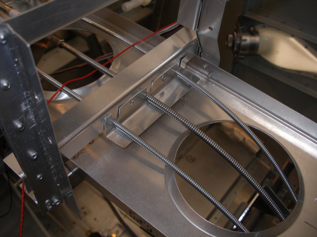

Gig Giacona
Posts: 1416
PostPosted: Fri Jul 24, 2009 10:58 am    Post subject: Re: Throttle Problem Reply with quote
Carroll,
I just realized that I haven't taken any pictures of my install. Attached are the photos of Jay's that he sent me when I was doing it. I'm sure Jay won't mind.

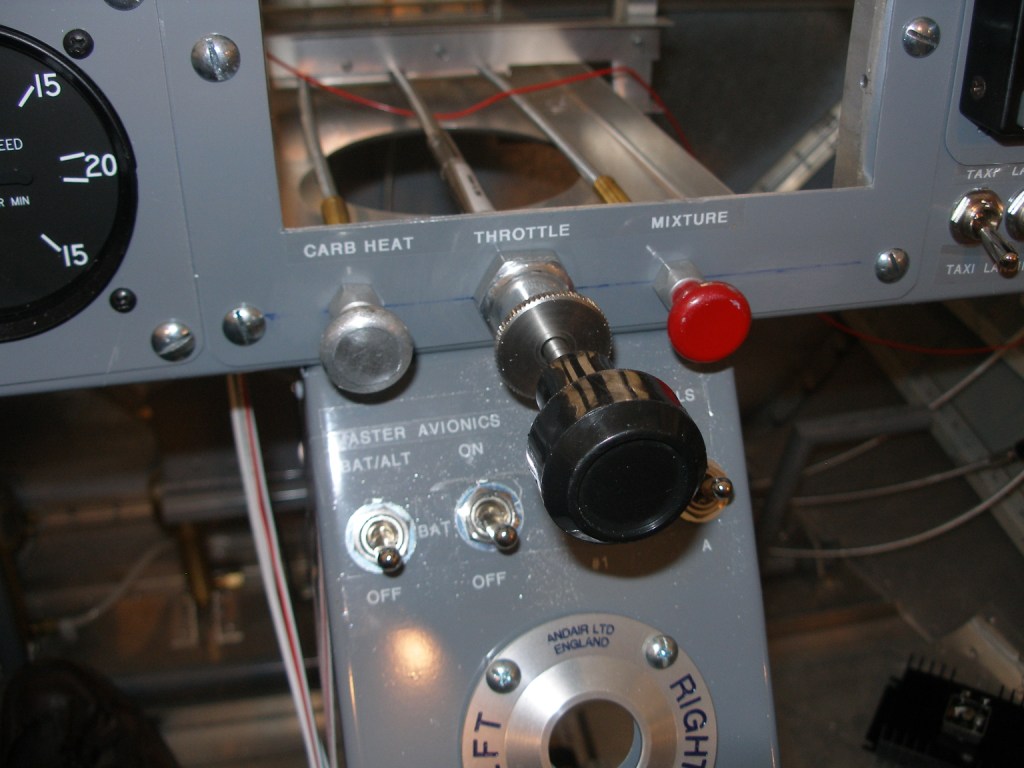

PostPosted: Fri Jul 24, 2009 11:43 am    Post subject: Throttle Problem Reply with quote
The first photo is actually of the mixture control connection. I have a few more to add.
Jay
