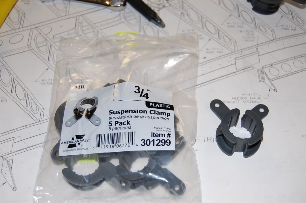

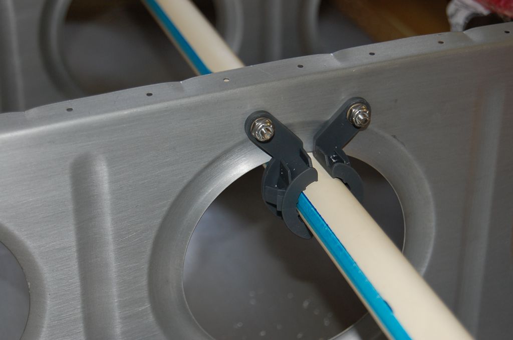

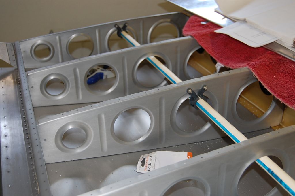

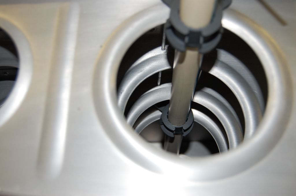

Thanks John, I got all of the stuff from Home Depot yesterday and kept the package in case someone else needed to know the part numbers. (the help there did not know they had them and I had to hunt them up myself) They come in 1/2 inch and 3/4 inch for 1/2 and 3/4 PVC pipe. I used the more expensive type of 3/4 pipe because airplane stuff is supposed to be more expensive,... right ? Anyway, the cheap PVC stuff was .89 for a 10 foot piece and the expense stuff was 4.95 so naturally I bought the high dollar stuff. The clamps were 2.95 for a package of 5. (See picture 295 for part numbers)
30 minute job,... done deal.

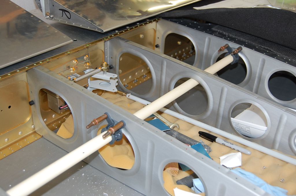

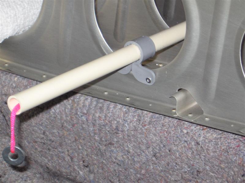

Now that's pretty neat! Between the Vans Diagram on an earlier post and this, I think I can get it done without any holes. Really like the joist hanger idea, never saw that before and it's a lot easier than adel clamps.
Thanks a bunch, as usual, the list is just an amazing source of almost instant information.
Thanks Bill S

This is what I did: CPVC? (lighter than regular PVC) and joist hangers from Big R Ranch Supply.
John Morgensen
