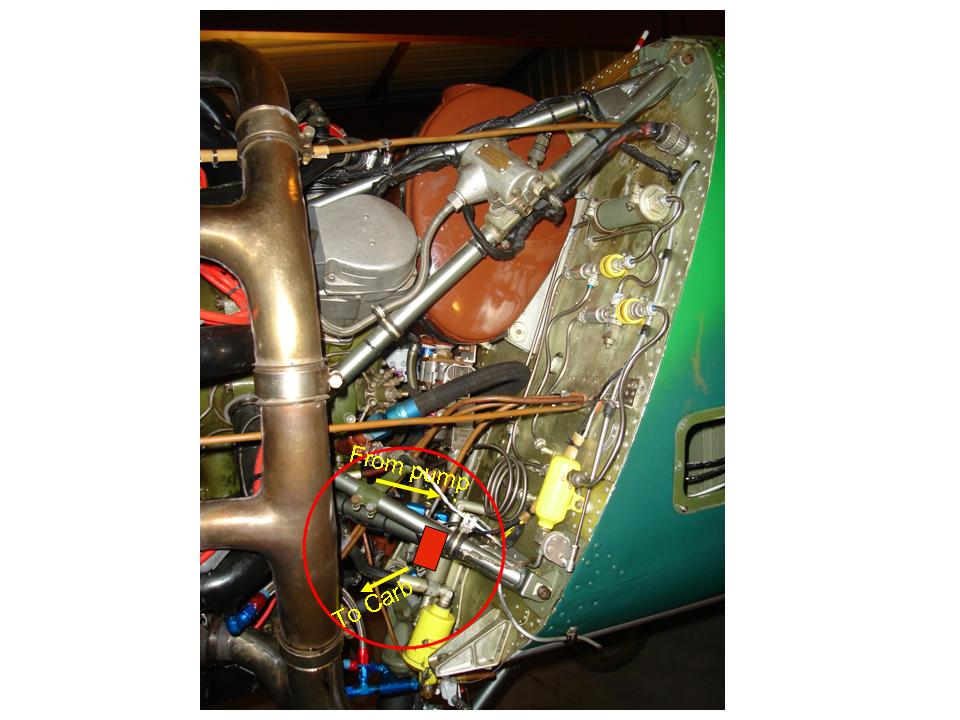

threein60(at)yahoo.com
PostPosted: Wed Jul 29, 2009 1:13 pm    Post subject: mounting fuel flow transducer in a CJ Reply with quote
Here is a bad picture of mine.. But you get the idea. I have just shy of 6 inches. I have a EI fuel computer with the Gold transducer. The newer transducers are not as touchy as the old ones. You just want to limit the number of bends and turns. I have a 90 degree going in and 45 degree on the exit of the transducer.
Larry Pine

keithmckinley
Joined: 11 Aug 2008
Posts: 434
PostPosted: Wed Jul 29, 2009 2:17 pm    Post subject: Re: mounting fuel flow transducer in a CJ Reply with quote
you're right...it's tough to see. Thanks for sending the picture.
You've got a really clean, nice looking CJ!
~K
