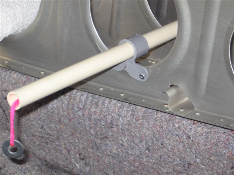

This is what I did: CPVC? (lighter than regular PVC) and joist hangers from Big R Ranch Supply.
John Morgensen
[img]cid:part1.09000809.09090601(at)morgensen.com[/img]
