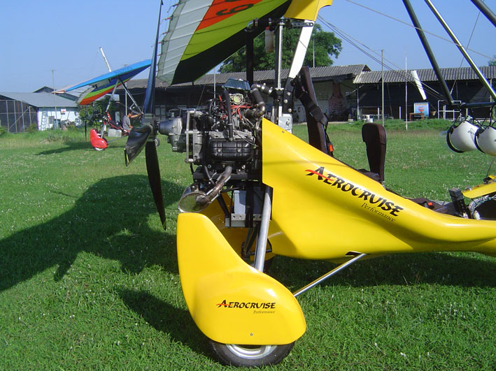

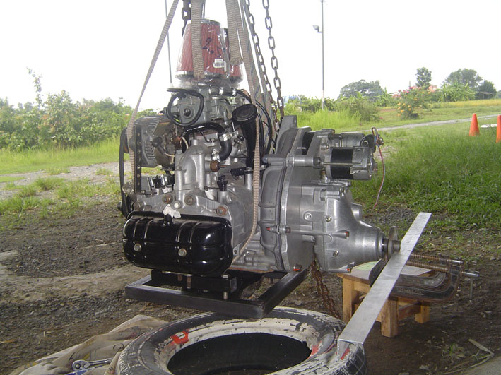

A while back I offered a new Rotax B gearbox with a 2.00 to 1 ratio up for sale and had no takers here on the list, but it did sell quickly to a fellow in Thailand through eBay. Yesterday Prayote sent me a few pictures of the installation. Thought it might be of interest. The engine is a Subaru EA71.

Very interesting !!!
I did not know a B box would take that kind of horsepower, I wonder if it will last ?? I think I would have used a C box on an engine that big. Adapting a Rotax gear box to an existing engine sounds like a great idea though. I would like to see an inexpensive and reliable alternative to the 912-S developed... But I'm not holding my breath, people have been trying to do that for many years now with very little success.

PostPosted: Tue Jul 28, 2009 9:21 am    Post subject: Re: Yet another engine option Reply with quote
Mike
The real issue with the B box is supporting whatever shaft the small drive gear is fitted to - unlike the C box, there's no separate bearing for the drive shaft to take the side loads. On the rotax motor the PTO crank bearings perform this job, partly why the provision 8 motors are so hugely beefy at the PTO end.....
I'd imagine the builder came up with a seperate bearing for this?
Also, any info on the weight? Looks like it weights a ton just looking at the photo, but then looks can be deceiving...

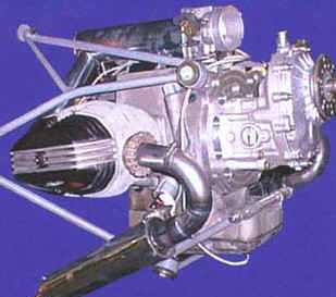

I have always liked the looks of the BMW engine conversion. I have seen this on a Trike. my friend flys it, and it is smooth, powerful, with fuel injection and seems to work very well and trouble free.
http://www.ultralightnews.com/engineinfo/bmwconversion.htm

Mike, what is the displacement of that engine?

herbgh(at)nctc.com
PostPosted: Tue Jul 28, 2009 2:49 pm    Post subject: Yet another engine option Reply with quote
Another Mike...has a BMW engine on his MkIII... He made an adapter
plate and used a c or e box as I recall.. Last I looked, it is for
sale on Barnstormers...Herb
