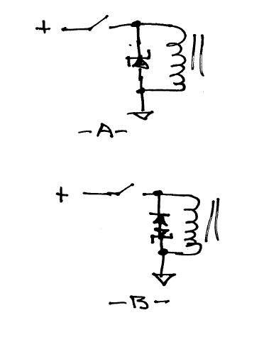

Do I correctly deduce from your posting that your
contactor coils are protected by a single transorb?
If so, then it has to be wired as shown in -A- below.
[img]cid:.0[/img]
In this configuration, the device HAS to be biased in
the zener conduction mode polarity while coiled power
IS APPLIED. When the switch opens, the top of the coil
swings negative . . . and the transorb is now biased
in the diode conduction mode. This configuration doesn't
take advantage of the transorb's voltage limiting function
as a specialized zener. In other words, your transorb
functionality in the coil release mode is the same as
for the simple diodes described in:
http://www.aeroelectric.com/articles/spikecatcher.pdf
The proper application of uni-polar transorbs or zeners
for SPIKE mitigation is to place them in series with
a plain vanilla rectifier as shown in -B-. In this
case, power that energizes the coil is blocked by the
diode, but the strong negative swing at switch opening
time is carried through the diode to the transorb that
conducts like a ZENER to limit the excursion to more
attractive levels (and allows the contactor to release
faster). See:
If the contactor release time (15mS versus 60 mS)
is critical the use of transorbs as shown in -B- is
indicated . . . -OR- you can use a single, bi-directional
device to keep the wiring complexity down and eliminate
device polarity concerns.
If your transorbs are implemented as in -A- then
they've offered no more functionality than the simple
rectifier diode would offer. If contactor release time
is critical, then changing to -B- or changing to
bi-directional devices is called for. See:
http://www.aeroelectric.com/Pictures/Curves/Cole-Hersee_with_Diode.gif
http://www.aeroelectric.com/Pictures/Curves/Cole-Hersee_without_Diode.gif
http://www.aeroelectric.com/Pictures/Curves/CH_w_2x18v_Transorbs.gif
http://www.aeroelectric.com/Pictures/Curves/CH_w_120_Ohm.gif
http://www.aeroelectric.com/Pictures/Curves/CH_w_1n5400.gif

Failures of the plain-vanilla diode are unknown to
me. They're simply never electrically stressed in
a manner that puts them at risk for failure. Similarly,
Transorbs wired as shown in -B- cannot be impressed with
system transients because they're isolated by the
series diode.
I'll suggest that there's more to your failure
experience than what you've related in your posting.
