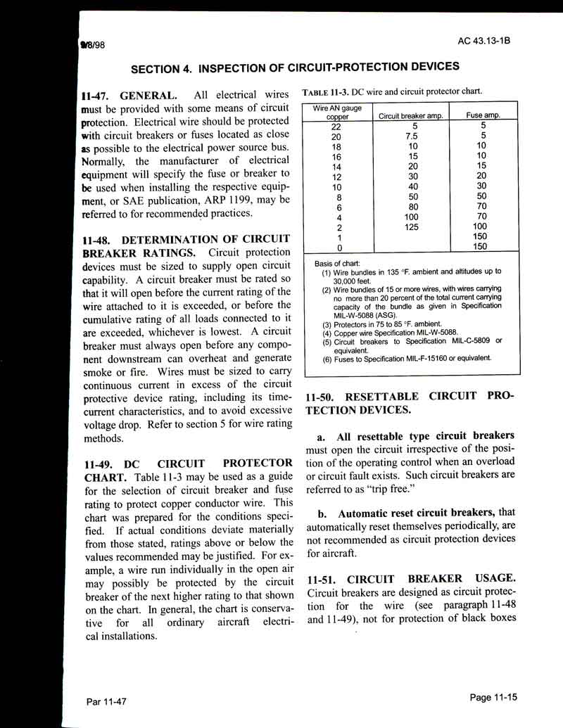

For the 12v/24v DC circuits typically used in our aircraft, is there
any difference in the rating one would select if using a fuse versus a
circuit breaker? In other words, a hypothetical example, if one arrived
at a value of 15 amps to protect a wire, would a 15 amp fuse be
interchangeable with a 15 amp circuit breaker for protecting the wire?
I ask for two reasons - in a discussion on another mailing list,
someone has said that fuses and circuit breakers of the same rated value
are not interchangeable, and AC43.13-1B table 11-3 on page 11-15 in
Section 4 shows a 15 amp CB or a 10 amp fuse to protect a 16 gauge
copper wire (picture attached).
If there is a difference, do you know and can you explain in simple
terms why?
-Dj

For our purposes, breakers and fuses are size-for-size interchangeable.
