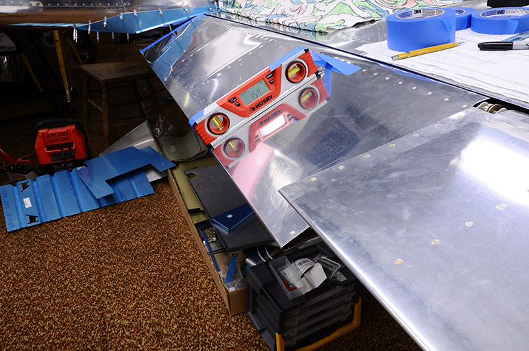

Hi Matt,
You can use a level like a Smart Level or a mechanical one (like Starrett
"Exact Angle Meter") with angle calibrations. Do the arithmetic between
neutral, full up and full down indications. Apply the same procedure with
the elevator.
Richard Dudley

PostPosted: Fri Jul 17, 2009 9:39 am    Post subject: How To Accurately Measure Aileron Throws... Reply with quote
I just went thru this.  You measure it relative to the chord line of the air foil.  That is pretty well approximated by the tooling holes in the wing end ribs and the aileron end rib.  Stretch a string from the forward tooling hole back. The aileron position at which they all line up (as best as you can get it) is the 0 deg. deflection position. I used an electronic level.  It does seem like a large angle, but I figure if that's what they specify, that's what I'll make it do.

The math to convert the angles to inches travel at the trailing edge
is not difficult. Measure the distance from the pivot to the trailing
edge. The linear travel is:
2 * distance from pivot to trailing edge * sin(travel angle / 2)
But, an electronic level is the way to go. Much easier.

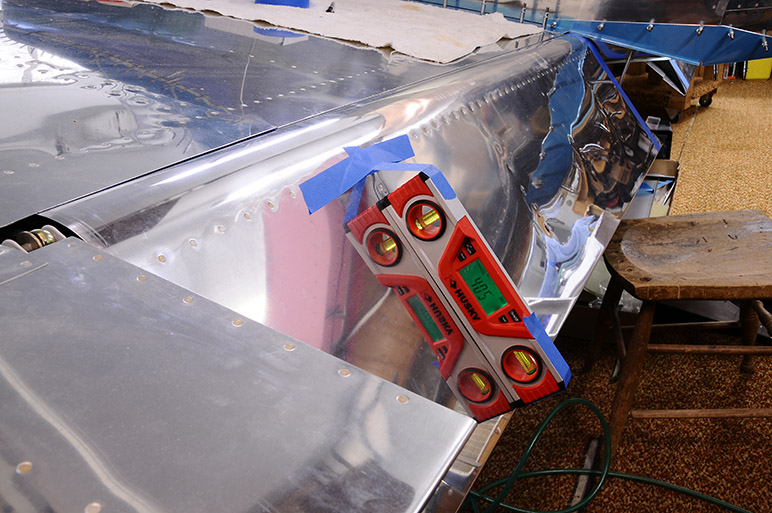

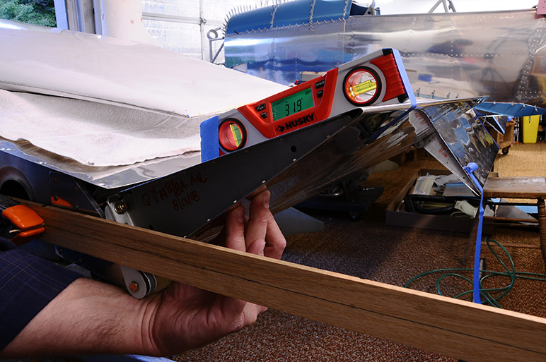

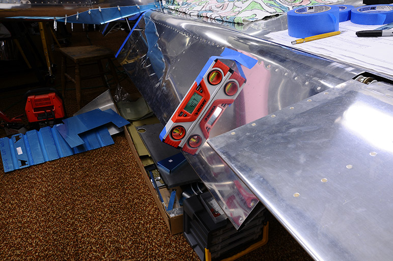

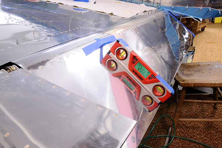

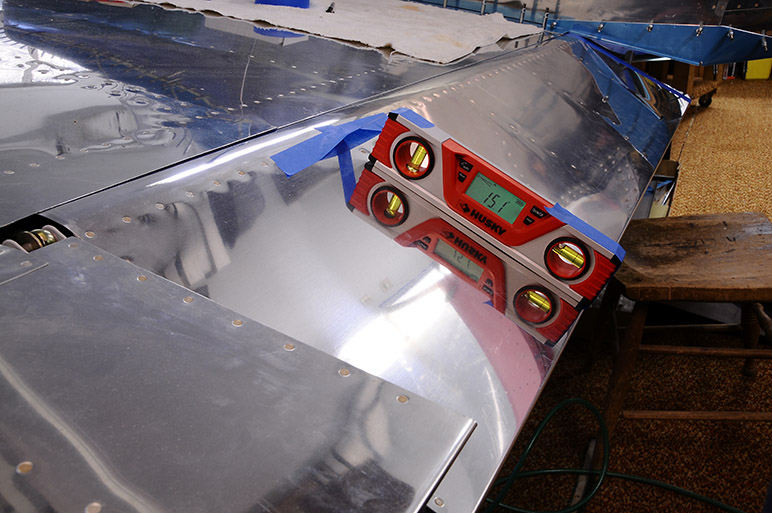

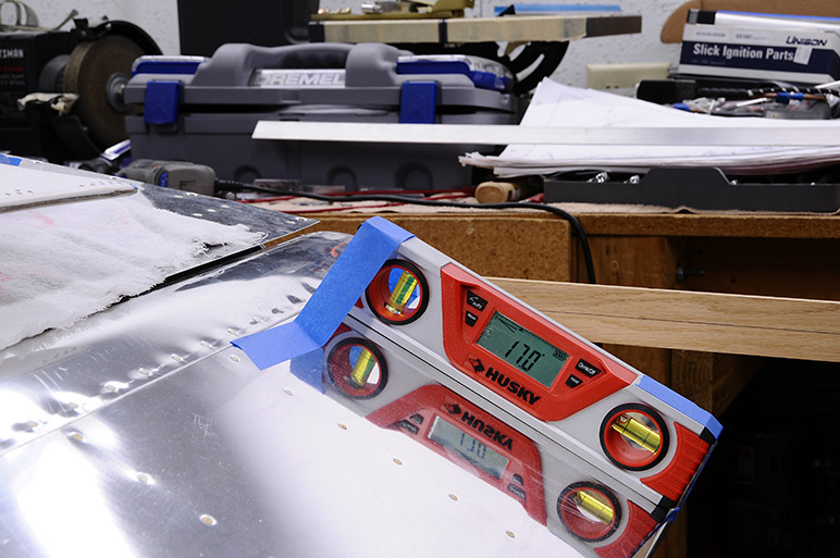

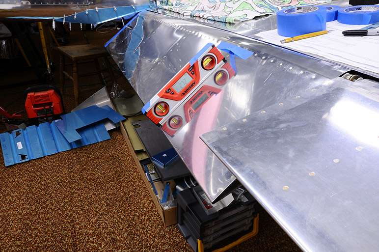

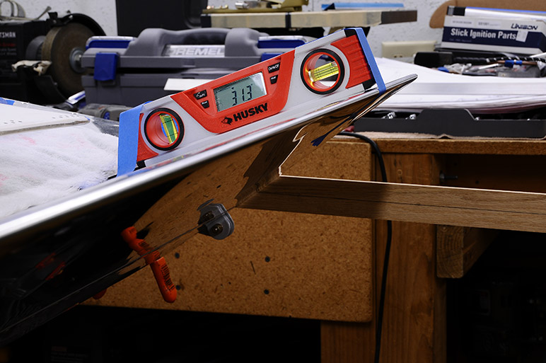

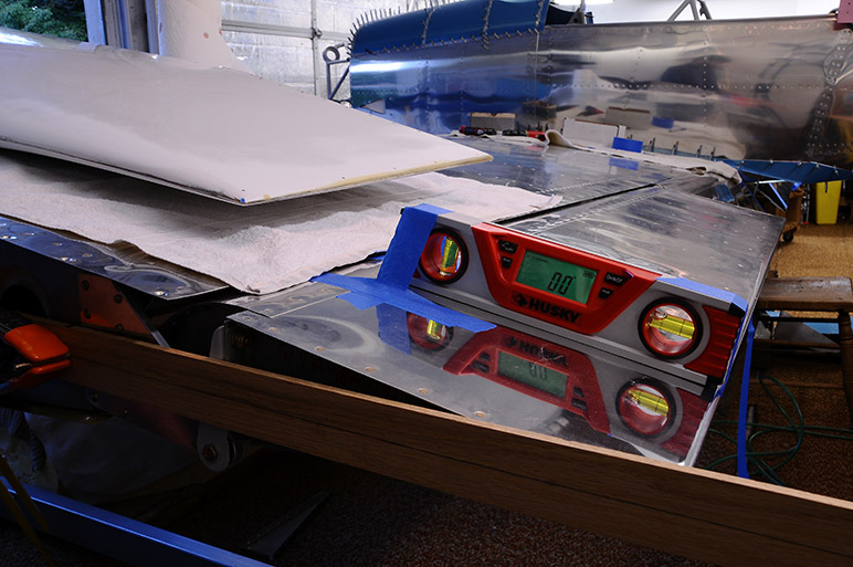

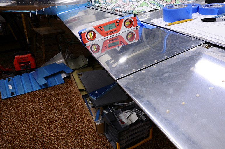

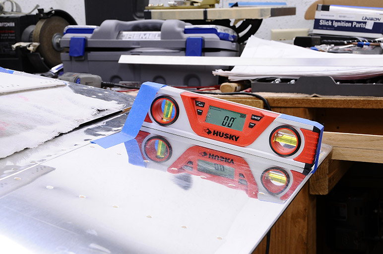

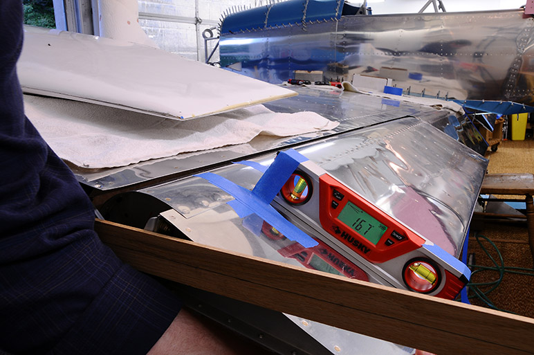

Once again, you guys really came though for me! I can't believe I didn't think about using my digital level!! Duh! As you can see from the attached pictures, taping the level right to the aileron and flap works great! The level has a "zeroing" function which worked out perfect so that I didn't have to do any math in my head (ouch). I've attached some pictures for future archive reference.
I haven't made the little aileron control stops yet. I assume that since everything seems to be rigged pretty close to perfect I can just place them such that at my current 32 degrees of Up will hit the stop? Maybe just a hair shy something like 31.5 or something?
Thanks again,
Matt Dralle
RV-8 #82880 N998RV
Wing To Fuselage Fairings...

Yes, 40.7 on the right, and 40.5 degrees max on the left. The chart says "40-45 degrees" so I'm right in there.
