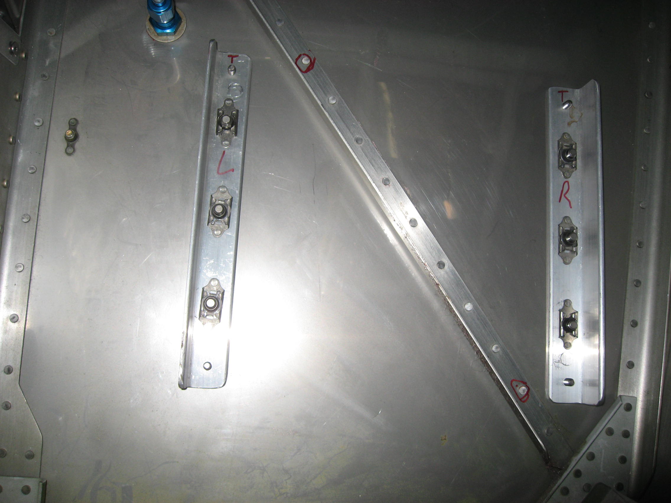

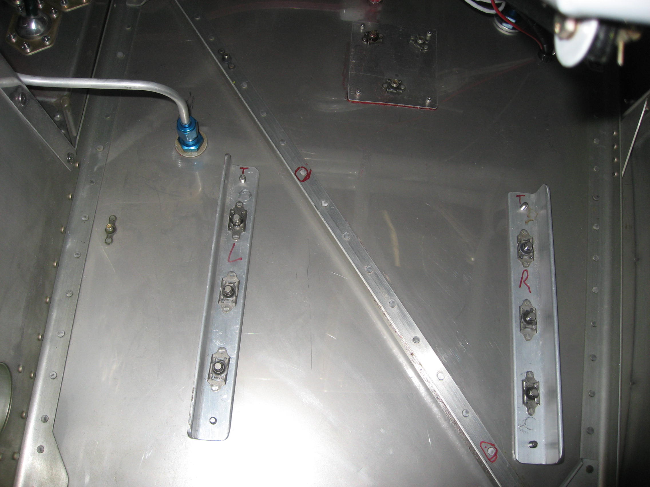

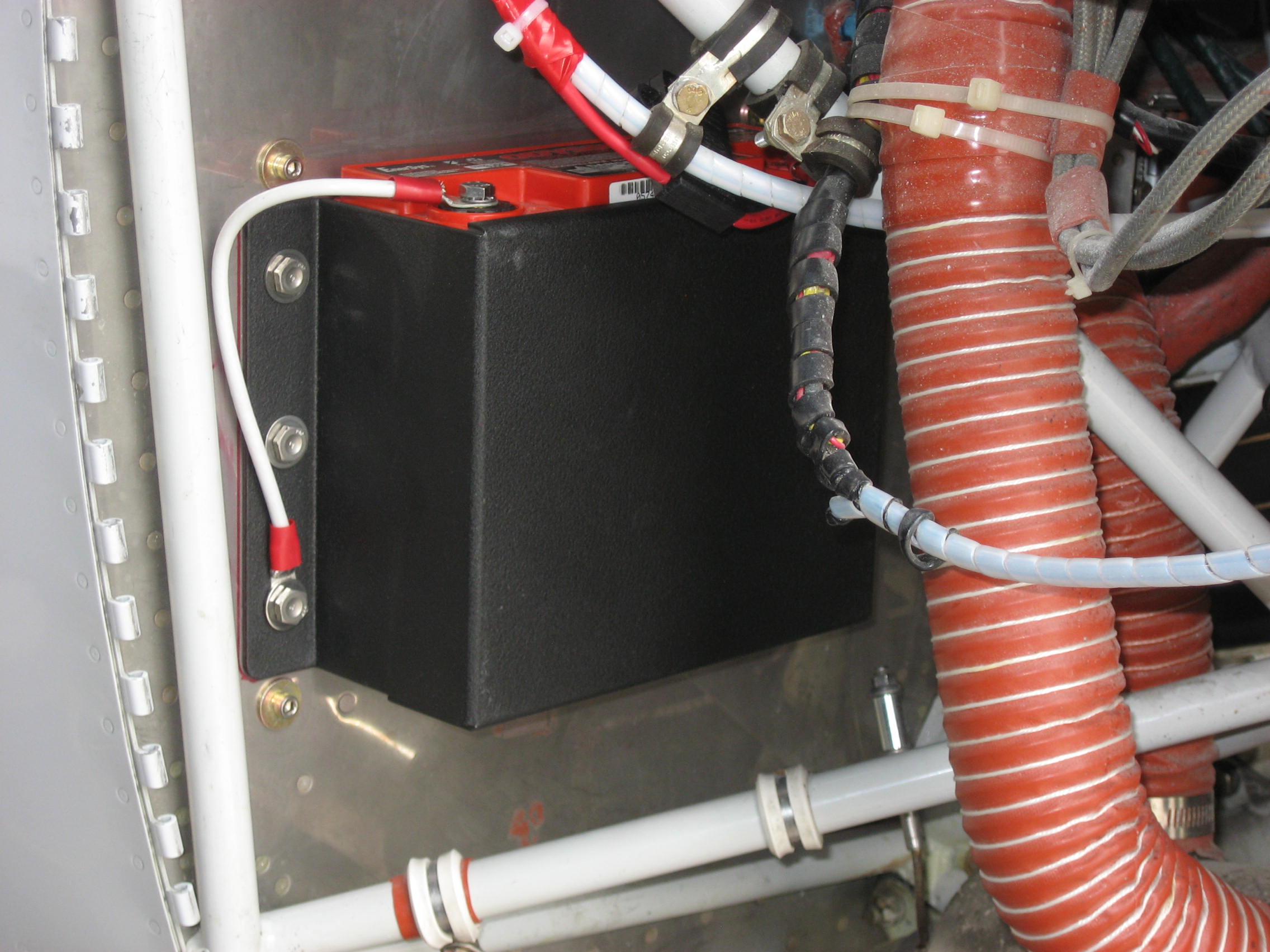

Is that the stock battery box that Van's sells for the RV-7?
John
dlm46007(at)cox.net
PostPosted: Sun Jul 19, 2009 8:12 am    Post subject: Extra battery Reply with quote
I think so but I got mine from Aircraft Spruce. I used .125 6061T6 1" angle
for the back side. Tapped it a couple of places to hold in place and set (3)
#4 nutplates for clamping the battery box.
