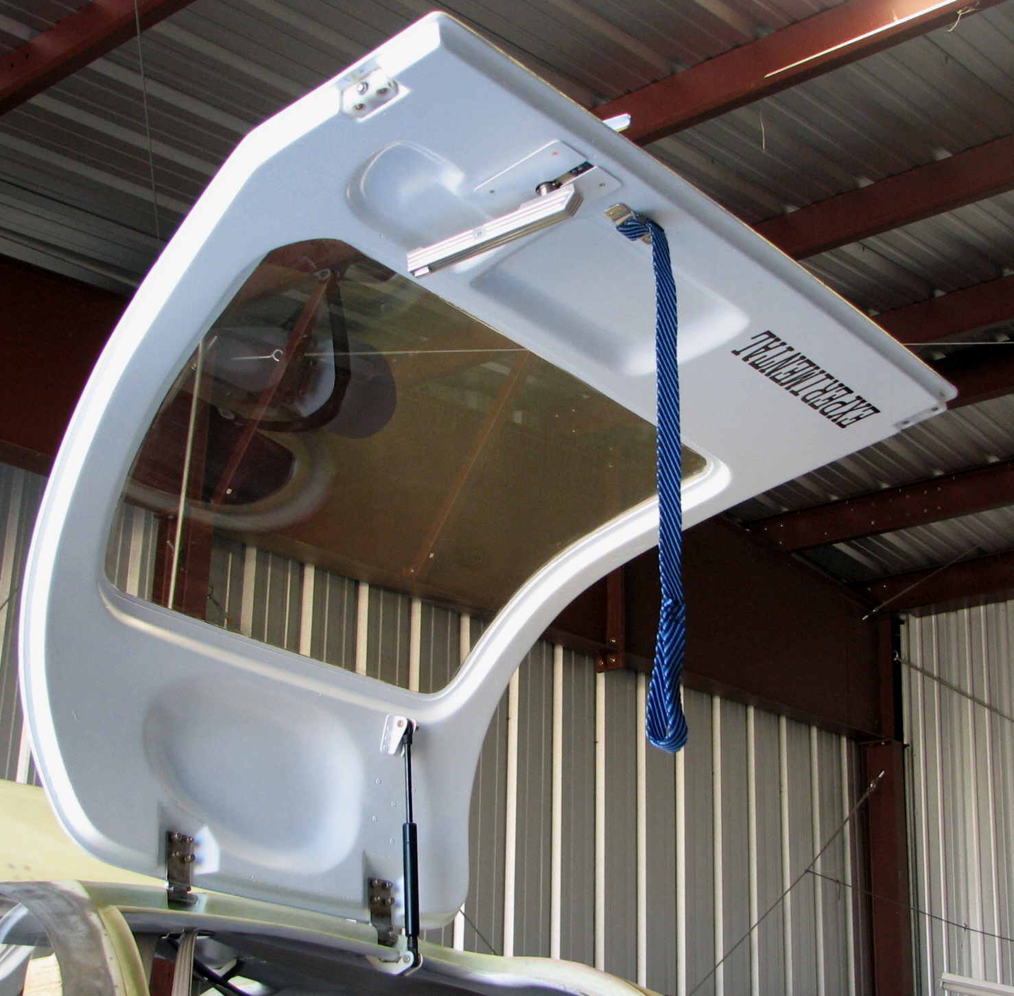

I'm considering a leather strap to pull the door closed... appx 1'
long running along the lower inside edge of the door. The ideal
location for this strap would be both reachable and result in the door
pulling in evenly (fore and aft) when held in the center. It seems to
me that that could be one of two locations... centered in the length
of the door or centered on a line drawn down between the two hinge
points. Does anyone flying have a feel for where that might be?

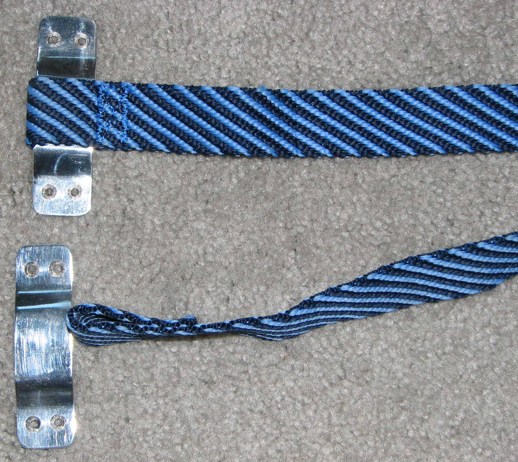

I looked quite a few places and finally found these at an $8.98 store in Roseville Ca. They were perfect, and only $1.98. I cut them to length, and then had them sew up. They work perfect.... so nice to be able to just reach up and close the door.
Don McDonald
#40636 - 55 hours FLYING
