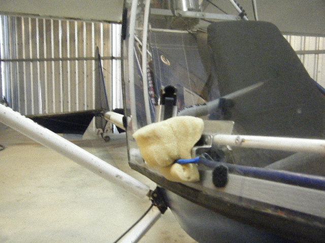

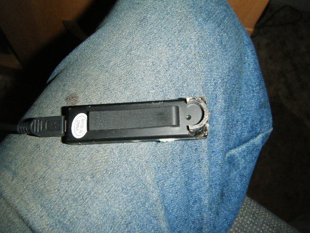

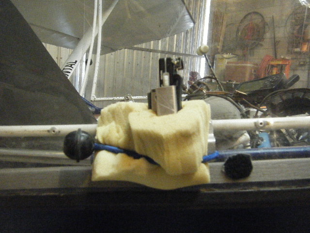

I added a sun screen to the little camera since glare really screws thing up.
[img]cid:48B2397B915A49A499F3A44291F00B90(at)larryPC[/img]
Then I mounted it to my door using a piece of foam and a small bungee cord.
[img]cid:10C15CA16A054EDA828502A7FDA8C4E8(at)larryPC[/img]
I got it pointing a bit too much to the left, but it is loads better than what I had yesterday. There is still a bit of wave to it, but much improved.

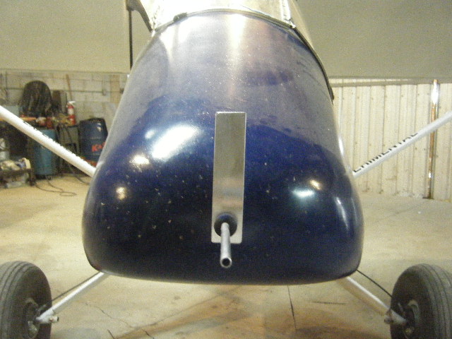

I didn't like the rather unsecure position of the camera bungeed to the door. I did like being able to reach out and turn it on or off, but what the heck, I generally don't fly more than 1.5 hours at a time anyway. Besides then I can show the whole trip to the wife, if she is interested.
So I made an aluminum tab to go behind my Pito tube. I have one of those that has a nut to tighten it to the plane. I then took some dense foam and cut a pocket in it to hold the camera, and went flying. Well it was better, but it was a bit wavy, so I made a new one of 1/8th alum bar and put that one on.
[img]cid:A64968EB11D8498586D69E2F3D251F19(at)larryPC[/img]

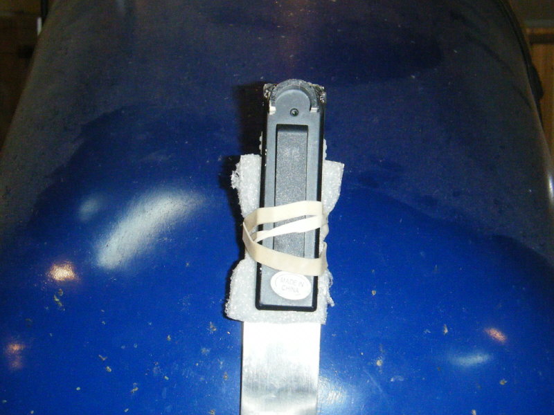

Then out the camera on a thin strip of foam and secured it with a rubber band. That made me a bit nervous so I put a piece of tape as a security feature. It is well that I did. When I got back I found that the rubber band had broken.
[img]cid:DB54E8F1A70247ECA0475878C8B8B7D8(at)larryPC[/img]
The vibration that is such a problem every where else is non existent at this point, and the camera view is much better. One bug scoring a direct hit will wipe every thing out however. Smile
