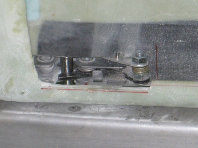

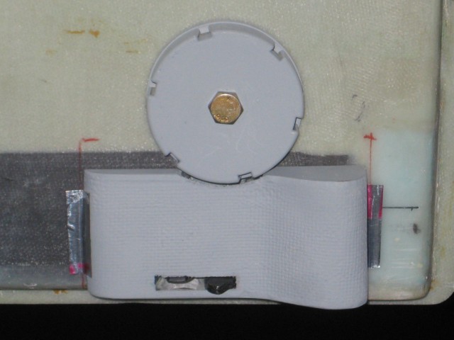

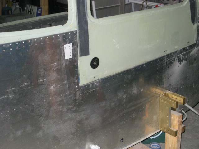

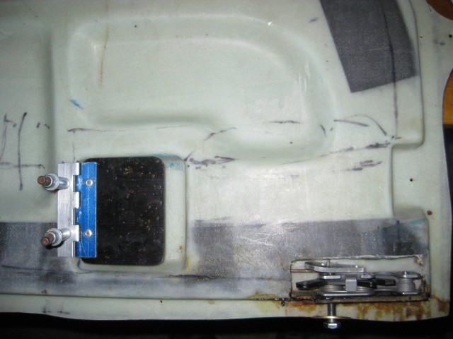

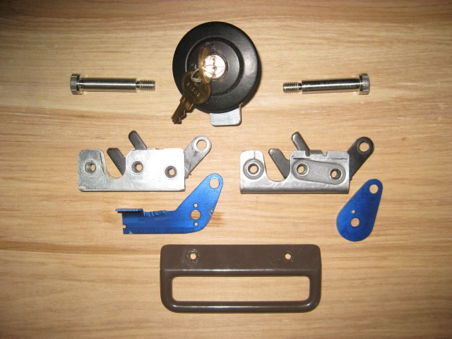

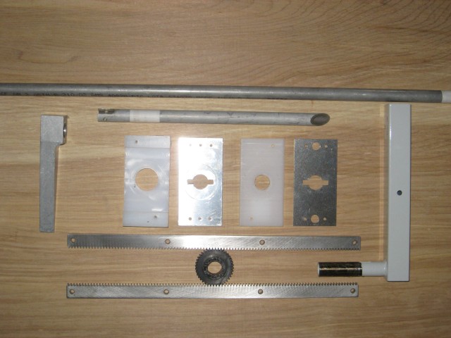

I didn't like Vans door latch system and it's associated problems .....
such as the handle hanging out in the breeze, separate lock if you can
figure out how, and that asthetically pleasing piece of square tube on
the inside ...... so I modified my doors. The attached pictures are
pretty much what I'll end up with. The mod will cost less than $200. I
figure the mod will take less time than the Vans installation, and won't
require many tools you don't already have, but since I haven't done it
Van's way .....
I see no reason why the mod can't be done on a completed airplane.
If you're interested in my installation, or have questions, send me an
email off-list. I might make up a parts kit ..... but this isn't going
to become a business!
Linn Walters

These are latches like the ones they use on Camper shells for pickup trucks.
They are over center locks, but in my opinion not a strong or secure as vans
system. Also looks like at least a two hands /two operation to open.

I'd hate to try and open the door without releasing the latches.
The latches are connected together by a rod inside the door, and to the
inside handle. One finger pressing on the outside or pulling on the
inside will open the latches.
