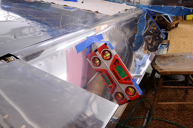

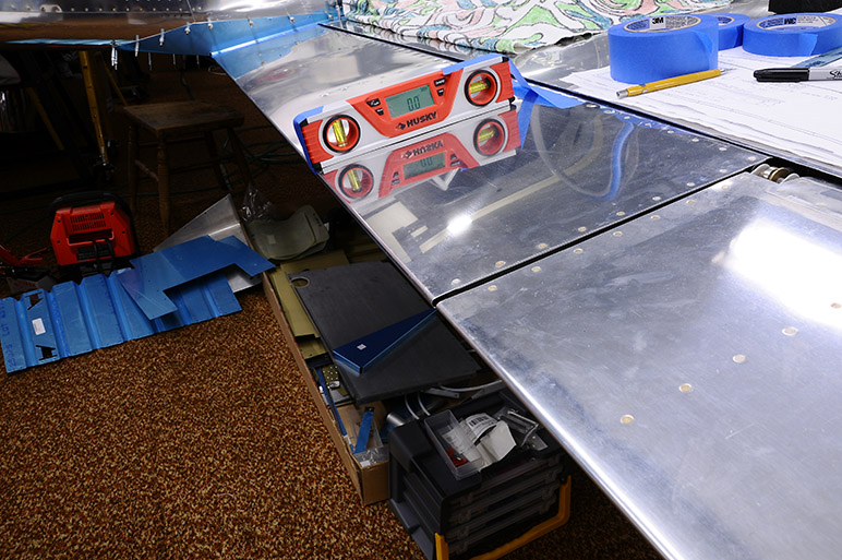

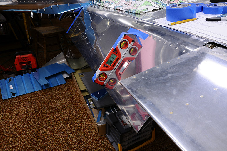

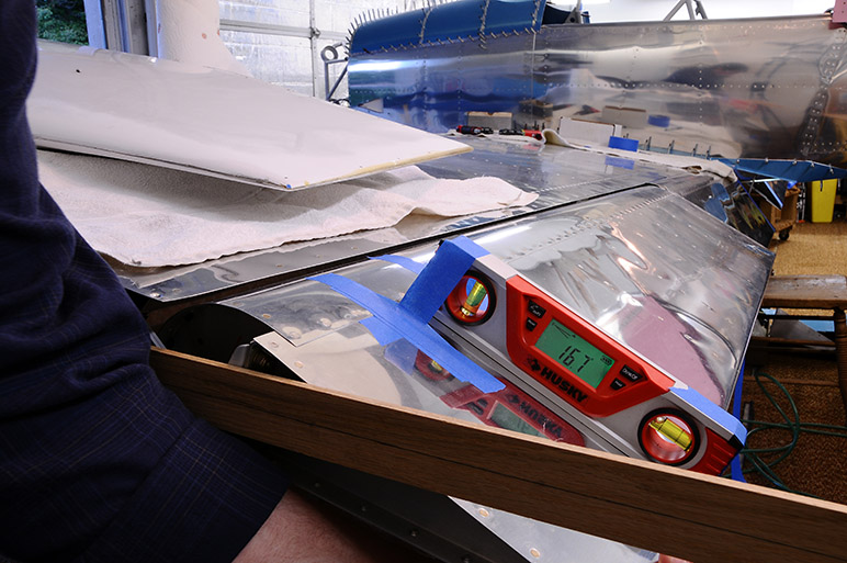

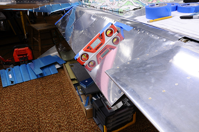

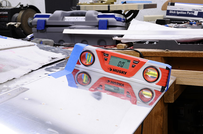

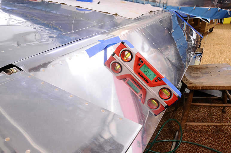

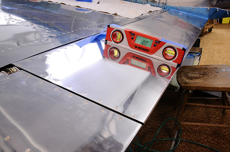

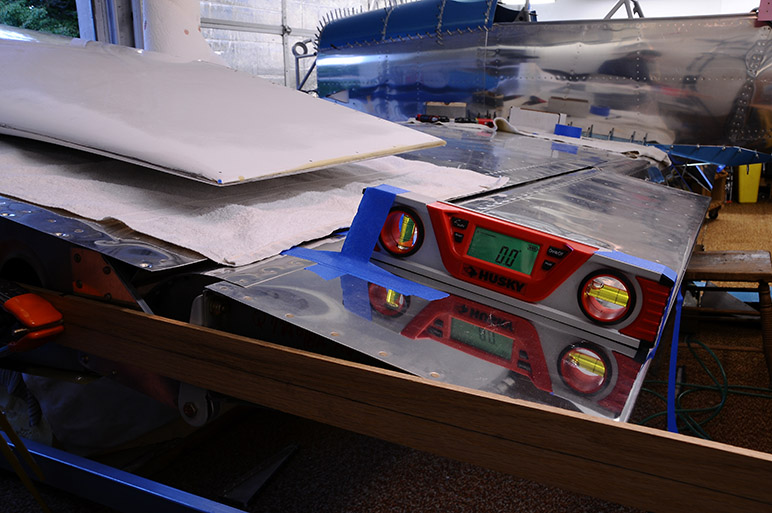

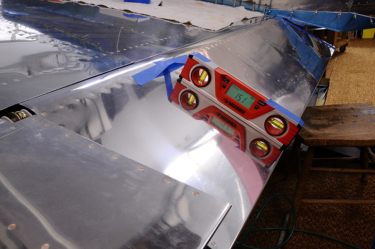

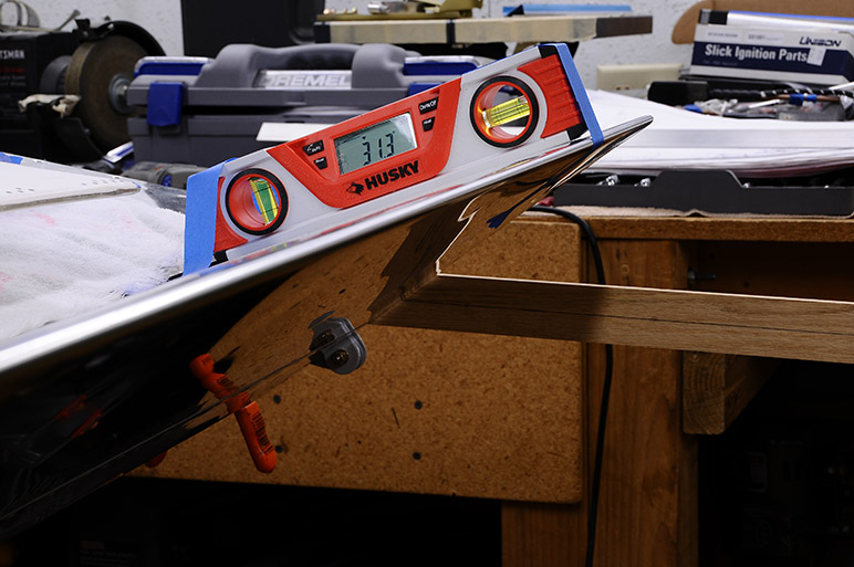

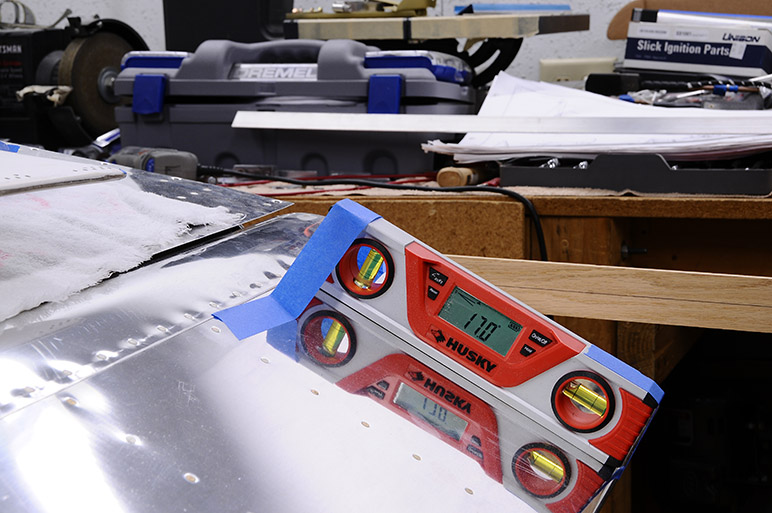

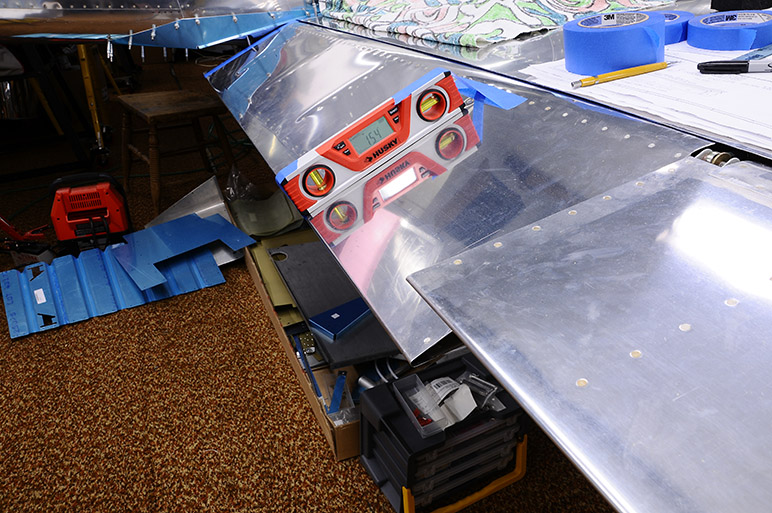

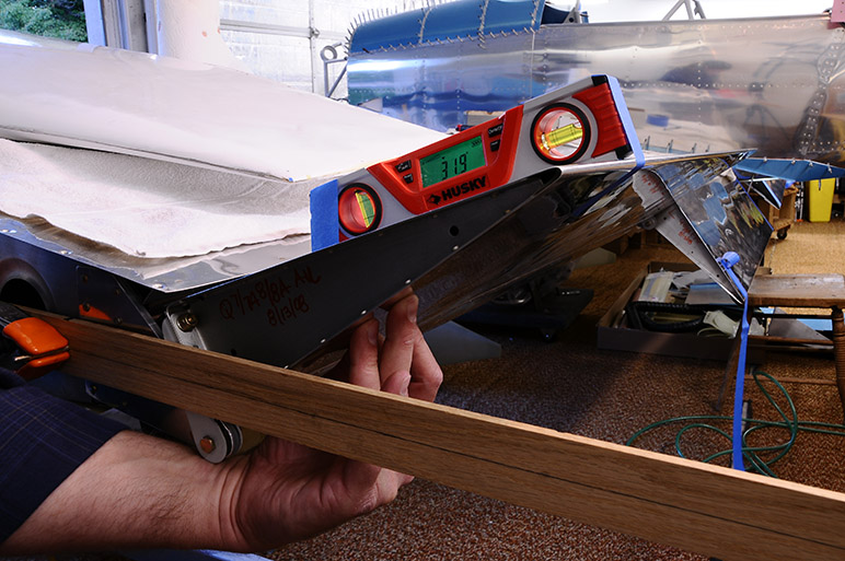

Once again, you guys really came though for me! I can't believe I didn't think about using my digital level!! Duh! As you can see from the attached pictures, taping the level right to the aileron and flap works great! The level has a "zeroing" function which worked out perfect so that I didn't have to do any math in my head (ouch). I've attached some pictures for future archive reference.
I haven't made the little aileron control stops yet. I assume that since everything seems to be rigged pretty close to perfect I can just place them such that at my current 32 degrees of Up will hit the stop? Maybe just a hair shy something like 31.5 or something?
