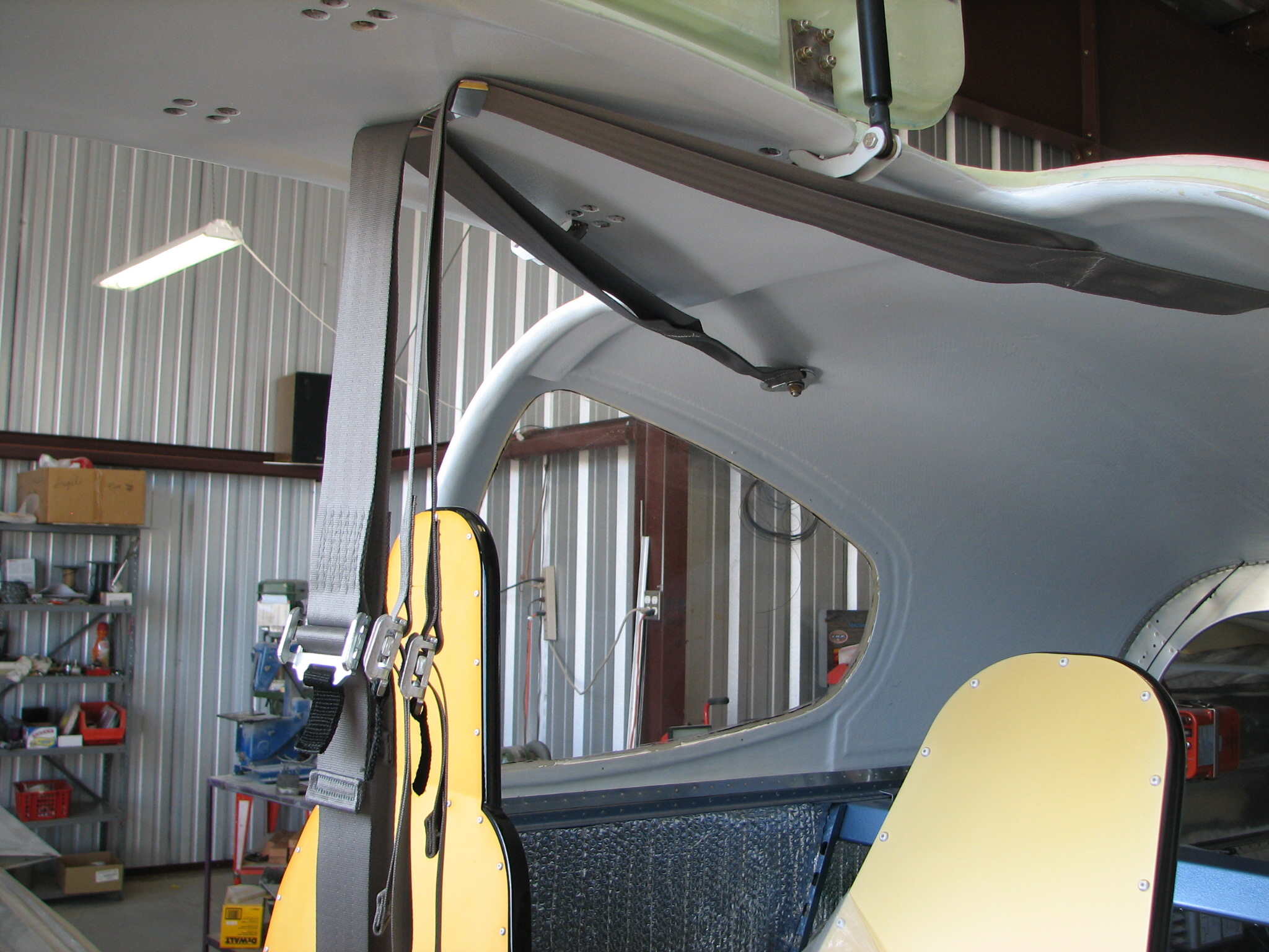

PostPosted: Thu Jul 09, 2009 4:24 pm    Post subject: Hanger for shoulder belts? Reply with quote
This shot of my install should give you a pretty good idea. They work great. Almost anywhere close is fine... just a pain to have to reach into the back seat to retieve.

PostPosted: Sat Jul 11, 2009 2:21 am    Post subject: Hanger for shoulder belts? Reply with quote
Great headliner! ( i know we are talking about seat belts) Where did the headliner come from? Thanks

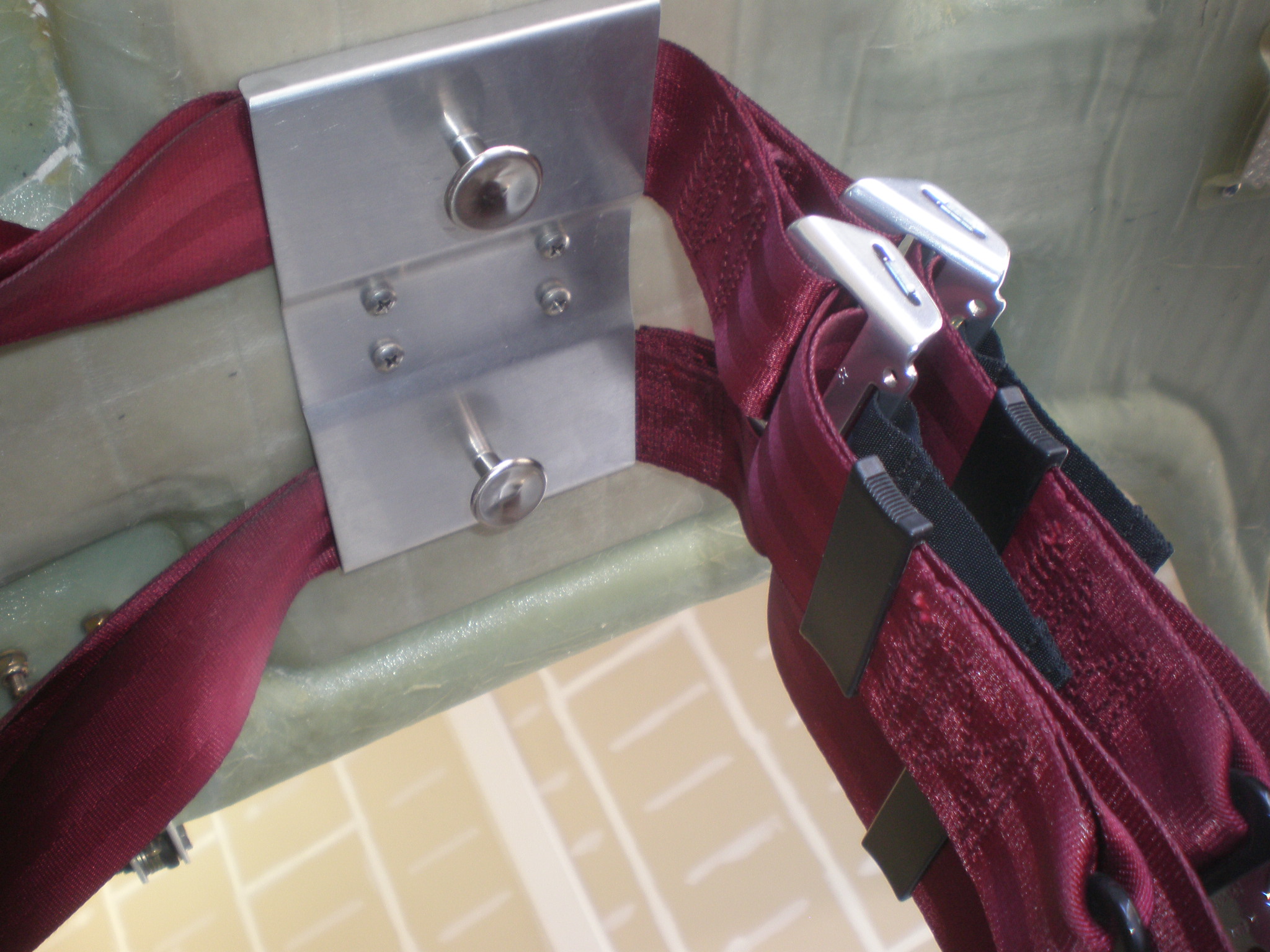

Dave McNeil made a very cool seat belt holder from one piece of aluminum. It is fairly heavy guage aluminum. The idea of the handles is that you pull it away from the cabin top (1/4") to to release the tension that holds the "keeper" edges on the cabin top. That releases the belt. You slide it out and use it. Reverse the process upon landing. Very simple and elegant - all in one piece. Works great - looks great. I would go for a more rounded knob or lower profile, but the setup works great.
seatbelt retainer
 Filesize:  631.44 KB
 Viewed:  5653 Time(s)
See you OSH '18

PostPosted: Mon Jul 13, 2009 9:23 am    Post subject: Hanger for shoulder belts? Reply with quote
Still looking for the response to where did you get the headliner? I
believe the question goes to Don McDonald who posted the very nice picture
of the hanger location that prompted the question. Others are anxiously
waiting!!!
Rich

PostPosted: Mon Jul 13, 2009 8:22 pm    Post subject: Hanger for shoulder belts? Reply with quote
Yep, I made the hangers for both the shoulder harness and the headsets, but no headliner in my plane... at least not yet.
Don McDonald
