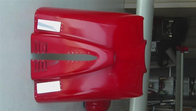

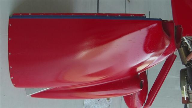

I think I have my high oil temps problem under control finally. I previously
had added a high capacity oil cooler on the right side but still was seeing
temps climbing too high now that summer is upon us. I added 2
non-retractable cowl flaps on the bottom. The rectangular opening in the
cowl is 4 x 9 inches. The opening at the rear is 2 x 4 inches. They are
non-retractable because the mufflers would interfere. This seems to be a
final fix. I'll try it tomorrow with daytime temps at 111. Good thing KNYL
is at 216'.
Albert Gardner
Yuma, AZ
N991RV

PostPosted: Tue Jul 14, 2009 3:09 pm    Post subject: High Oil temps Reply with quote
We did the same thing, but used 2 more of the Vans vents. Same
location as you did and got similar results.
