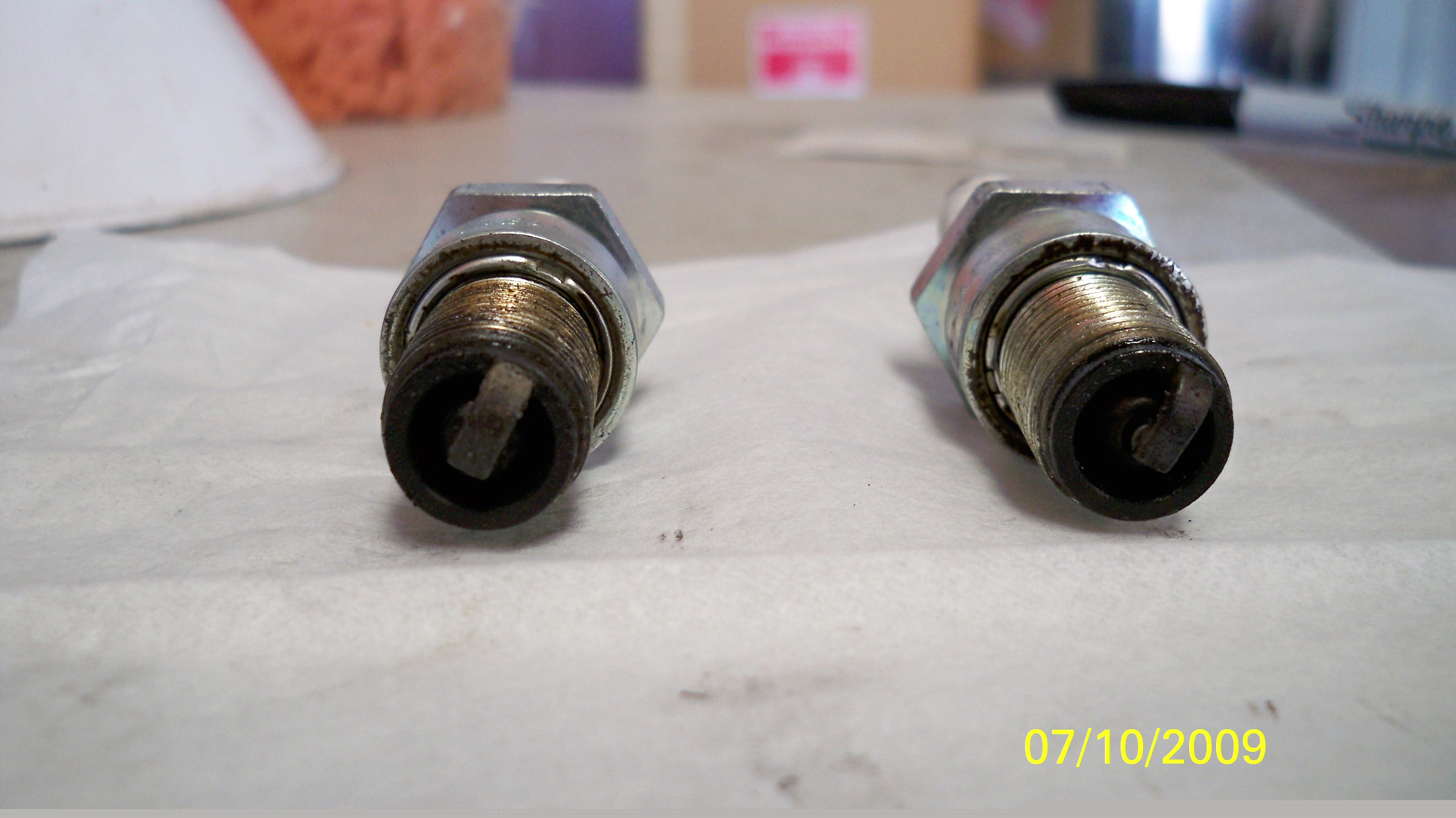

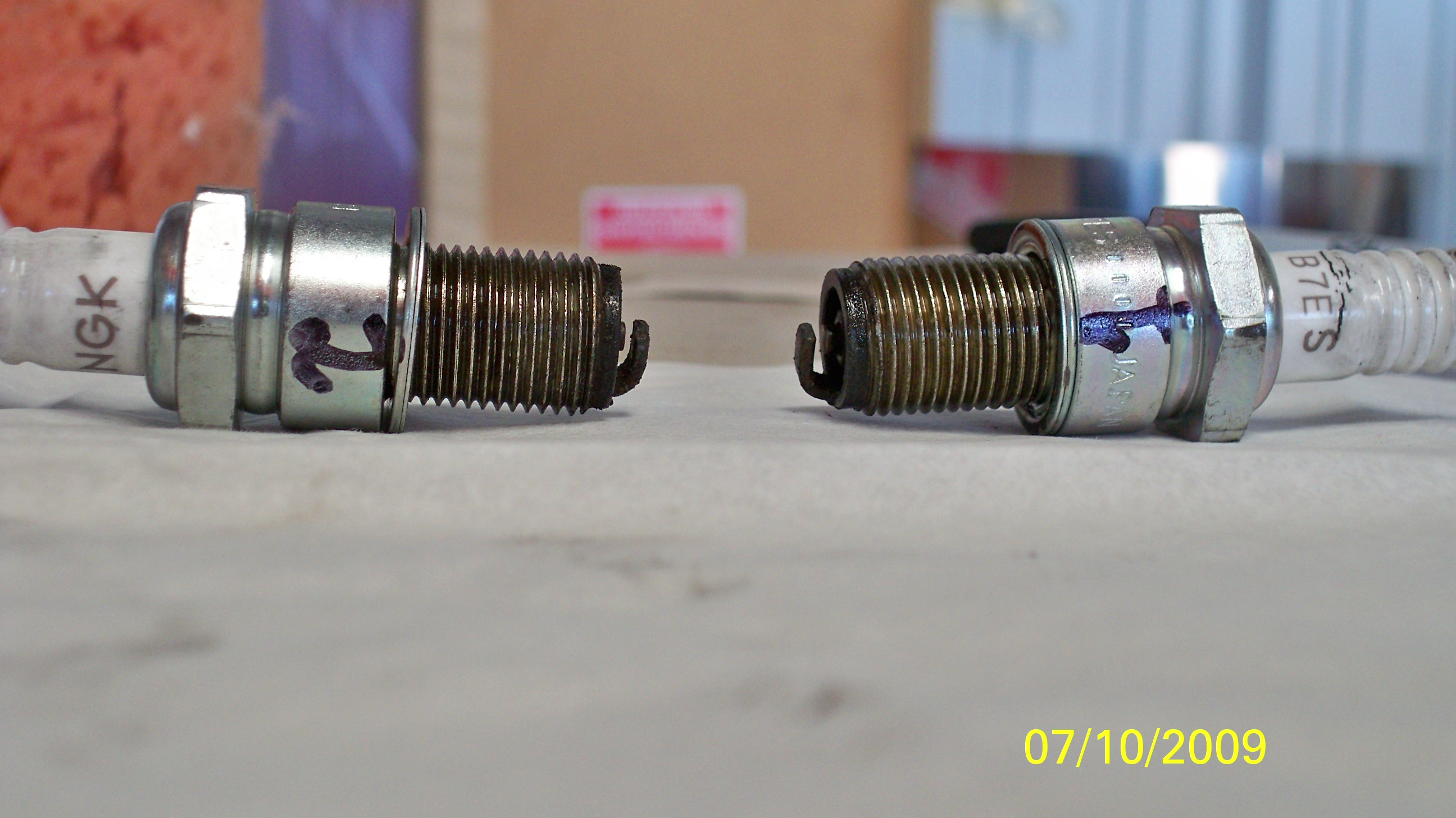

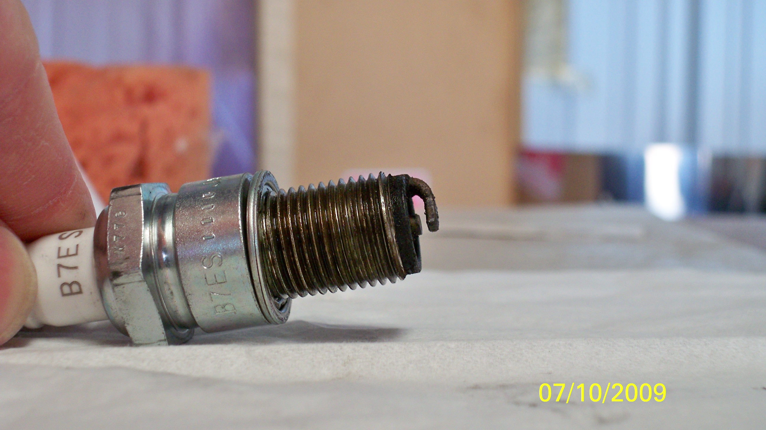

I am attaching a couple of pics of the plugs. They have some specs of carbon on them I think.
can experienced 2 cycle drivers tell me what they think.
I am not sure if its running too rich or too much oil, I am at about 38/1 on the oil mix because I calculated 124 fluid ounces per gallon as opposed to 128 oz per gallon. So I am a bit rich on the oil side, not by much though and I am using none synthetic as I had some bottles of it I want to use up. The motor is running fine, just finished a 1.5 hr mission without any negative events.=============

Ron- The first thing I noticed was the spark plug number. What engine do you have? I thought most of the two stroke Rotax engines used a B8 or B8ES.

Well it won't be running fine for too much longer with plugs like that......... They're practically fully oil-fouled........ This is a Rotax motor?
You already know you're running too much oil (because 50:1 is the required amount) and perhaps you're running to rich too.
As someone else said, the plugs are the wrong ones also, if you're running the Rotax you need to use the B8ES/BR8ES (I think the 7 is a colder plug).
Here's what I'd do _before flying again_:
- pull the exhaust manifold and check for stuck rings. Turn the crank until the rings are visible in the exhaust port. Rock the crank back and forth very slightly and check for play in the rings. They should move minutely in the grooves. If you don't see this, I'd take the motor out of service and do a teardown/decarb.
- if that checks out, new set of plugs.
- go to 50:1 on the oil.
- reset the jetting for your altitude and temp according to the rotax jetting chart (if you changed it from stock).
I wouldn't fly that engine again until you've done at least these steps....

What ever engine you are using, it is running much too rich. Richard Pike
has a very good explaination of how to read plugs on his web site at:
http://www.bcchapel.org/pages/0003/pg11.htm

It's the recommended heat range for the duty on the Cuyuna. It may be running rich a bit, I may play with the valve needle this weekend when the tower is closed here. I will also try the synthetic oil that I have to see how it looks. I know it kept my Yamaha clean from carbon. I have only one mission left and I sure don't want to screw around with that more than I minimally have to. Once I am done with this job for all I care they can recycle this lawn chair into beer cans (even though it's getting to be fun flying this weird contraption).

I'll move the clip one notch up on the scale. It's a Cuyuna 430 with a Mikuni carb.
This will be todays project I guess. Density altitude is around 8K nowadays, and best I know the old boy that owned it was from PHX about 1K msl or at most 3K in summer. Right now the clip is attached on the second groove from the bottom, so its fairly rich I guess?

B7ES is Hotter than B8ES.
The heat range is about the plugs ability to transfer heat from the combustion chamber to the head.
The plugs look rich. I could guess and say at all throttle openings but that is dangerously presumptuous. The reality is you need to know how the motor was being run when that color developed.
The plug temperature was too cold at shut down for me to be able to determine if you ignition timing/ fuel octane is correct.
Correct this with jetting first, changing to a hotter plug could be disastrous.
My experience is that most people on this board will tell you you are running too much oil. I don't want to revisit that, I can tell you that the amount of oil you are running is not causing the problem you are having.
I have seen it at 50:1 on motors with too large a needle jet.
There are many pitfalls in jetting a motor, especially 2 strokes. For example, needle jets wear, you may be skilled enough to figure out that you are rich on the needle jet and change from a worn out one to a good one a step leaner. Now you are too lean. There are many good sources about jetting. If you want you can contact me and I will help. If you want you can google my name to see if you think I can be of any help to you.

Well, after reading the postings, I adjusted the jetting to a leaner clip. Density alt around here is around 8K. A too rich a mixture obviously automatically means too rich an oil as its introduced alongside with the fuel, and of course leaves more oil on the internals . I'll keep the oil ratio at least what I already prepared as is and see how it works out with the leaner needle settings.
I also peeked into the motor by removing the muffler and it looks just fine in there the rings are free in their grooves. So that pretty much reinforces the observation that it's simply too rich mixture and probably running too cold because of it. So the hotter plugs probably is a very good idea. I have no instruments so all I can do is deduce from what I see. This weekend (tower is closed) or afternoon if the wind is low I am going to take it up and see how it performs with the needle at its new setting. Its real easy working on this motor as compared with my usual working on Lycomings. No need for a cherry picker can do everything with my own strength and very quick. Its kinda fun working on this toy like motor.
