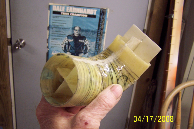

Lynn, are you talking about vanes you installed in the air duct from the
airfilter to the carb, and if so do you have a picture?

Sure do, Tex....here it is. I also have pictures of building the
vanes. The gist of it is, I cut the tube down the vertical middle,
then using two separate sheets of fiberglass, I built the vanes
inside the tube, then fiberglassed the tube halves back together.
