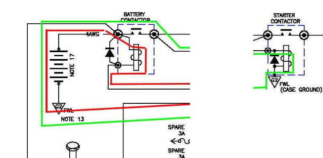

bob(at)bob-white.com
PostPosted: Tue Jul 07, 2009 8:55 am    Post subject: Spike catcher diode Reply with quote
Hi Wade,
You need to put the diode directly across the coil with the cathode
(the end marked with a stripe) connected to +12V. On a three terminal
contactor, +12V is on the terminal connected to the battery. Then
connect the anode to the small terminal used to actuate the relay.
Attached drawings lifted out of one of Bob's publications.

PostPosted: Wed Jul 08, 2009 7:09 am    Post subject: Spike catcher diode Reply with quote
At 10:53 AM 7/7/2009, you wrote:
On the stock Van’s battery contactor, there is only three terminals (two 5 1/6 and one 3/16 front and center). I am unsure where to install the IN5400 diode. Can anyone comment on proper placement? Also, what about the diode placement on the Van’s stock starter contactor? Please excuse my very “green” hands regarding electronics…learning!
One of the battery contactor's large terminals
should be marked "BAT". The diode's banded end
connects to this terminal. The other end goes
to the 3/16" terminal.
This was the image of Van's starter contactor
from his website.
[img]cid:.0[/img]
The right small terminal is marked "I" and
is not used. The left small terminal is power
from the starter push button on the panel.
The banded end of the diode connects to
this terminal also. The other end connects to
one of the contactor's mouning bolts
which is also airframe ground.

>my contactors to see if they have internal SCD's. It's been nagging
>at me for awhile and I'm nearing installing them.
The only contactors that I've sold with built in
diodes said so on the bottom of the mounting
bracket. If you have a 'scope it's easy to tell
in a simple bench test setup (or just keep your
fingers across the coil contacts while you break
the circuit . . . if you don't "jump" then
there's a diode installed.
Given that they are easy to get and inexpensive,
put them on unless you already KNOW that they're
present inside. Very few contactors come with them
built in . . . I had to search for the one I
sold.
( . . . a long habit of not thinking )
( a thing wrong, gives it a superficial )
( appearance of being right . . . )
( -Thomas Paine 1776- )
PostPosted: Tue Jul 14, 2009 4:33 am    Post subject: Spike Catcher Diode Reply with quote
At 08:03 PM 7/13/2009, you wrote:
Seems like you could test for a diode with a 9V battery and a volt meter..
Apply voltage to the coil in one direction, and something close to the
full voltage of the battery should be present.. Swap the terminals on the
battery, and the voltage on the coil should be limited to a diode drop -
maybe about 0.8V depending on what kind of diode they use.
MUCH better idea! Actually, if the 9V battery is fresh,
the contactor will pull in for BOTH directions of battery
connection if NO diode is present . . . and FAIL to pull
in for ONE direction if diode IS present.
