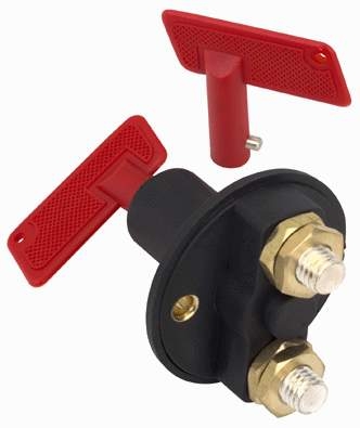

The legacy design goal for a battery master
disconnect is to provide a means by which nearly
all wiring in the airplane is 'cold' when the
disconnect is open. If the battery is conveniently
located then some form of manual switch can be
considered. Perhaps like this?
[img]cid:.0[/img]
[img]cid:.1[/img]
The next reason for a battery master disconnect is
to provide a means by which the battery can be
shut off if the starter contactor (solenoid)
sticks.
If the battery master cannot positioned conveniently
for manual operation, then perhaps a contactor is
indicated. These can be low power devices like the
EV series devices from TYCO . . . but it's pretty
easy to make an el-cheeso contactor emulate the
low power characteristics of the TYCO device.
Finally, a couple of guys on the list were working
on versions of remotely controlled, manual switches
like this:
http://aeroelectric.com/Catalog/AEC/9042/9042-100.pdf
In any case, there's two good reasons for a battery
master disconnect. The style is up to you as is
the choice for installing one.
( . . . a long habit of not thinking )
( a thing wrong, gives it a superficial )
( appearance of being right . . . )
( -Thomas Paine 1776- )

Your comments gave me another idea.. If you only have 12-14A to play with
(little dynamo), and the airplane has a starter.. And your normal running
power budget is a fairly high percentage of the output of the dynamo..
One could install a battery contactor (or starter relay) just for running
the starter - in series with any starter/engine mounted relay/solenoid.
Once the engine is running, the current draw from the monster contactor
can be eliminated and you can drop back to a more power-frugal relay for
driving the rest of the electronics on the airplane - a relay installed in
parallel. I can't think of any downside.
That would work too. I'm thinking that for small airplanes,
the manual battery switch makes the most sense. They're light
and inexpensive.
