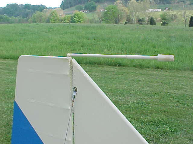

As far as I know, there is only way to stop the Kolb rudder from developing it's flutter when you ease the foot pressure off, and that is to add a bird roost to it. Guaranteed to work, and also to cause bird poop to appear on your horizontal stab. Using the counterbalance, the springs need only be heavy enough to enable the pedals to keep the cables snug.
Richard Pike

PostPosted: Mon Jul 20, 2009 6:34 am    Post subject: Rudder springs Reply with quote
Richard Pike

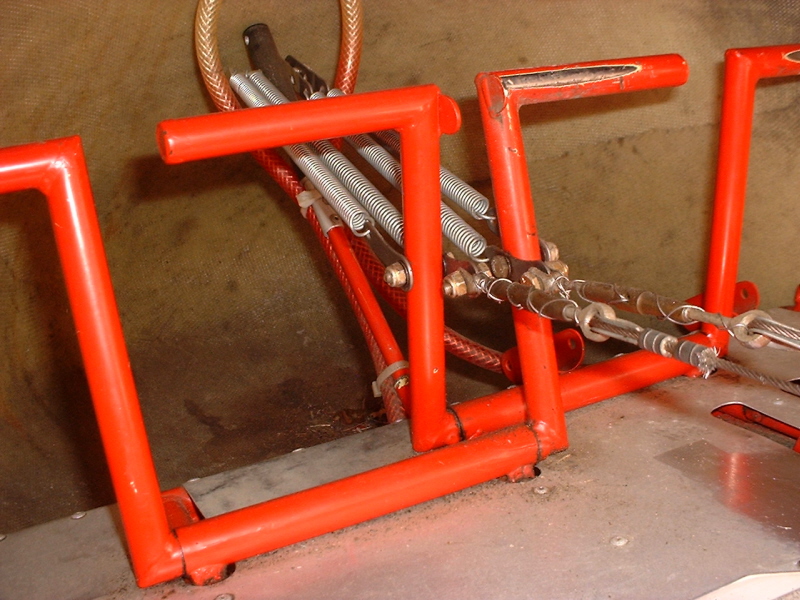

Mike B/Gang:
The reason I shared with the Kolb List the way I have my rudder pedals set
up was because it works well, it has been thoroughly tested over many long
hours sitting in the pilots seat, and it is a very simple fix. Add a couple
heavy rudder pedal springs to what you already have and...BINGO!!! you have
the problem solved.
No need to install a rudder counterbalance weight system, or a complicated
cable and pulley system. My philosophy is KISS, keep it simple.
However, I know there are folks on the List that like to experiment as much
as I do. So...maybe you all can reinvent a better wheel. Wink
BTW: My system does not progressively load up the rudder pedals, even
though the engineers on the List will argue with me on that point. All 4
springs are stretched in the neutral position. Full pedal deflection
sitting still on the ground has no more resistance than the standard Kolb
soft rudder pedal springs.
The large rudder trim tab works perfectly, keeping the slip/skid ball
centered at all cruise speeds. I challenge the perfectionist to measure the
amount of inefficiency produced by this system over twisting the engine
every which a way. Even if it costs a few cents more to fly my mkIII the
way it is configured, by God it works, and it works good. I fly for fun.
I think I'll keep my systems for now.
the problem solved.
I "snuck" a picture of John's rudder pedals when he flew into Douglas this year. It is attached.
Cristal Waters
Thanks, Cristal.
I had forgotten exactly how I had done it.
Had to offset one side to make them neutral.

Cristal
Did you attach that pic? I didn't get anything
Russ K
> Cristal Waters
Thanks, Cristal.
