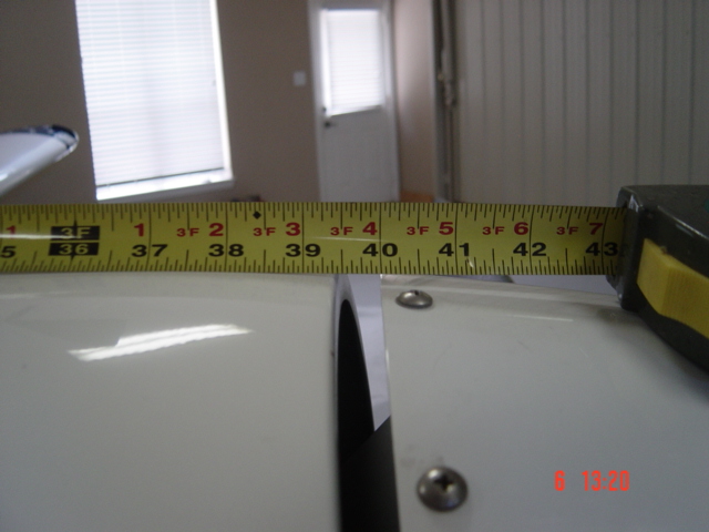

Gary,
I hesitated responding before this, because I thought you meant to the rear of the bulkhead where it mates to the crankshaft flange, and I had no way of accurately measuring that without a de-cowl.
If you're looking for the measurement from the rear of the cowl hinge to the rear of the spinner (flush with the rear outer edge of the bulkhead) , mine is 40" (pic attached) This is a 2004 AG-5B.
- MIke

Thanks Mike.  I'm glad to hear there are a few other 40 inch measurements out there.
I'm going to talk to the cowling fabricator and see how difficult it is to move the forward edge of the cowling opening.  Right now, those with 39 3/4 inch installs will need a special or cut down hinge.
Gary
