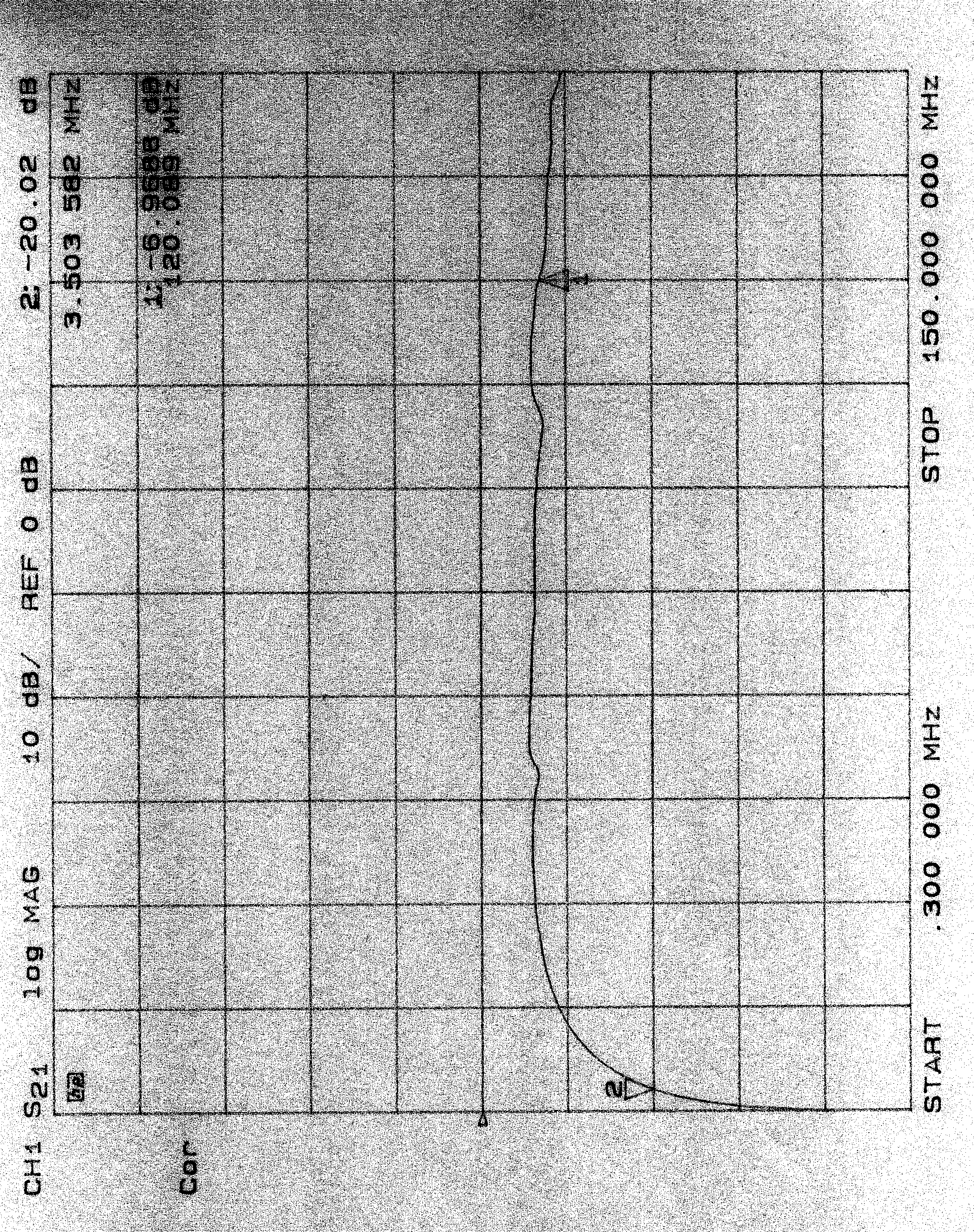

pa3arw(at)euronet.nl
PostPosted: Wed Jul 08, 2009 11:13 pm    Post subject: Interference Becker 4201 radio Reply with quote
Guys,
This is what I did: I purchased a good DC-DC converter and will install that in the next few days. In addition to the converter I'll install the Lonestar Eliminator power line filter in line with the output from the converter. This combination should eliminate any noise on the dc line to the 4201.
Just out of technical curiosity I checked the Lonestar filter on a HP Network Analyzer and found that the Eliminator is basically a High Pass Filter. (See attached plot)
Any frequency below 3.5 Mhz is cut off with at least 40dB. This means that any ingition noise is cut off very well. It also means that it will "stop" the 60KHz oscillation frequency of my DC-DC converter reaching the Becker radio. Technically it should work...now I'll install it and w'll see what happens....
I'll keep you all posted!.
