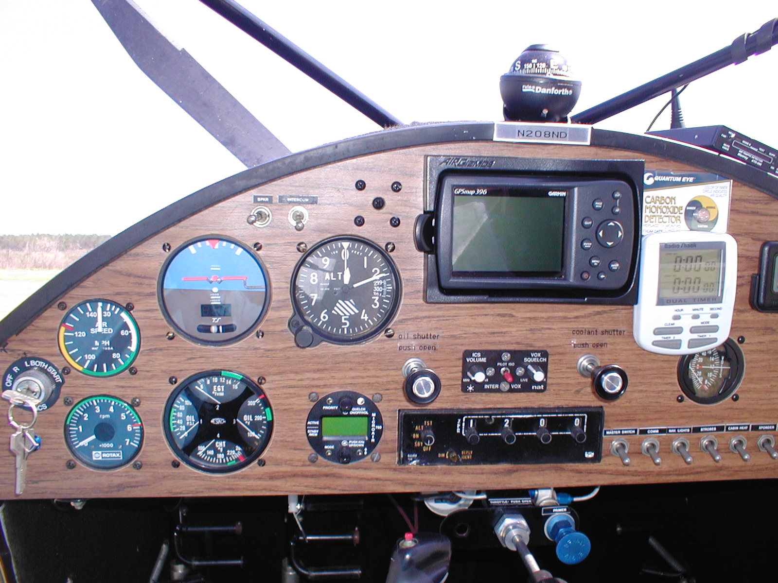

PostPosted: Tue Jul 14, 2009 3:53 am    Post subject: Re - fuel in oil Rotax 912ULS Reply with quote
I have been using Lowells oil cooler shutters for the past year and they work very well. (Highwing LLC)During the cold of winter (which isn't much here) I cut a piece of a magazine cover and slid it behind the shutters to block additional air and was able to control the temp very well without tape stuck to the cooler (which also works)
The nice thing is that you can control the oil temp from the cockpit.
