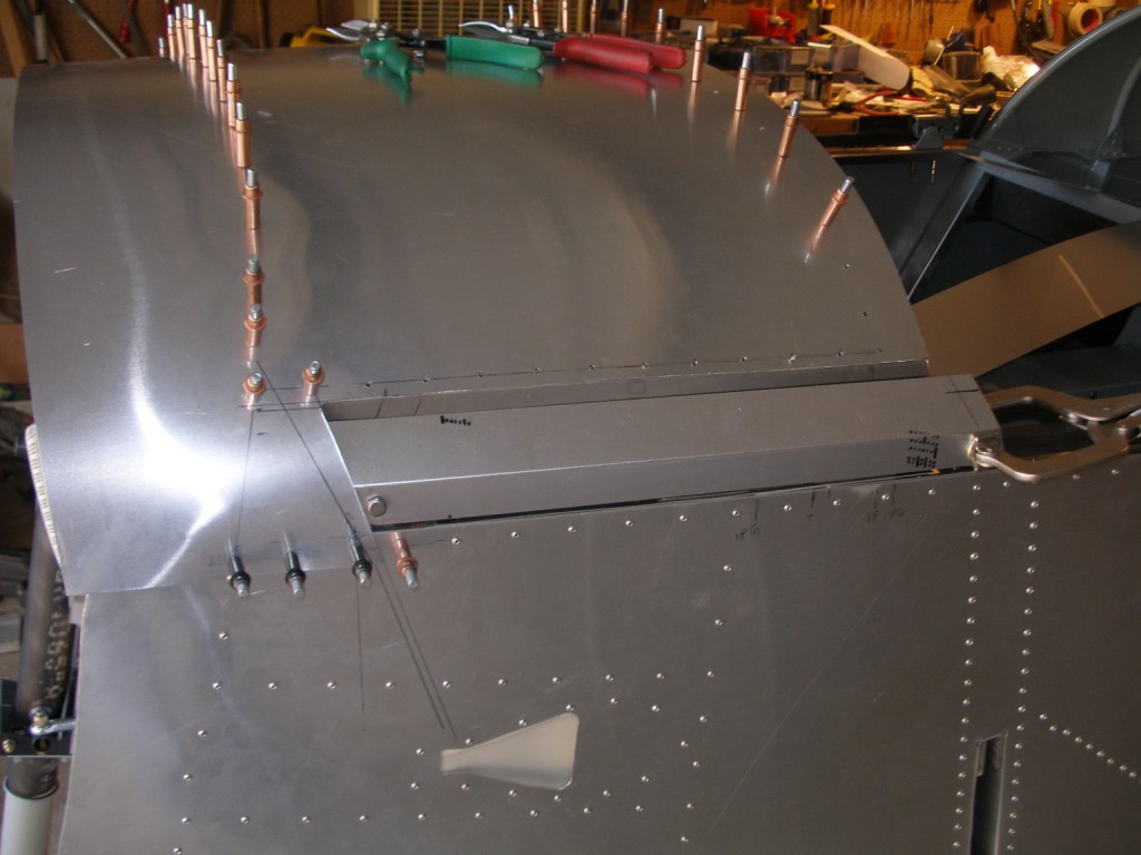

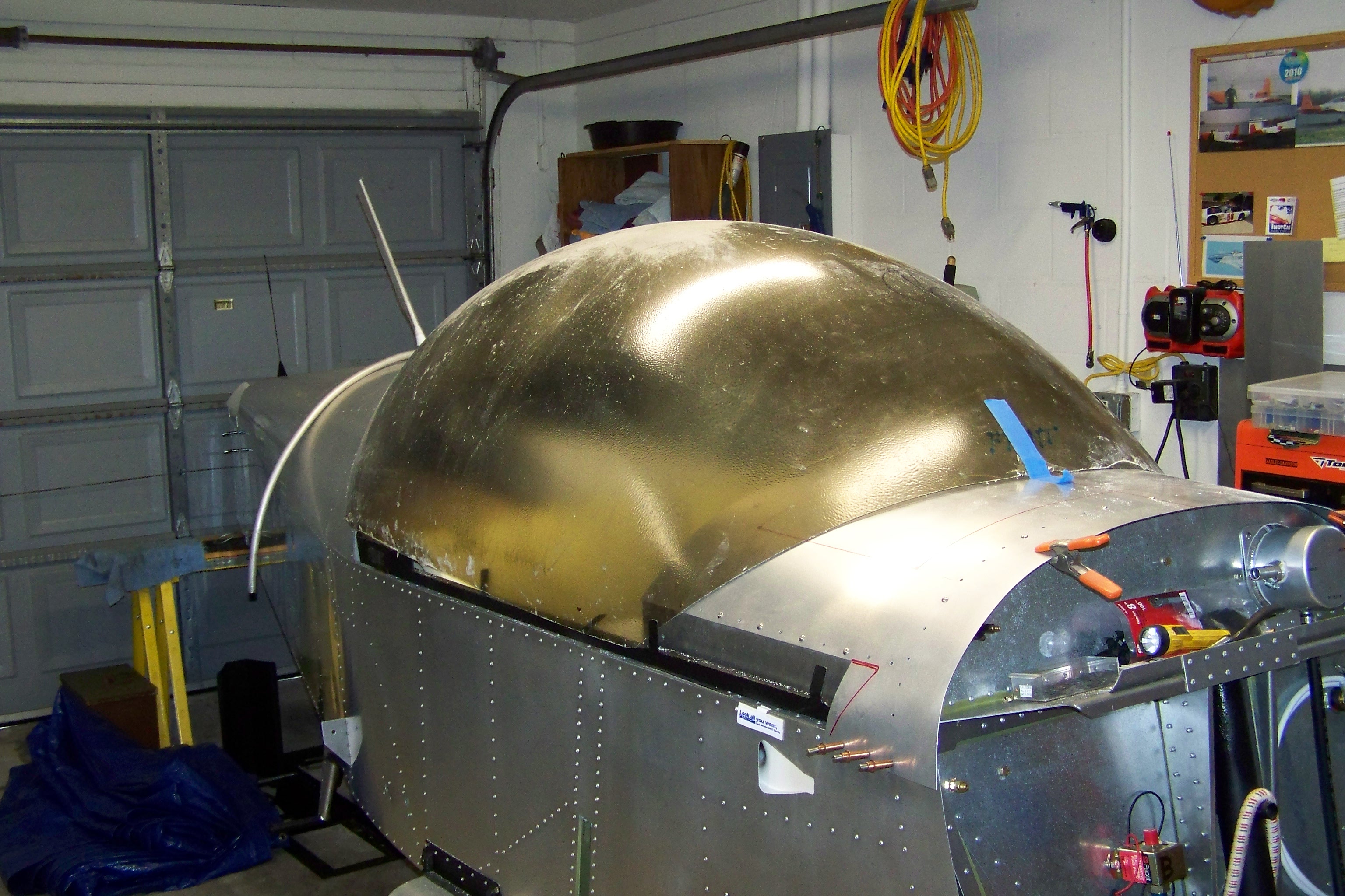

Enough arguing, lets build airplanes.
Put her hat on for the 1st time today. Pics self explanatory

Bill,
looks great. One question - how did you mount the NACA scoop? No rivets seen there.
Pavel

Bill-
The upright tabs on your canopy side rails are totally different from anything in either my old or new XL canopy prints. Is this something new or your mod? This would be timely information, because I'm finishing off building my side rails as we speak.

Hey Pavel,
The NACA scoops are glued in place. I was contemplating whether I need to add rivets but believe I will do so. They've been on for some time now but I'm not convinced they will stay in place.

Hey Bill,
Don't know about the tabs other than that's the way they came in the kit.

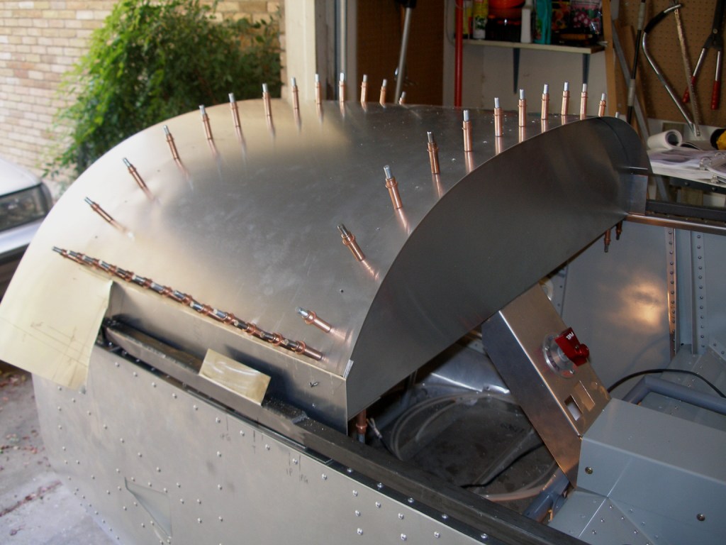

jaybannist(at)cs.com
PostPosted: Thu Jun 18, 2009 12:47 pm    Post subject: What Did You Do Today? Reply with quote
The tabs on my canopy frame looked a lot different. I had to do a lot of shimming, trimming and standing on my head to get the cover panels to fit right. I still have trouble with the rubber seal when the canopy is opened.

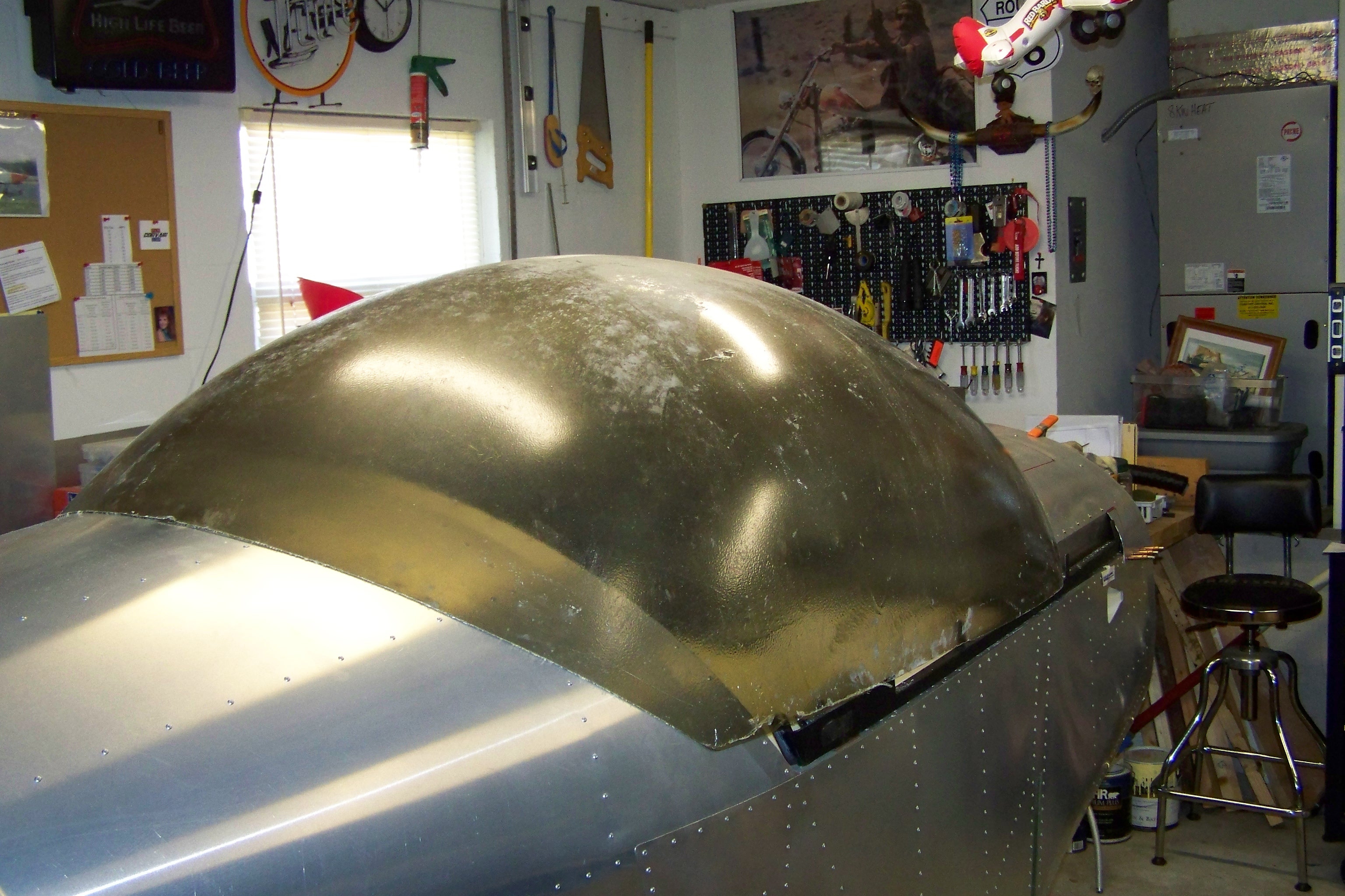

PostPosted: Thu Jun 18, 2009 2:08 pm    Post subject: What Did You Do Today? Reply with quote
Bill,
In the first photo, you can see what the tab on the canopy frame looked like. The second photo shows the cover plate in place and the last one shows it with the rubber seal in place. My canopy kit was purchased in August, '06.

PostPosted: Thu Jun 18, 2009 3:50 pm    Post subject: What Did You Do Today? Reply with quote
Jay-
Your setup looks like the latest prints I have. I hope Gig gets back to me.
I'm trying to put together a canopy from old and new XL prints and there are tons of discrepancies. Some print dimensions are flat out wrong.
