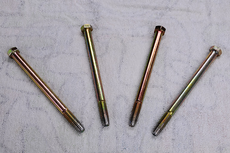

I did this recently, and it went very smooth.  Hardware store bolts with the threads ground down, some dry Boe Lube on them, and the slightest taps with the dead blow hammer.  That's all it took.  The bolts popped out just as easy when ready.

The wings and bolts should attach and detach fairly easily, and hardware
store bolts are the way to go. The hardware store bolts will be slightly
smaller in diameter than the close fit bolts that will be used in final
assembly. Just make sure to grind 'em to a taper and they will go in very
easily. Drive them out with a smaller sized bolt facing the other way. No
damage should result.

It's not a problem. "Normal" bolts are a tad bit undersized by
design. As another poster suggested, grind off the threads and put a
nice chamfer on the end of it and don't be afraid of lubrication. You
won't have any problems.
You'll do far more damage if you try to use the high dollar bolts that
come with your kit. Those will require some pretty good taps with a
dead blow hammer. Save those until the wings go on permanently.

For fitting the wings on my 6A, I cut the heads off from the hardware store
bolts and put a slight taper/chamfer on the cut end. The cut end went into
the hole leaving the threaded end available for with drawing the bolts using
a nut and washers. Worked well.

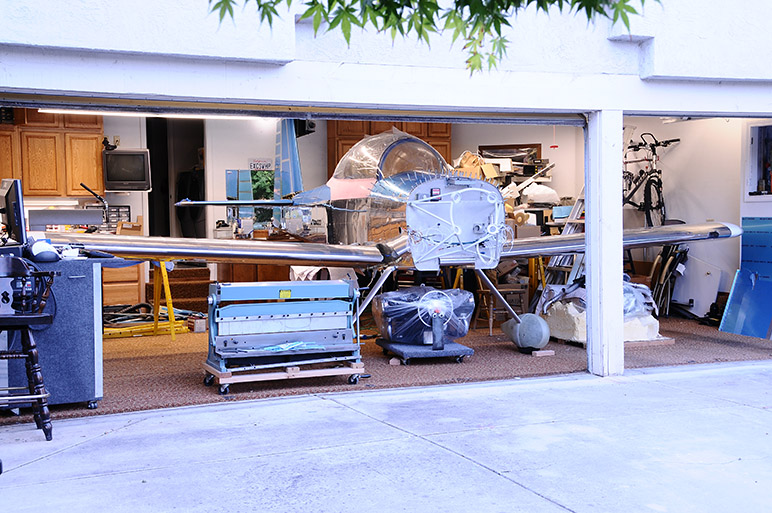

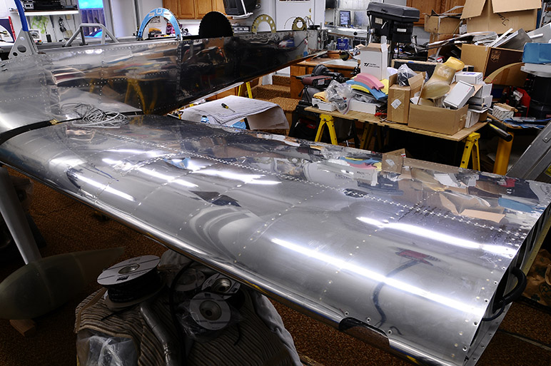

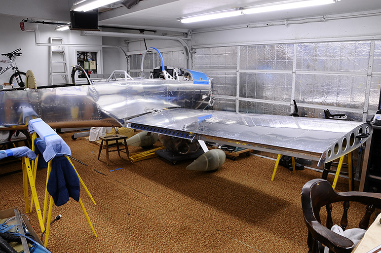

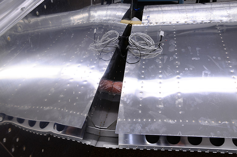

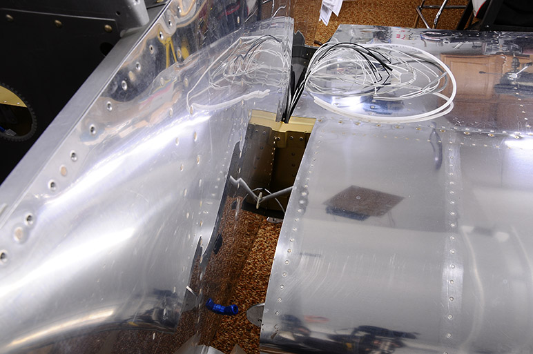

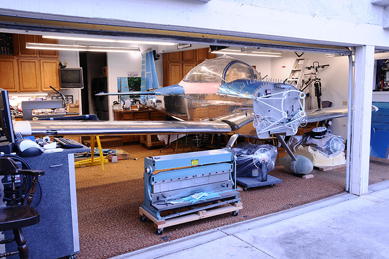

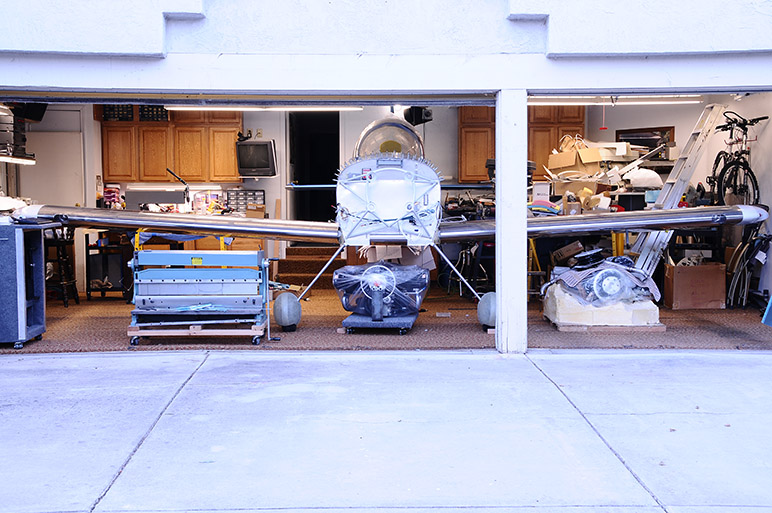

I want to thank everyone for the help on mounting the wings. The mounting went without a hitch today. The hardware store bolts just slipped right in with no problem. Highly recommend. I would say that they will be very useful in the initial alignment prior to inserting the close-tolerance bolts too.
Once the wings were on, I just had to put all the other stuff on the plane to get an idea of what it looked like. Awesome! I thought I'd share a couple of pictures... Yahoo!
Thanks again!
Thanks again!
