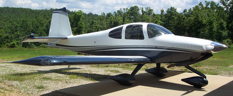

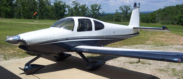

PostPosted: Tue Jun 30, 2009 9:13 am    Post subject: NACA vent location(s) in rear Reply with quote
Bob,
  I am on the road now and don’t have a good construction photo on my notebook but here is an exterior photo that shows the most common location for the NACA vent. It works great. Some say that you only need one vent vs. one on each side but as far as I can tell everyone still installs two vents. The cooling of an OH console is one of the nicest mods you can do for comfort.
Robin
http://www.painttheweb.com/rv-10/console.htm

Deems Davis
Posts: 925
PostPosted: Tue Jun 30, 2009 9:28 am    Post subject: NACA vent location(s) in rear Reply with quote
Start here:
http://deemsrv10.com/album/Sec%2043%20Cabin%20Cover/slides/DSC04399.html
and click forward (Next image)
Deems

PostPosted: Wed Jul 01, 2009 3:05 pm    Post subject: NACA vent location(s) in rear Reply with quote
More than happy to shout you a "Coopers" or two, or three, or........ for that feedback Grumpy. Thanks for the response.
Hope to see you down under sometime soon.
Pat
From: Miller John <gengrumpy(at)aol.com>
Sent: Wednesday, 1 July, 2009 3:04:21 PM
Subject: Re: NACA vent location(s) in rear
As an early builder, I put 2 home-made scoops (not the NACA vents) on either side of the fuselage, and just underneath the horizontals (to keep rain out, ya know).
I also put mesh screen over the intake to keep critters out (as Patrick asks) and it works! (please don't give me wasps or hornets flying about as I'm trying to comply with instructions from our friends in ATC).
After 2 years of my home-made vents, and seeing what the NACA vents actually do up front, I think that 1 NACA vent aft near the horizontals will do just fine for amount of flow needed to the overhead console/vents.
I also found that in winter (S Mid TN) I actually have to plug my vents up on the outside to keep cold air out of the cockpit......as well as put a butterfly valve on air supply to the tunnel vent entrances.....
My 2 cents won't buy a good Pilsner in Adelaide.....
Grumpy
On Jun 30, 2009, at 8:23 PM, Patrick Pulis wrote:
Deems, could you (or anyone else with the overhead fitted) please indicate if only one vent would be sufficient to provide enough ram air to the overhead console?
Has anyone considered the need to install mesh over the NACA vent holes to keep out the 'critters' or would foam inserts be sufficient when parked, especially when travelling away.
We have plenty of little flying 'critters' her 'down under' and no doubt you have similar problems with 'critters' up over?
Patrick Pulis
Adelaide, South Australia
From: Deems Davis <deemsdavis(at)cox.net (deemsdavis(at)cox.net)>
Sent: Wednesday, 1 July, 2009 2:55:37 AM
Subject: Re: RV10-List: NACA vent location(s) in rear
--> RV10-List message posted by: Deems Davis <deemsdavis(at)cox.net (deemsdavis(at)cox.net)>
Start here:
Deems
N519PJ
www.deemsrv10.com
Bob and Karen Brown wrote:
Can anyone post a pic of where you located the NACA vents to run air to overhead console vents? Are you happy with the location and do you have any problem with moisture?
Thanks!
Bob Brown
Independence, OR
0-List" target=_blank>http://www.matronics.com/Navigator?RV10-List
Access Yahoo!7 Mail on your mobile. Anytime. Anywhere. [url=http://au.rd.yahoo.com/mail/mobile/tagline/*http://au.mobile.yahoo.com/mail]Show me how[/url].
=========== tp://www.matronics.com/Navigator?RV10-List =========== nics.com ==================================== w.matronics.com/contribution ====================================
he many List utilities such as List
="http://www.matronics.com/Navigator?RV10-List" target=_blank rel=nof; h======================== _et=_blank rel=nofollow>http://www.matronics.com/contribution
Access Yahoo!7 Mail on your mobile. Anytime. Anywhere. [url=http://au.rd.yahoo.com/mail/mobile/tagline/*http://au.mobile.yahoo.com/mail] Show me how[/url]. [quote][b]
rv10free2fly(at)yahoo.com
PostPosted: Wed Jul 01, 2009 3:06 pm    Post subject: NACA vent location(s) in rear Reply with quote
Many thanks Bob.
Pat
From: Bob and Karen Brown <bkbrown(at)minetfiber.com>
Sent: Wednesday, 1 July, 2009 12:37:09 PM
Subject: RE: RV10-List: NACA vent location(s) in rear
I installed an aluminum screen mesh on the naca vent holes on my RV7A, and would certainly recommend it…no fun having wasps cruising around inside your airplane on short final…
From: owner-rv10-list-server(at)matronics.com [mailto:owner-rv10-list-server(at)matronics.com] On Behalf Of Patrick Pulis
Sent: Tuesday, June 30, 2009 6:23 PM
Patrick Pulis
From: Deems Davis <deemsdavis(at)cox.net>
Start here:
