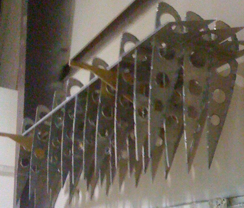

i just met Rob Stapleton from the anchorage eaa chapter 42 www.eaa42.org great guy . he says that there are a couple 701's flying in his chapter and a 801 plus a 701 in progress ... check out the site (i would join if i was closer), might be something for you to consider. He said that there is a wasillia chapter too.
ribs and nose ribs installed on 3 left wings
Dave

Interesting wing rib setup. Long wing?

Well I count 7 full ribs and 3 rear only ribs on that front spar in the pic. And the spar tip looks extended as well.

Wings stretched 18'' or 3' overall I'm impressed u caught it.... False ribs are made out of .016.
Were going with the vg's and lengthening the the wing a little.
So the ribs I under stand but how did u figure out the length? Were u looking at the tip length or rib spacing?

The spar tip is clearly longer, but as John knows I am concentrating right now on the wing so I have been looking at a lot of 701 spars, both long wing and standard.
John the pic is in the message before my comment.

we just went with JG's idea from stolspeed for the length and the 43.13 for the splice/doubbler. The false ribs was just easier than the L angle idea for anti-oilcaning we already had the formers and .016 ribs makes the weight negligible.
