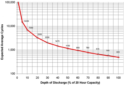

You mentioned in the earlier post that you thought
you might have seriously whacked the battery's
ability to store energy when you allowed it to be
so severely depleted. This is generally no big
deal.
Brand new batteries subjected to a series of 90%
depletion cycles will slowly drop in capacity with
each cycle. Most RG batteries are good for several
hundred deep-cycles before they lose 20% of their
capacity.
[img]cid:.0[/img]
Here's an exemplar cycle-life performance curve for a
lithium battery . . . lead-acid curves are similar
they just don't go out to those really big numbers.
But a single deep discharge of your battery followed
by a recharging activity does not seriously affect
future performance.
Now, leaving the master switch on and leaving the
battery discharged for a couple of weeks is another
matter . . .

http://www.aeroelectric.com/Pictures/Curves/turbine_start_a.jpg
. . . it takes about 20 seconds for cranking
current to taper from 800A to 300A and another
7 seconds to go to zero. Yet this 44 a.h. battery
is tapped for only 5 to 6 percent of total
stored energy. In piston singles where the engine
starts readily, it's about half that total.
deal.
capacity.
future performance.
matter . . .
