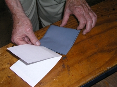

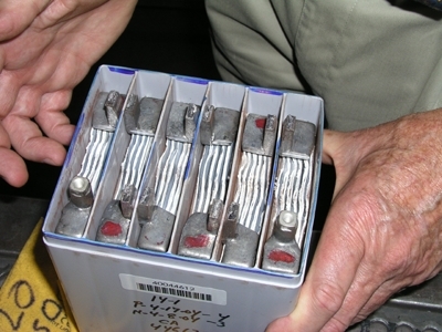

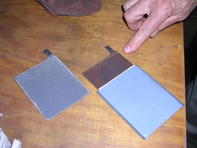

Probability of cell shorting is exceedingly
low because the typical RG battery has
physical barriers of porous plastic and/or
glass mat fiber between plates . . .
[img]cid:7.1.0.9.0.20090630150713.01e78470(at)aeroelectric.com.0[/img]
[img]cid:7.1.0.9.0.20090630150713.01e78470(at)aeroelectric.com.1[/img]
[img]cid:7.1.0.9.0.20090630150713.01e78470(at)aeroelectric.com.2[/img]
As you can see in these views on a Concorde RG
battery, alternate plates are completely bagged
in fiberglas and plastic. No shorted cells in
this product.
