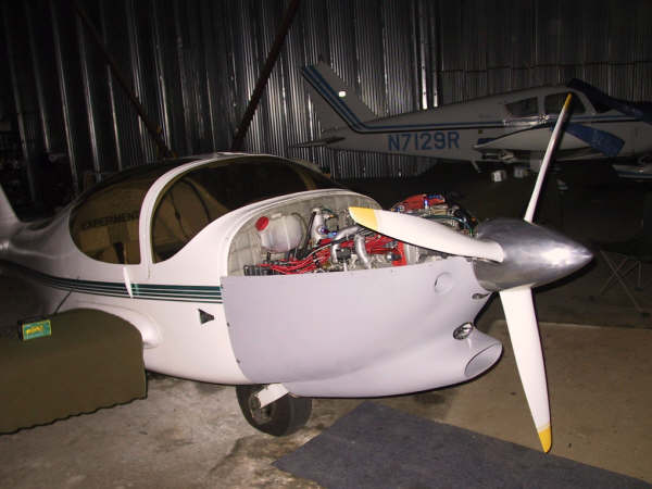

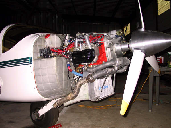

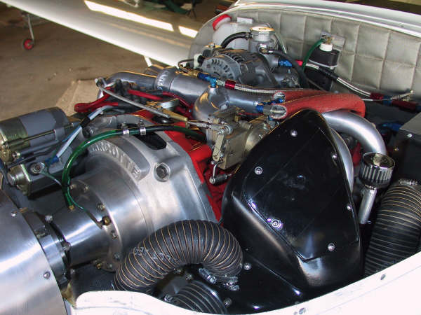

.ExternalClass .EC_hmmessage P {padding:0px;} .ExternalClass body.EC_hmmessage {font-size:10pt;font-family:Verdana;} The Ram dual port EA81 has run flawlessly for me for five years.  Not a single engine problem C starts instantly C great fuel burn C 160 mph cruise (at) 5300 rpm.  I did adjust the valves once a year or so ago.
I am thinking of trying the new Ram Supercharged 140 with a Lipps prop so that could be
another adventure!
