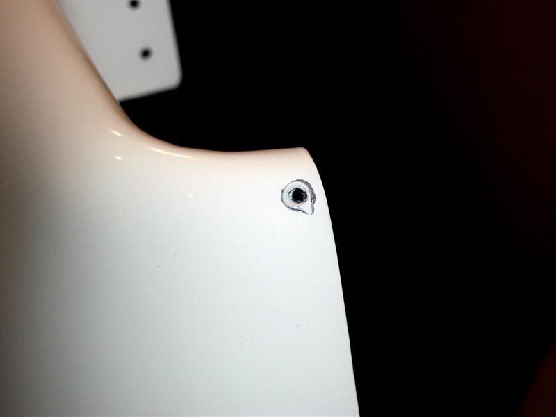

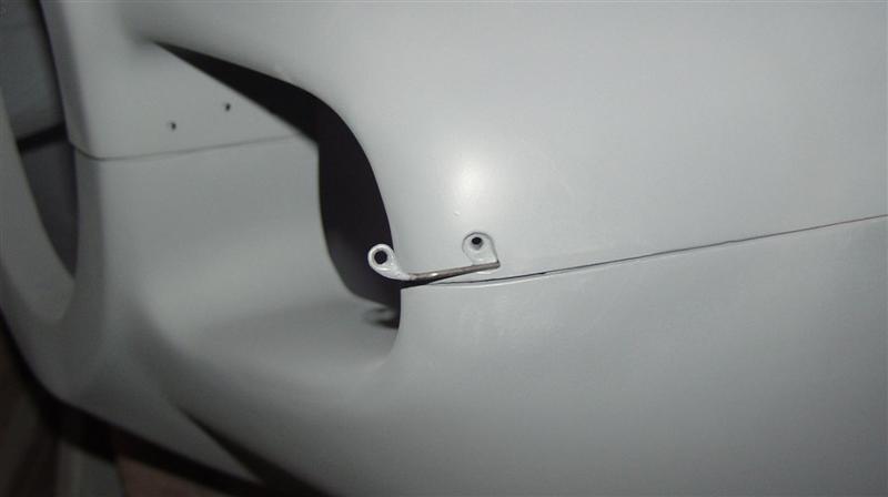

PostPosted: Wed Jun 24, 2009 6:29 am    Post subject: Re: Cowl knuckles - are fabrication directions missing from Reply with quote
Hey Bill,
There are several creative and beautiful mods out there for this. Here's a couple of pictures of what I did that was simple, cheap, time consuming!
With a white painted screw that is countersunk, it almost disappears.
Later, - Lew

PostPosted: Wed Jun 24, 2009 11:25 am    Post subject: Cowl knuckles - are fabrication directions missing from pla Reply with quote
Very nice Lew.
I've decided the cowling is not a place for me to express myself. I
have to confess to not being able to grok the whole cowling hinge pin
operation until I finally started doing 47-7 step 6. After reading it
and re-reading it, I self diagnosed brain constipation and soldiered on
until finally reaching 47-7 step 6. What a relief.
I'm hitting the order button for the Vans part as I write.
Bill "looking forward to the engine baffles" Watson
