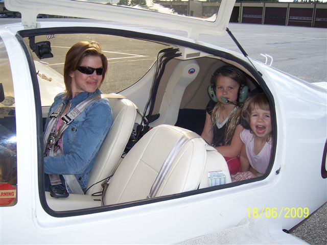

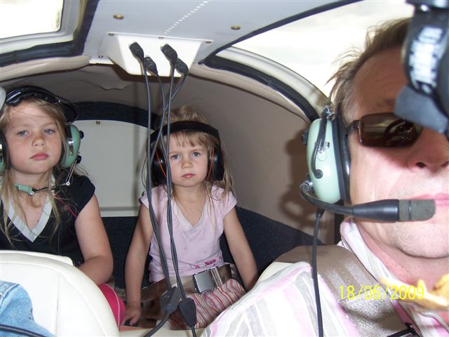

I am happy to let you know we had today "Europa 4-seater flight".
That has been my dream since I started building 1999.
Actually, there were my daughters Tuuli 8 years and Merete 5 years.
Me and my wife omboard with full thank TOW was 656 kgs (1443 lbs).
My MTOW is 658 kgs (1450 lbs).
Our CofG was well between limits (almost center because added Airmaster prop hub 7 kgs (15,4 lbs)).
Everything went WELL and there were not any problems.
Children had fun - Europa is a real family machine!
I am going to have a 4-place intercom next.
My Europa will be permitted (in this country) for 4-seater (actually 2+2), max 60 kgs (132 lbs) on the back seat (with certified seat belts).
So, Europa XS is almost like that French fun machine Dyn Aero´s 4s...
Raimo OH-XRT

Looks like pretty precious cargo Raimo...congratulations.
You make a good case for the pair of round windows aft which I've been thinkin about...

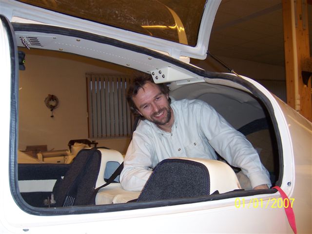

Look at an attachment - that brave maiden flight pilot is about 1750 mm = 69" tall (please do not tell him).

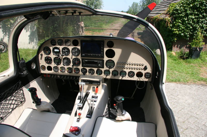

Actually, I weighed the (empty) original Europa instrument panel, and
compared it to my fully equipped instrument panel (I expect my empty
panel to be lighter, but never weighed it). The difference is 10 kilo's.
So, I think I'm not an exception to have all instrumentation and wiring
together at 10 kilo's. Practically everything in the panel is light
weight (the backup GPS has been trimmed down to only half its weight for
example). The attitude indicator is an exception with 2 Kg's... Still,
it could have been lighter with only very basic instrumentation, but I
like toys and redundancy. Wink
On the other hand I have light weight batteries, only 2 propeller
blades, and a few other weight-savers...
For those who wonder: The new instrument panel does not extend lower
than the original panel, and is not obstructing the forward vision. The
"extra" space is for the most part due to optimization of the available
space. The original instrument panel wastes a lot of space by its thick
edges, boundaries, and unnecessary division into sub-compartments. I had
about 2.5 cm (1 inch) additional panel height available because I have a
(modified) high-top. The firewall height is halfway between mod 64A and
mod 64B; just perfect. Wink Can still see the nose, but not the entire
cowling.
