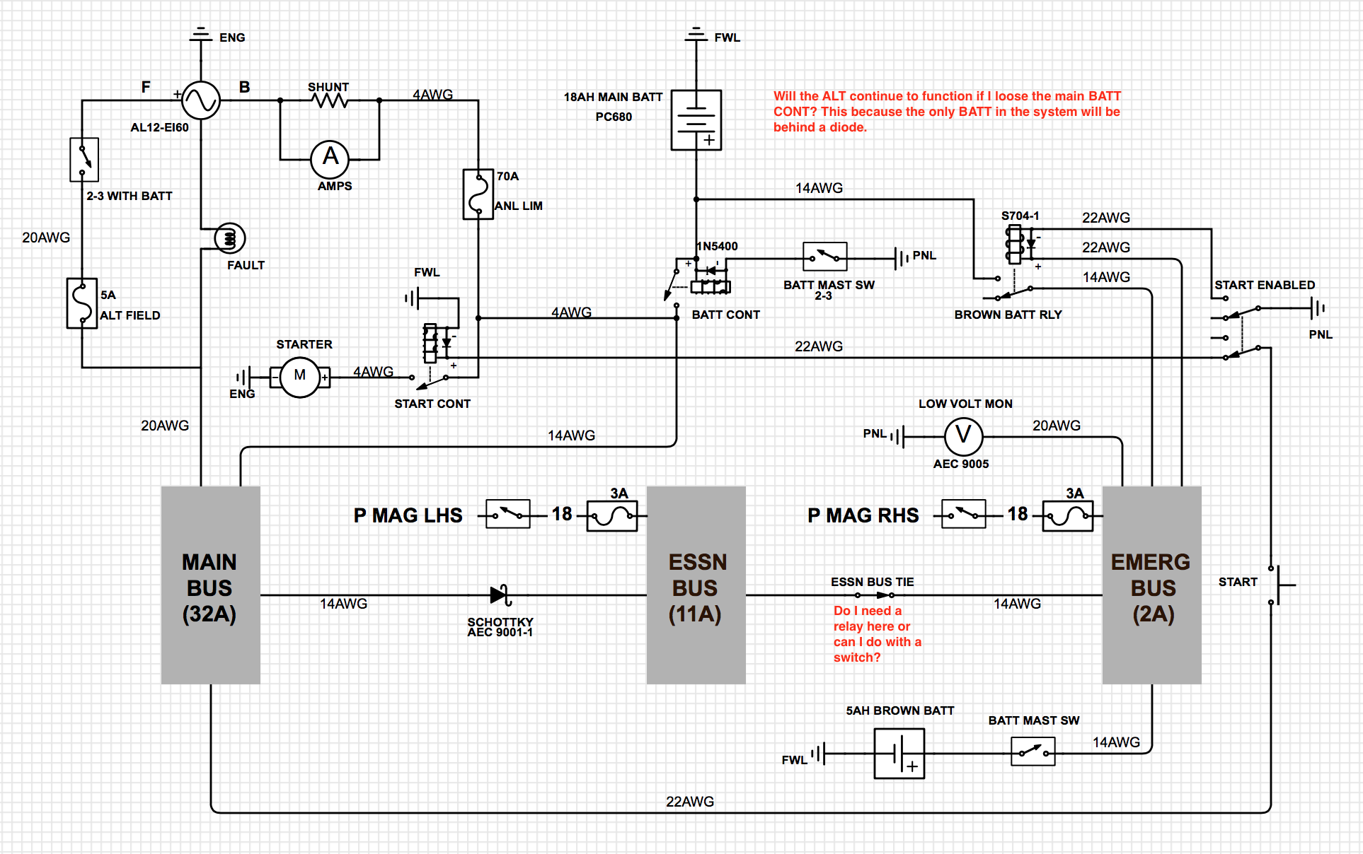

Dear List,
Your expert advice please. Thanks in advance.
Roger.
[img]cid:1ec52094-f3e4-4cb4-89a7-6605759610aa[/img]

A switch is OK for the essential bus tie. A relay is not necessary.
The alternator will most likely continue to operate without a battery connected, but its output might not be stable.
Most aircraft do not have a backup for the master battery contactor. I am not necessarily recommending a backup, but if it is desired, a relay could be connected in parallel with the contactor. The relay should be disabled during engine cranking to prevent starter current from flowing through relay contacts.
