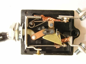

Breakers that assuage concerns for aircraft designers
have terminal bosses compatible with bus bars that
tie multiple devices together. Like . . .
[img]cid:7.1.0.9.0.20090618222044.01c66008(at)aeroelectric.com.2[/img]

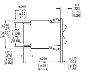

The R11 has fast-on tabs that do not lend themselves
to direct connection to bus bars.
[img]cid:7.1.0.9.0.20090618222044.01c66008(at)aeroelectric.com.3[/img]

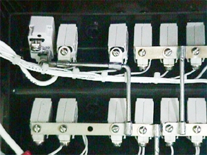

Bonanza and Baron owners are presently saddled
with some parts-count issues in the utilization
of this breaker/switch . . .
[img]cid:7.1.0.9.0.20090618222044.01c66008(at)aeroelectric.com.4[/img]
It's a sure bet that they're wishing we'd not
strayed from the simple breaker-panel, switch-
panel architecture common to most other airplanes.
This albatross involves about 80,000 fielded
breaker/switches.
