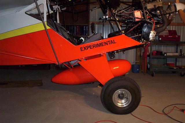

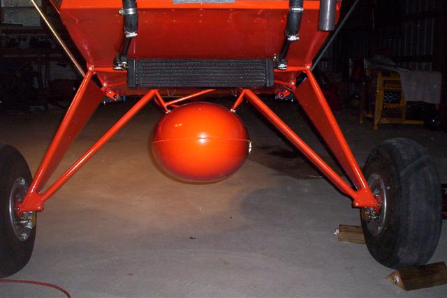

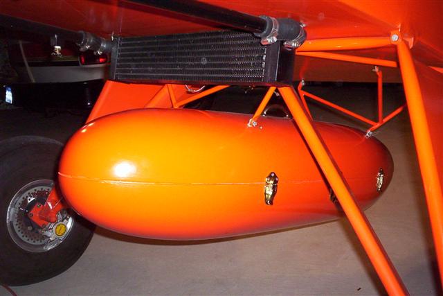

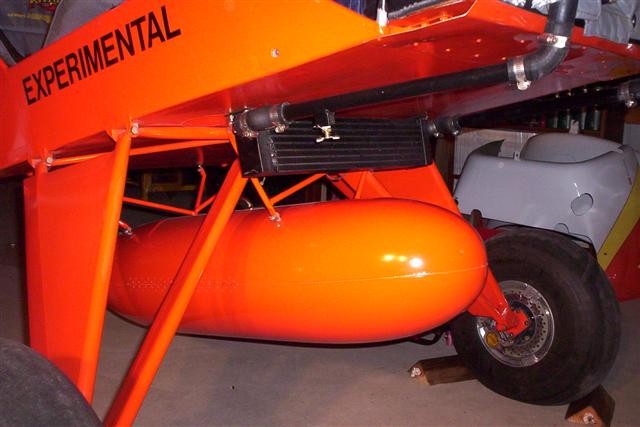

 Filesize:  40.85 KB
 Viewed:  8800 Time(s)
 Filesize:  42.22 KB
 Filesize:  45.25 KB
 Filesize:  45.32 KB
