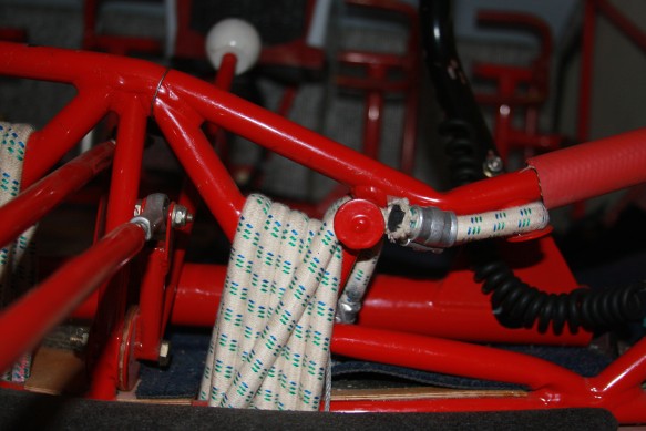

Is there anybody out there with a model 5 that is not covered that could take some pics of the area where the gear connects and the front seat supports(where the bungees would connect. I am going to strengthen my classic 4 in these areas after I got some bent tubes and would like to see what changes were made to the model 5.

Right now the plan is to change to the grove gear. We have been kicking the
idea around for a while now anyway as my Step father and co-owner of the
plane is just now learning how to fly so there are bound to be some more
hard landings. I have seen some pics of model 5's with out cover and
noticed a gusset on the side where the gear connects to the plane. I would
like to add this to the plane and some good pictures showing location would
be great. I got 1 from Kitfox but it is to close to really tell what tubes
it is covering. Also if anybody has any pictures for a model4 with the
grove gear showing where it mounts those would also be helpful.
If anybody can help it would be greatly appreciated
Kirk hull
Kitfox Classic VI
N205AK Kansas City MO.

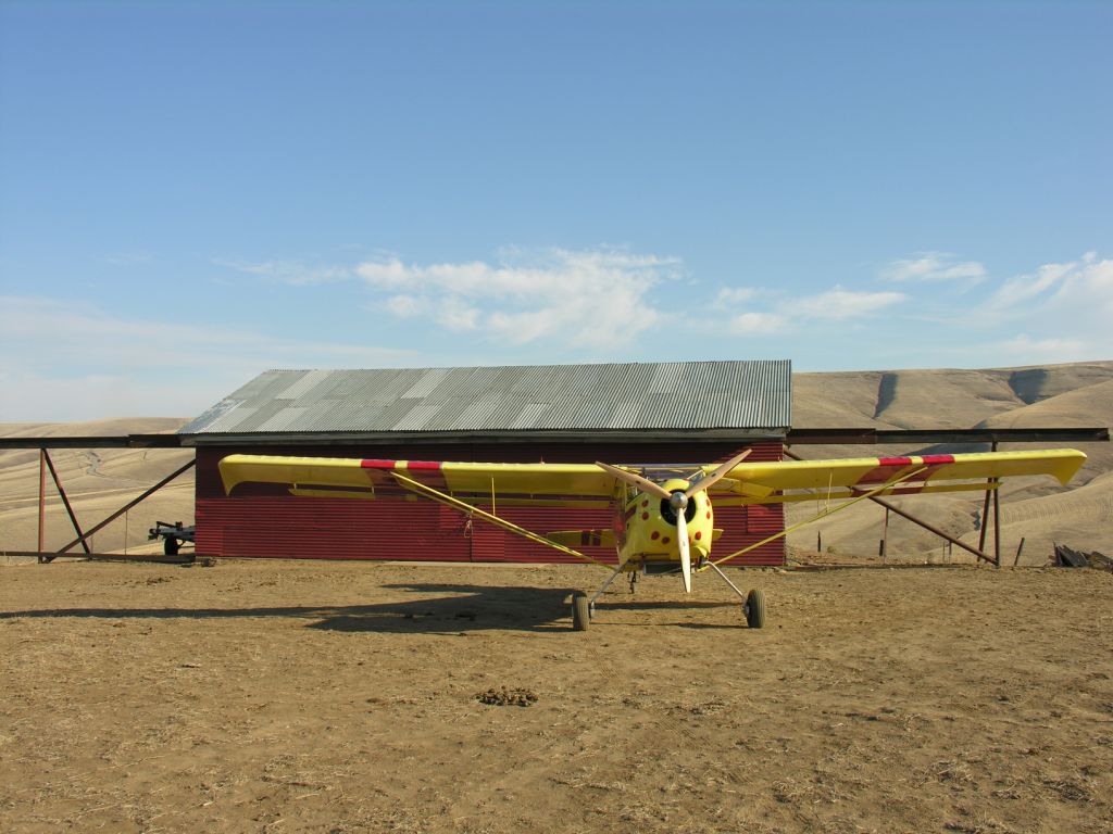

f.miles.tcp.833(at)clearw
PostPosted: Thu Jun 11, 2009 5:51 pm    Post subject: model 5 gear pictures Reply with quote

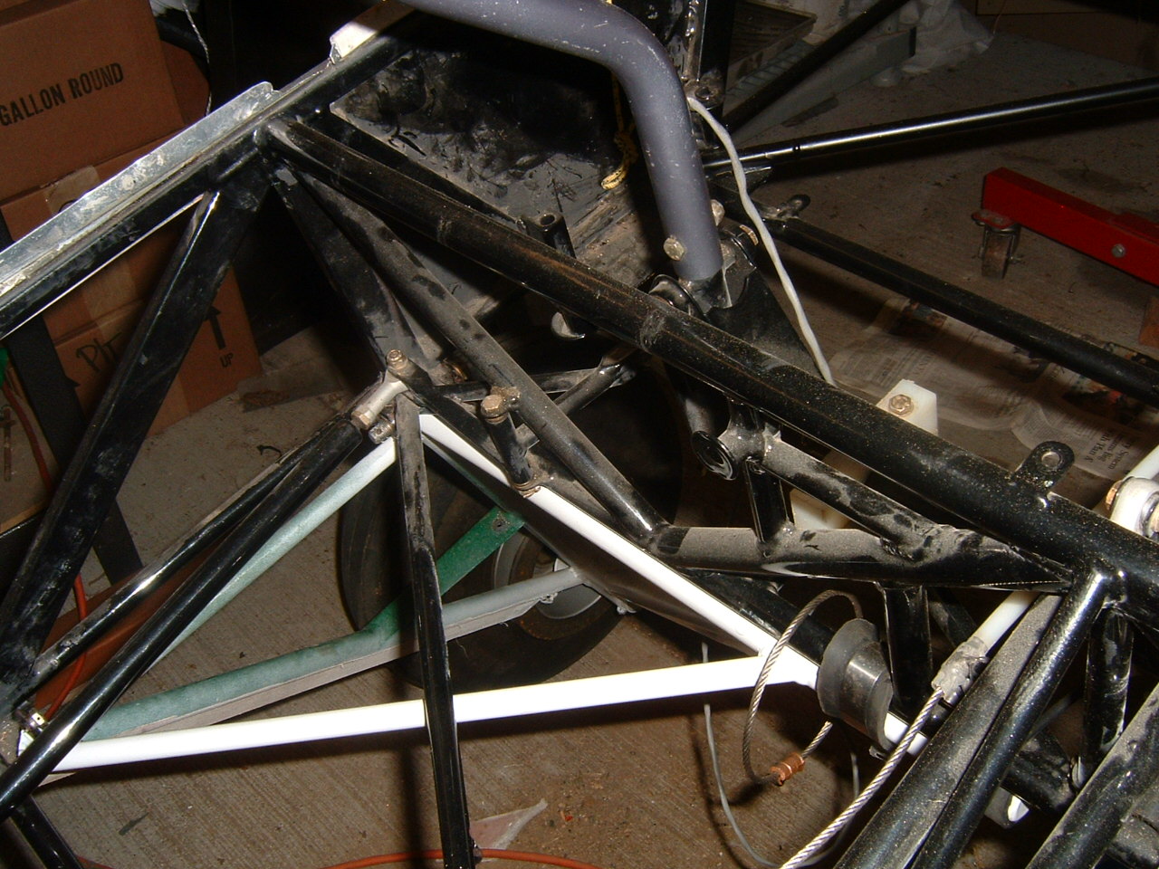

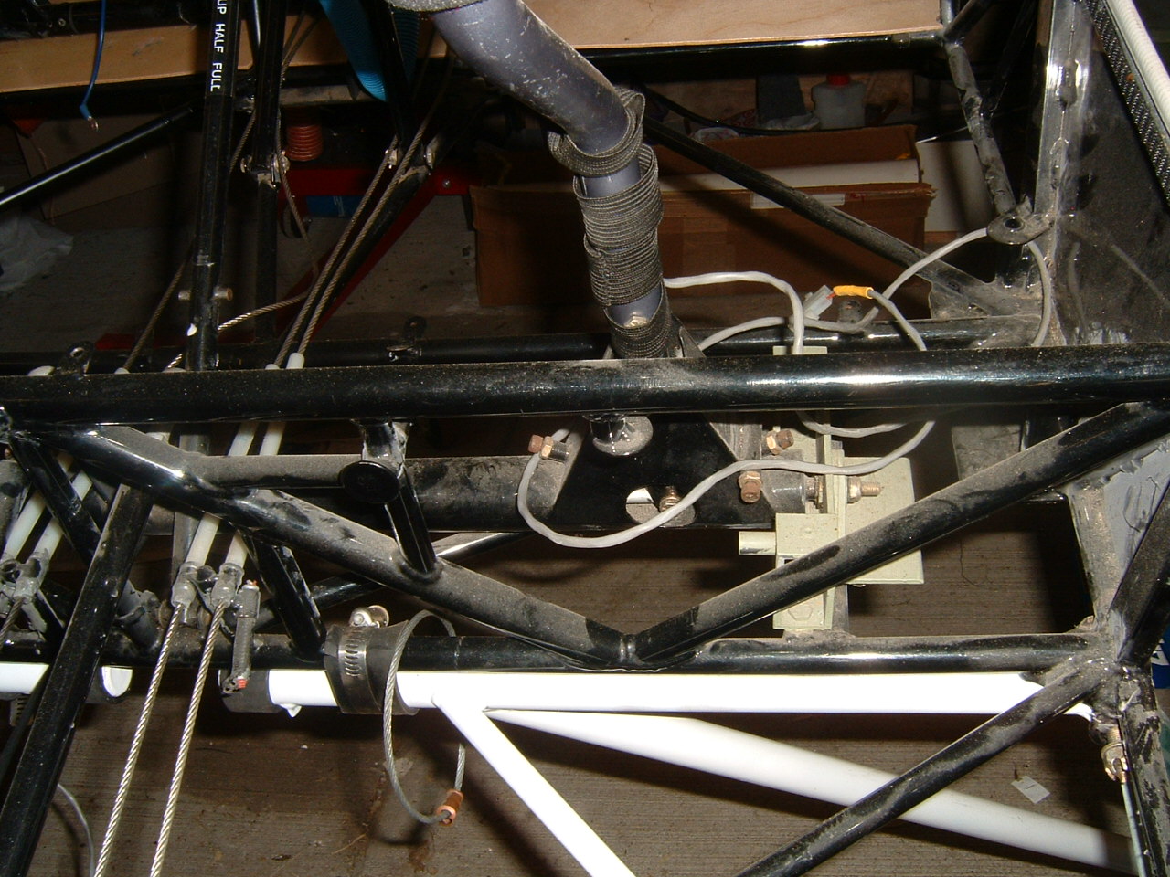

I have a Mdl. III with the Grove gear, wheels and brakes. Much more stable
than the old gear and very forgiving. I have put about 70 hours on it and
would not go back. If I remember right, it is about six inches wider.
See attached picture. I think that the four is very similar.
Frank Miles
Lewiston, Idaho

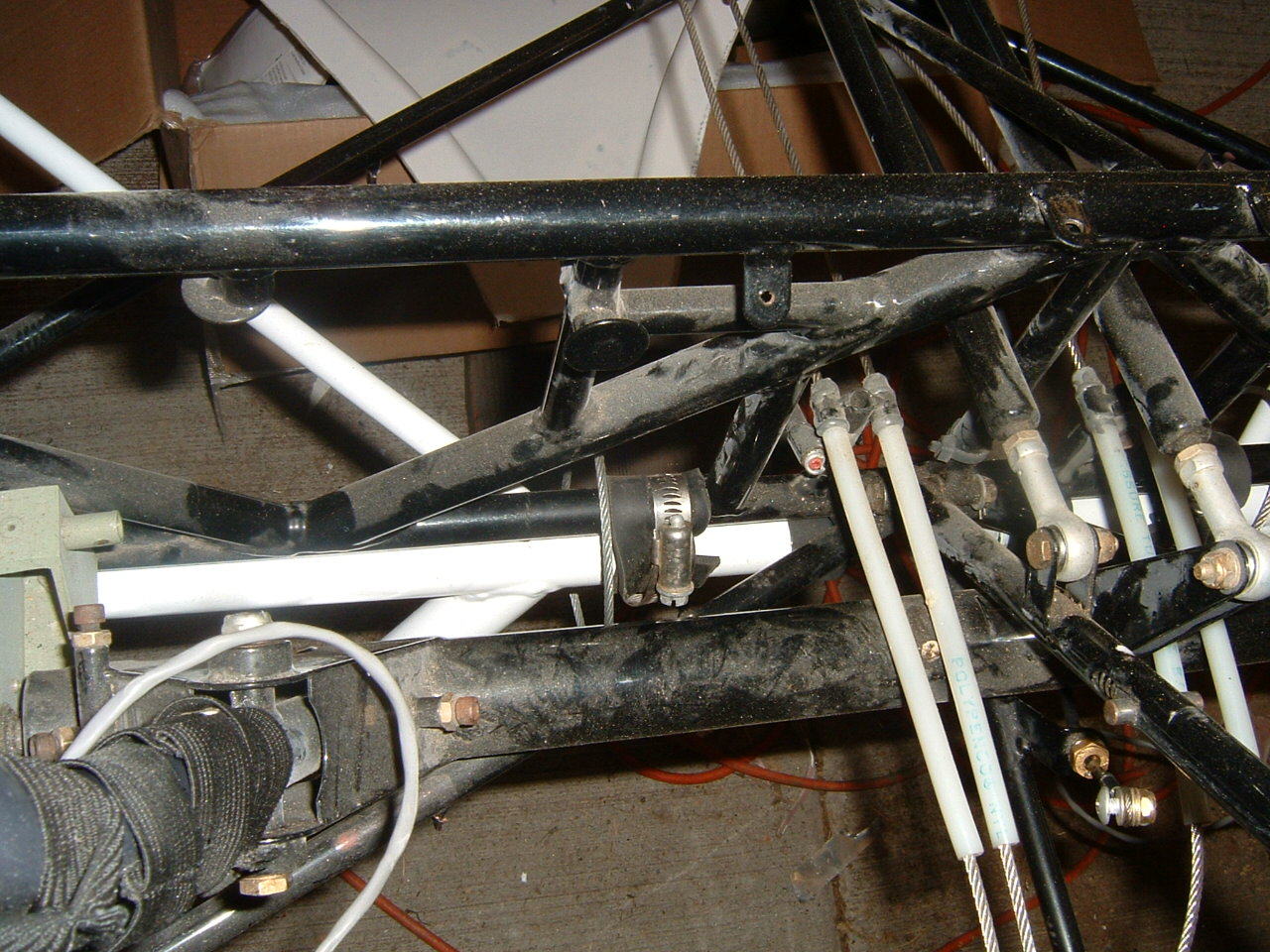

PostPosted: Thu Jun 11, 2009 6:12 pm    Post subject: model 5 gear pictures Reply with quote
Kirk-

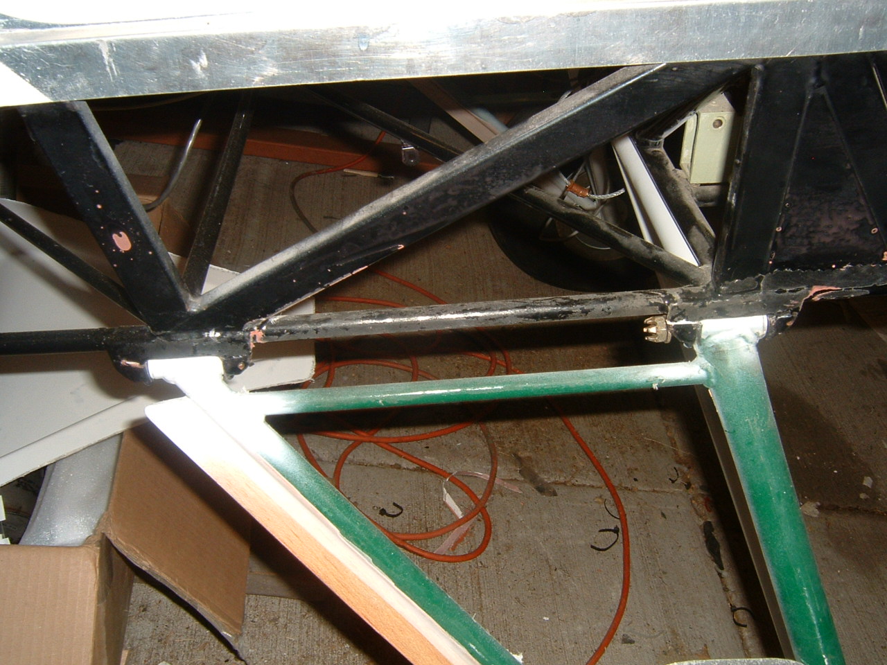

Here are pictures of my IV with Grove gear. As you can see, the Grove
gear uses the front two float brackets on each side, to mount the
gear. I kept the picture size small to avoid a lengthy download.
This shot was taken during the temporary assembly stage, and does not
show that actual hardware that I used.
Lynn Matteson

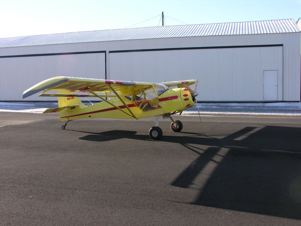

PostPosted: Fri Jun 12, 2009 3:28 pm    Post subject: Re: model 5 gear pictures Reply with quote

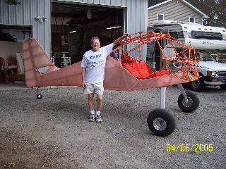

A few more model 5 landing gear pix
 Filesize:  318.16 KB
 Viewed:  13447 Time(s)
 Filesize:  315.83 KB
 Filesize:  319.42 KB
 Filesize:  316.39 KB
 Filesize:  312.31 KB
Joel Mapes Kitfox 5 912 ULS Aerocomp amphibs

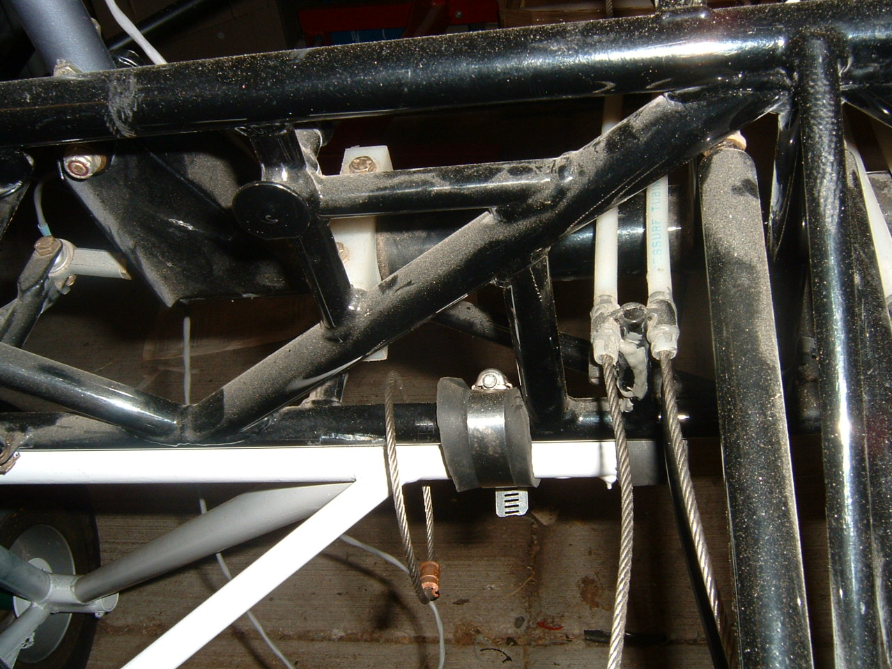

PostPosted: Fri Jun 12, 2009 10:44 pm    Post subject: Re: model 5 gear pictures Reply with quote

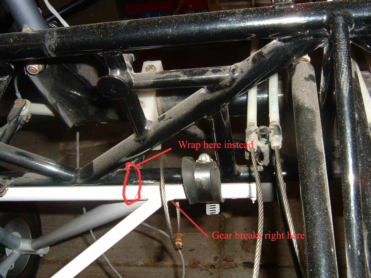

One suggestion based on personal experience. Dont put the safety cable on the end of the gear leg like yours is now. Put it inside the cluster where the rear kicker comes in. My Avid, and my Brothers kitfox BOTH had a gear failure from cracking that started at the toe of the weld where the rear tube comes in. With the bungies on you cant see the cracks starting. On my Avid the result was the leg broke off and the cable had nothing to hold up so over he went (but I did get a damn good deal on a bent airplane because that was the second time it had happened and he was not able to repair it the second time). On my brother KF II the exact same thing happened but we were both in it. bounced a little but not bad, when he came back down the gear folded and over we went. Kinda ruined the day for us both and cost a few bucks for him to fix. It could have been prevented in both cases if the safety cable was located in an area that was not prone to breaking. If you have to change the gear, you would have to cut the cables, but that is a very small price to pay to keep the bird in one piece in the event of a gear failure.

PostPosted: Mon Jun 15, 2009 8:35 am    Post subject: Re: model 5 gear pictures Reply with quote

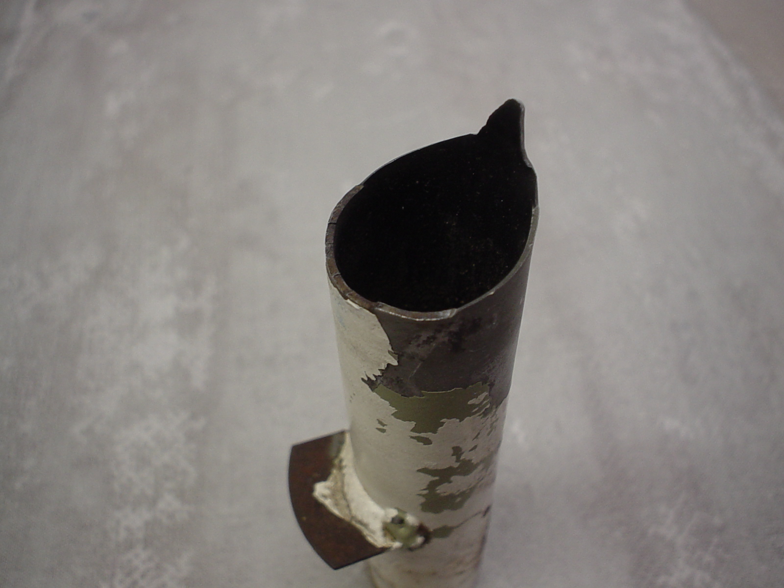

This will give you a visual.
The bottom pic is a shot of the gear leg where the bungee wraps around on my brothers KF II. As you can see from the rust it was cracked for awhile before it turned loose on a hard landing. This is right at the toe of the weld where one would expect a crack to start, and the pic represents exactly what also happened to my Avid TWICE before I got it.
Take it with a grain of salt, after all, I do sell snake oil lol
