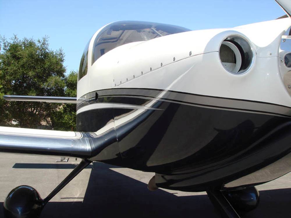

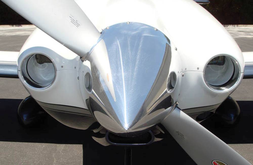

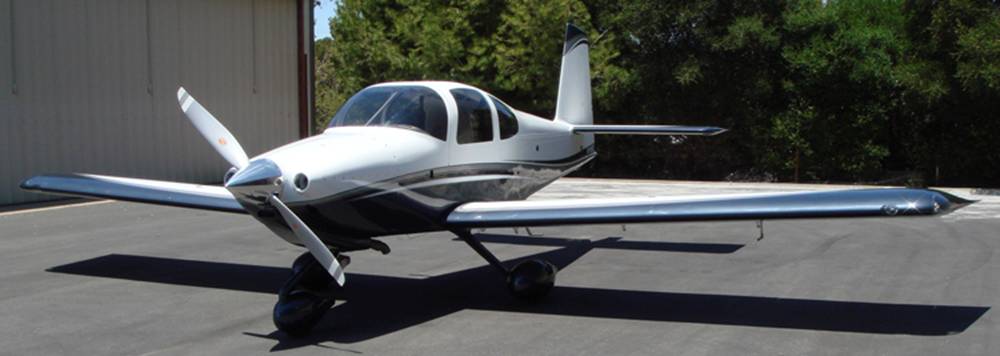

  This is a loaded question. As I am one of the few flying -10 SJ Cowl & Plenums I will take a stab at it.
  There is absolutely no actual engineering in the James cowl. It looked good to them so they made one for the 10 with no specific reason to be that shape and inlet size etc… As far as install it’s really not much different than the standard cowl but you have to consider the Plenum too. Again not much more work than the baffles on the standard cowl. You also have to know if you are using Carb/FI//Cold Induction etc… That being said once you are flying there will be a fair amount of trial work to get Oil Temps & CHT’s down. The outlet area on the cowl is not sufficient to allow for adequate air flow over the cylinders and out the bottom. Especially with the awesome Forsling exhaust that flair out and further reduce the outlet area. Deems was fortunate enough to build on our experience by immediately adding several sets of louvers to the bottom of the cowl. Ideally one would add a set to the oil cooler side of the cowl to aid in air flow through the oil cooler but we both didn’t want to ruin the lines. That Deems is so vein. The unfortunate thing about BOTH cowls is the poor airflow through the oil cooler wedge and out the cooling fins on the oil cooler. Someone makes an insert to better take advantage of the airflow through the oil cooler but barely. Plan on upgrading to the larger 2006 oil cooler (at minimum) with this combination. We actually reconfigured the oil cooler to receive direct RAM air into our even larger 2008 oil cooler. This had the added benefit of not taking oil cooler air from the plenum providing more air to cool the cylinders.
  To answer your question I would do it again? If I know what I know now then most likely but all the R&D initially required made me wish we stuck with the Vans plans. You may find that once you are flying that Vans idea of simple, light & plans built is a pretty good option. That being said it is undeniably good looking

you guys are making me glad I went with the Vans plans. The only thing I had had to do was eliminate the air dams in front of cyl 1 and 2.for AZ weather
