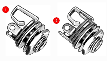

I really don't like those things . . . they use
a miniature phone jack that looks like #2 in the
view below.
[img]cid:.0[/img]
It features a normally closed switch strut to
provide "feed through" of antenna connection to
the panel mounted comm. This "switch" is low
pressure, exposed to atmosphere and not terribly
reliable. If the thing gives you problems, the
intermittent will be with the panel mounted
radio.
I would prefer/recommend breaking into a coil
bit of slack in your regular comm antenna coax.
You shouldn't have to do this very often which
offsets the inconvenience.
