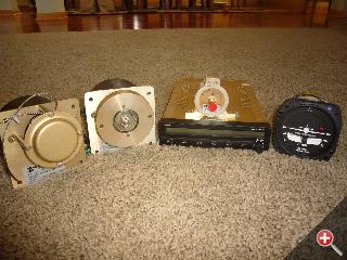

I have the chance to get one of these auto pilots very cheap however I cant get on to Stec (they do not answer there phone ) to see if they will work on a RV10. I have some numbers and was wondering if somone on the list new anything about these auto pilots. There is a picture at the bottom of the numbers.

IMHO, STEC made a very good product, but the company and customer service have gone down the tubes. They absolutely refuse to allow transfer of their STC between certified planes, for any amount of money. Apparently the management changed when Cobham came in, and it isn't a good picture. Given that even if the autopilot were given to you, you would have to fab all the interconnects, and any repair or parts would cost you certified prices, why bother, compared to Trutrack, Dynon and others available in the OBAM experimental market.
