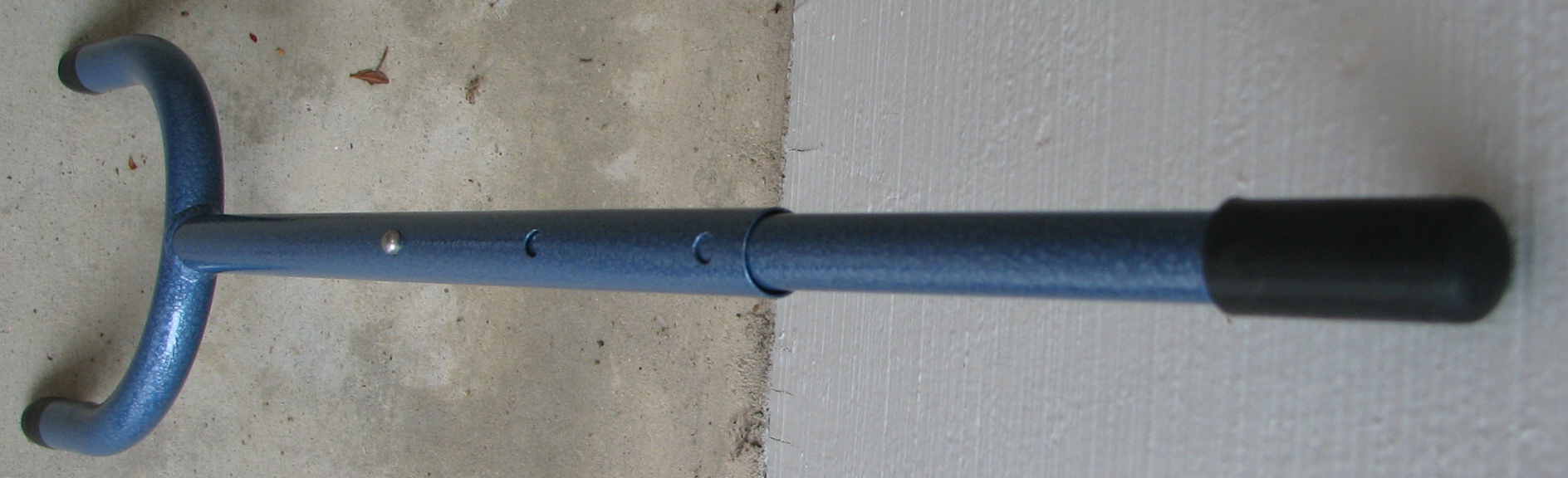

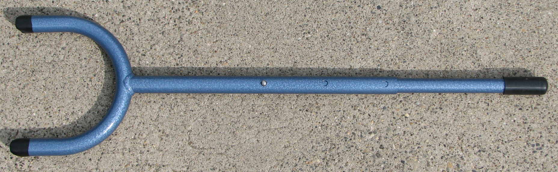

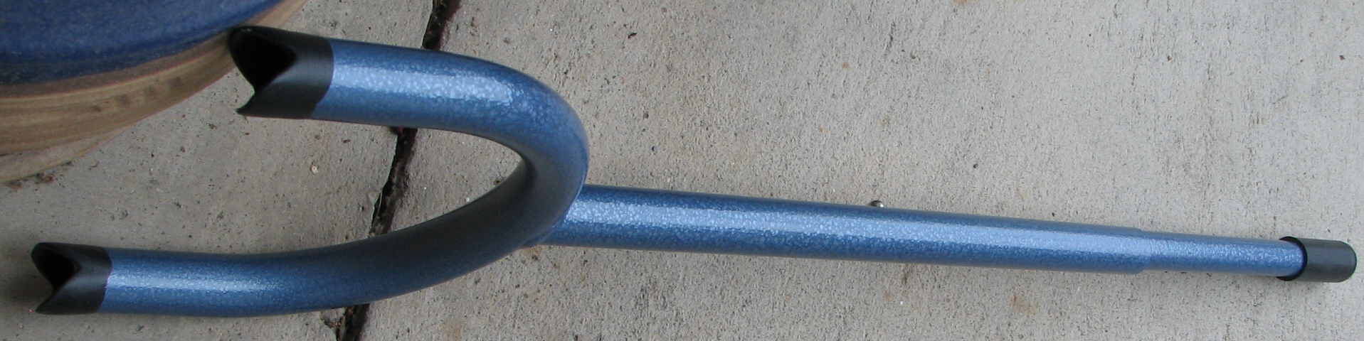

This is roughly the final product.... only difference will be totally radius-ed feet to fit around the pedals. It weighs a whopping 5 oz. I believe it should be adjustable enough to work on any of the RV's. I will try a few in the next few days. This can be accomplished by shortening the long rod and using a shorter spring. The spring is included. With the spring under some compression the length is 24". Seems to work perfect on my 10. Not sure of cost, but less than $50.
Don McDonald
Ignition problem discovered, first flight within a week.

It's made of aluminum tubing.... the feet are dipped in a plastic bath.... and to use it as an aileron lock all you need is a short piece (6") of velcro.... wrap it around the gust lock and the stick. The spring loaded pin is there just so it can be stored as a shorter unit. You can put as many holes as you'd like, or just one that compresses the spring all the way.
Because I needed one quickly, I also made a pvc unit. It worked well, but was heavy, bulky, and uglier than sh%&.
I installed it today and then went to the back of the plane and shook the heck out of the rudder just to see if I could shake it loose.... no problem, it hung right in there.
The other advantage is that you will NEVER be able to take off and forget to remove it..... no matter how oblivious you may be.

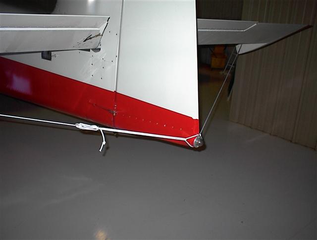

I've had a rudder lock (ATP) for some while now and it works great.  However, use caution when connecting it by a velcro strip to the stick for an aileron lock.  In gentle or moderate winds/gusts it'll do okay, but if there are significant gusts you'll find your whole contraption on the floor having been loosened by the strong side force of the stick.
Tim Olson

I'd stick with the seat belts to secure the ailerons. (Actually
it's good for the elevator too. I'm a little leery of the
spring loaded rudder gust locks because if it isn't a locked-in-place
setup, the wind could blow the gust lock compressed and then it could
pop out. I've known people parked in 40+ mph winds that
had problems in the past. So a solid locking method would be good.
My gust lock isn't pretty, but with an added strap from the fork
to the stick, I am able to neutralize the ailerons, provide
a solid lock to the rudders, and neutralize the elevator too.
It could be built prettier, but I really like the function.
Tim Olson - RV-10 N104CD

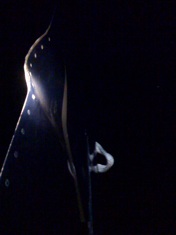

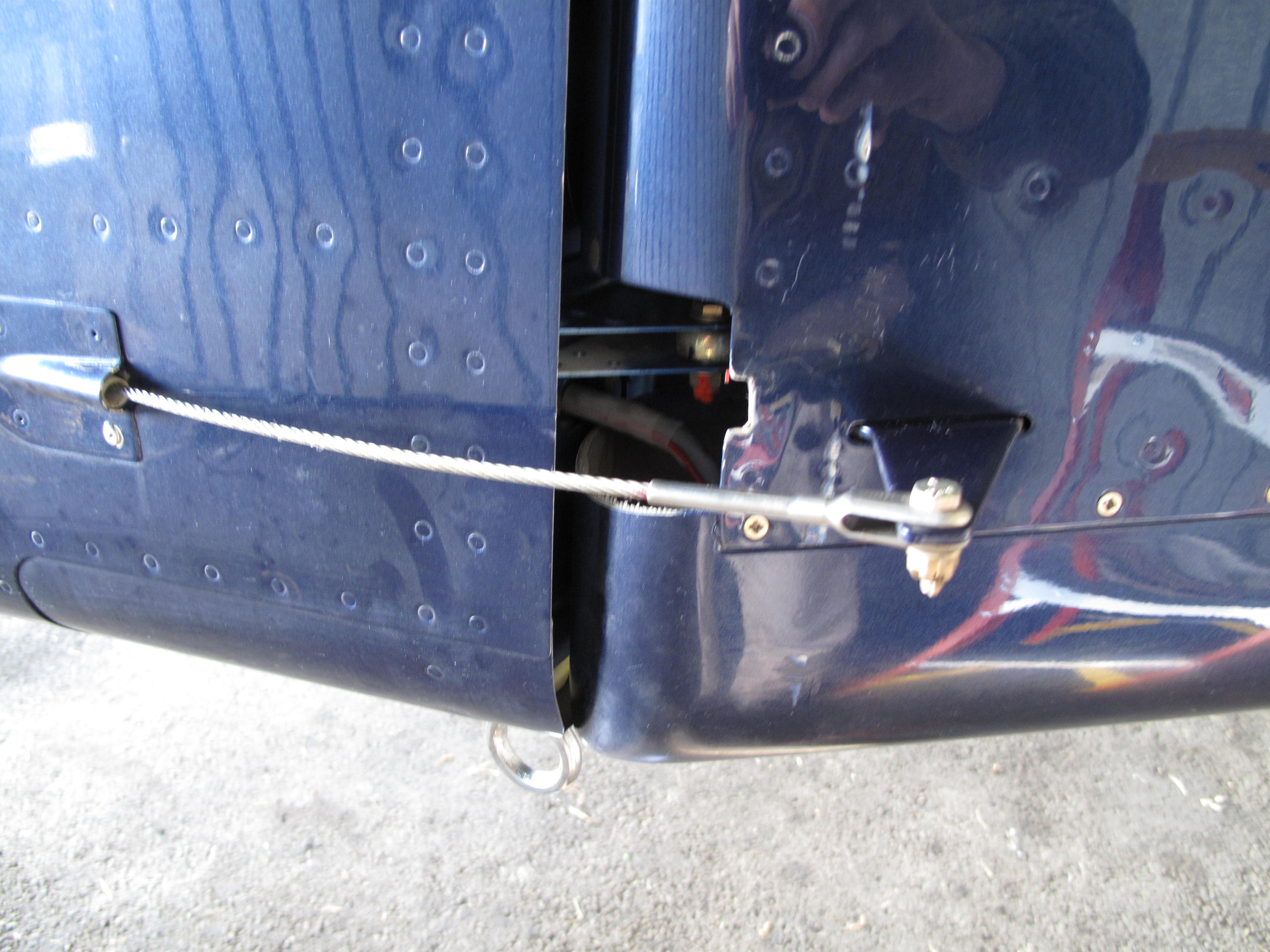

PostPosted: Sun Jun 07, 2009 4:59 am    Post subject: Rudder/aileron Gust Lock Reply with quote
No offense meant to whoever makes that lock, but attached is a picture of a -10 that had one of those locks on and had a visit from some fairly strong wind.
do not archive.

That one is spring loaded as well. With a solid lock I think
it would work ok.
do not archive.
Jesse Saint
Saint Aviation, Inc.
Cell: 352-427-0285
Fax: 815-377-3694
[img]cid:201571518(at)07062009-231A[/img]
[img]cid:201571518(at)07062009-2321[/img]

PostPosted: Sun Jun 07, 2009 8:21 pm    Post subject: Rudder/aileron Gust Lock Reply with quote
And here is another way to make a gust lock. I attach it after the stick is
tied back with the seat belts.
