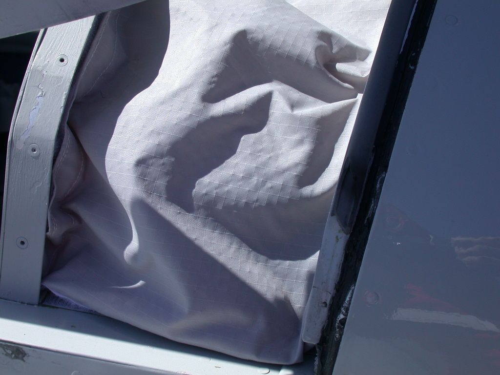

PostPosted: Wed Jun 03, 2009 11:28 am    Post subject: Tilt vs Slider Reply with quote
yeah - a guy named Fred Stucklen in CT did a clever thing with waterproof fabric over the area, held in place by velcro strips fwd & aft
i'll see if i can scare up some pics of it
brian

PostPosted: Wed Jun 03, 2009 12:12 pm    Post subject: Tilt vs Slider Reply with quote
here's a picture of how Fred covered his avionics under the tipup
i plan to do something similar
the nylon is held in place fwd & aft by velcro strips

PostPosted: Wed Jun 03, 2009 7:27 pm    Post subject: Tilt vs Slider Reply with quote
[img]cid:C41380D0119349C58F24517411F15916(at)lroomlaptop[/img] [url=http://g.msn.com/5meen_us/171?path=/photomail/{c294a79c-df87-4649-9c81-ba056beee210}&image=F3D1452E23ECF708!206&imagehi=F3D1452E23ECF708!204&CID=-877844387886991608]Play slideshow[/url] [img]cid:F84FF1A9FC3C47E695B6F14441459CD7(at)lroomlaptop[/img] Learn how Online pictures are available for 30 days
he's a pic of a rv6a I did in 2006, any moisture is channeled to the sides.
steve
iflyrv10.com
[img]cid:998F676C0C924461969879FF4EBE0E05(at)lroomlaptop[/img]

I've heard of problems with tilt-ups getting water inside the avionics. I have a 7A with a slider and when I wash the plane or it rains hard, I get "some" small amount of water dripping from the junction of the slider and the windscreen. Does anyone have a cleaver way of preventing these leaks?
