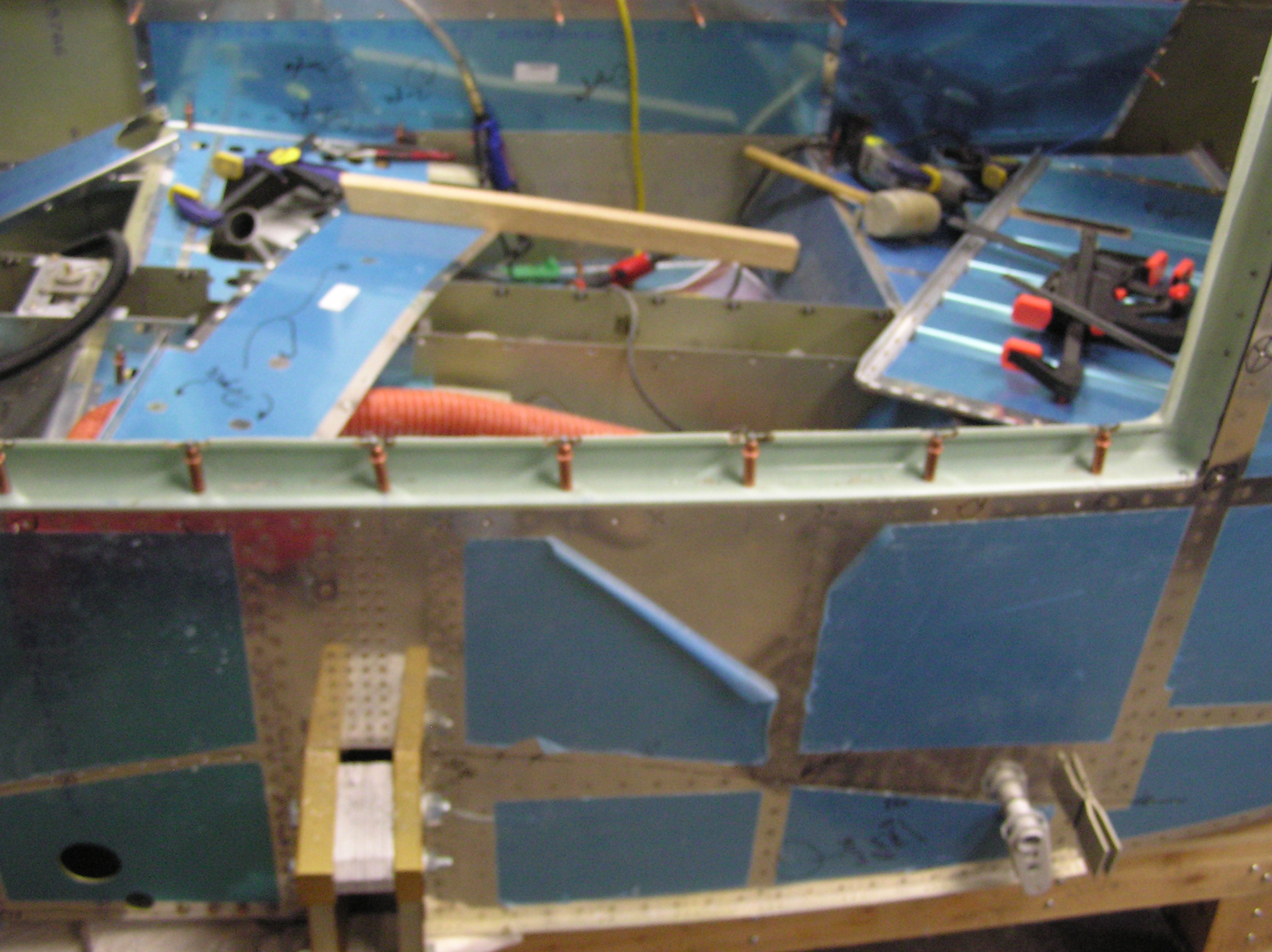

I had exactly the same concern; in fact I called Van’s about the size of the gap between the door and the lower door flange on the canopy.
Initially, when drilling the screw holes, I cut notches in the canopy cover to allow access with a drill. I clecoed the holes from the back site and haven’t final drilled / countersunk the holes yet. The cleco tips don’t interfere with the doors so this is not an issue. The attached pix is not great, but you can see where I cut notches for the clecoes. Later I inserted the clecoes from under the door sill.
Prior to fitting the doors, I cut to about ¼” of the scribe lines. I was concerned about the apparent gap between the door and canopy when I was setting up the doors for gluing. What I found was that this gap all but disappeared (except for the lower flange) when the doors were cut to fit flush with the fuse / canopy door opening. I ended up cutting back to and in some places past the scribe lines. I was really surprised at how much the gap decreased. The place to be careful is the lower door flange. If you trim this to the scribe line, you may find the gap to be much larger than you desire (depending on what you are using for weather seal.
Understanding your concern, I would cut the canopy back so the inner door half sits easily in the door opening without making contact with the canopy flange. After gluing the door, be prepared to trim back further as required when fitting the door to flit flush in the opening. It is more work but less stress.

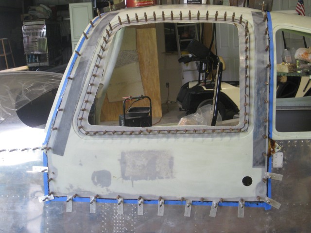

Les, thanks for the note! This morning we glued the pilots door halves
together. Attached is picture. You can see the tabs I used to hold the
bottom door tight to the fuselage. The door halves fit really well
together, and did fit the contour of the fuselage with the exception of
the very top where the hinges go. Also, the angle of the two halves was
different in the area of the third cleco up where the windshield will
be, and I just filled that with epoxy/milled fiber. All in all, the
gluing went well, but it was really messy!!!
Now comes the trimming/sanding/filling/sanding/contouring .....
