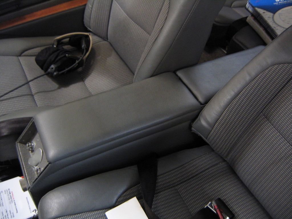

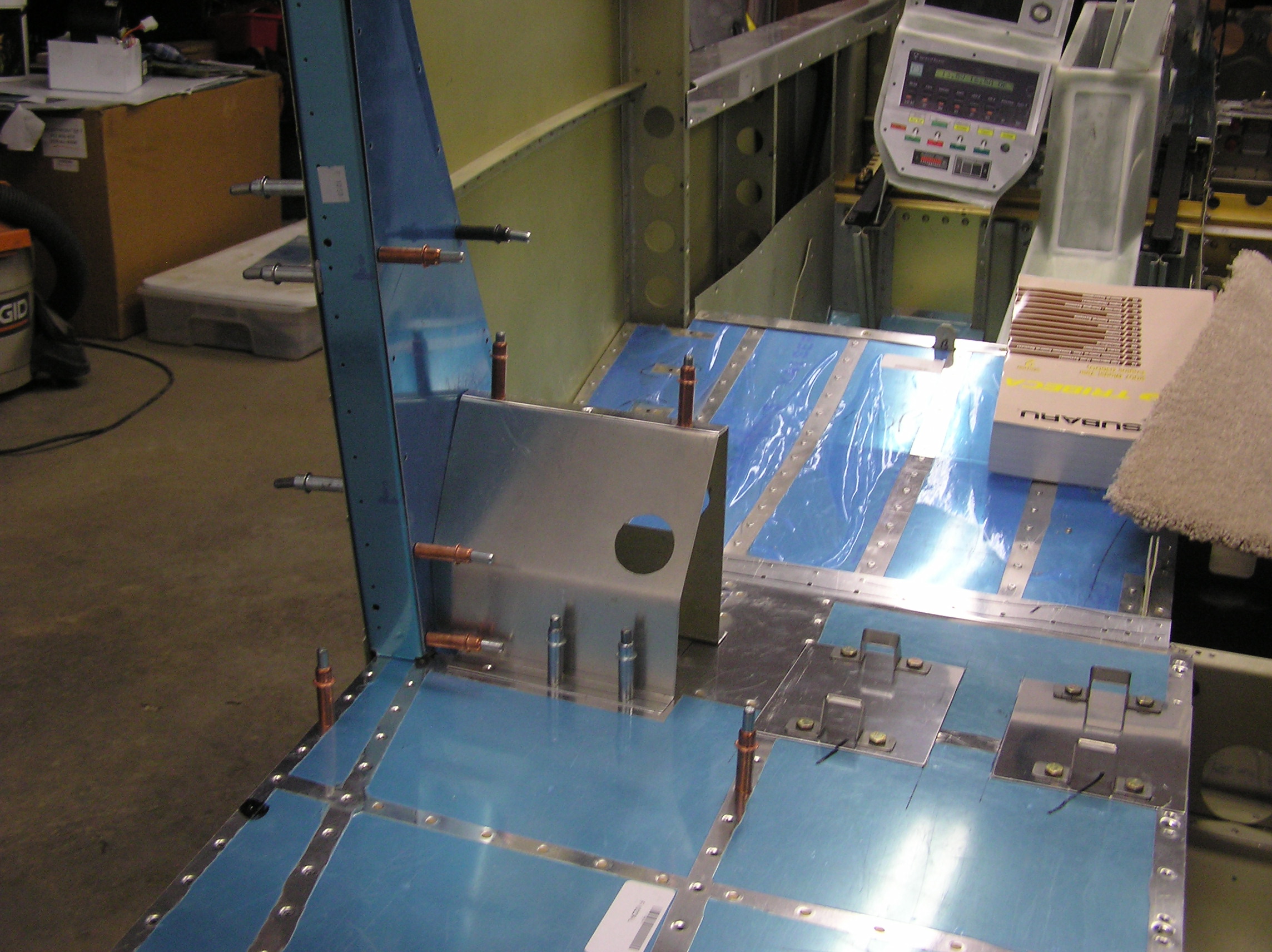

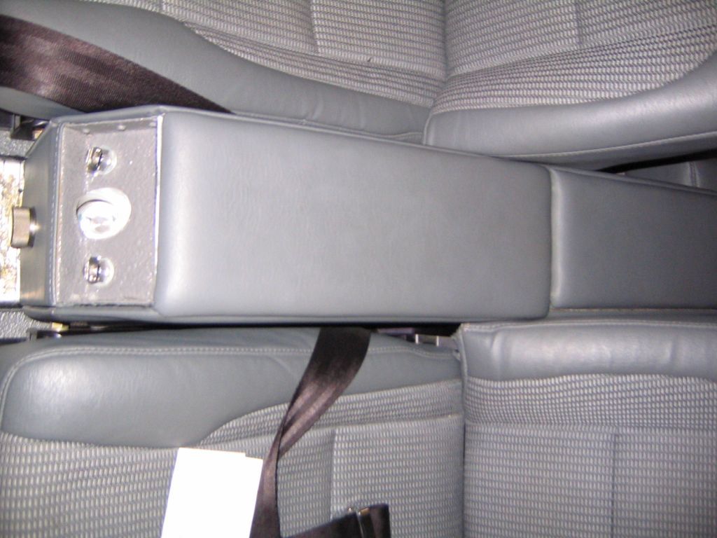

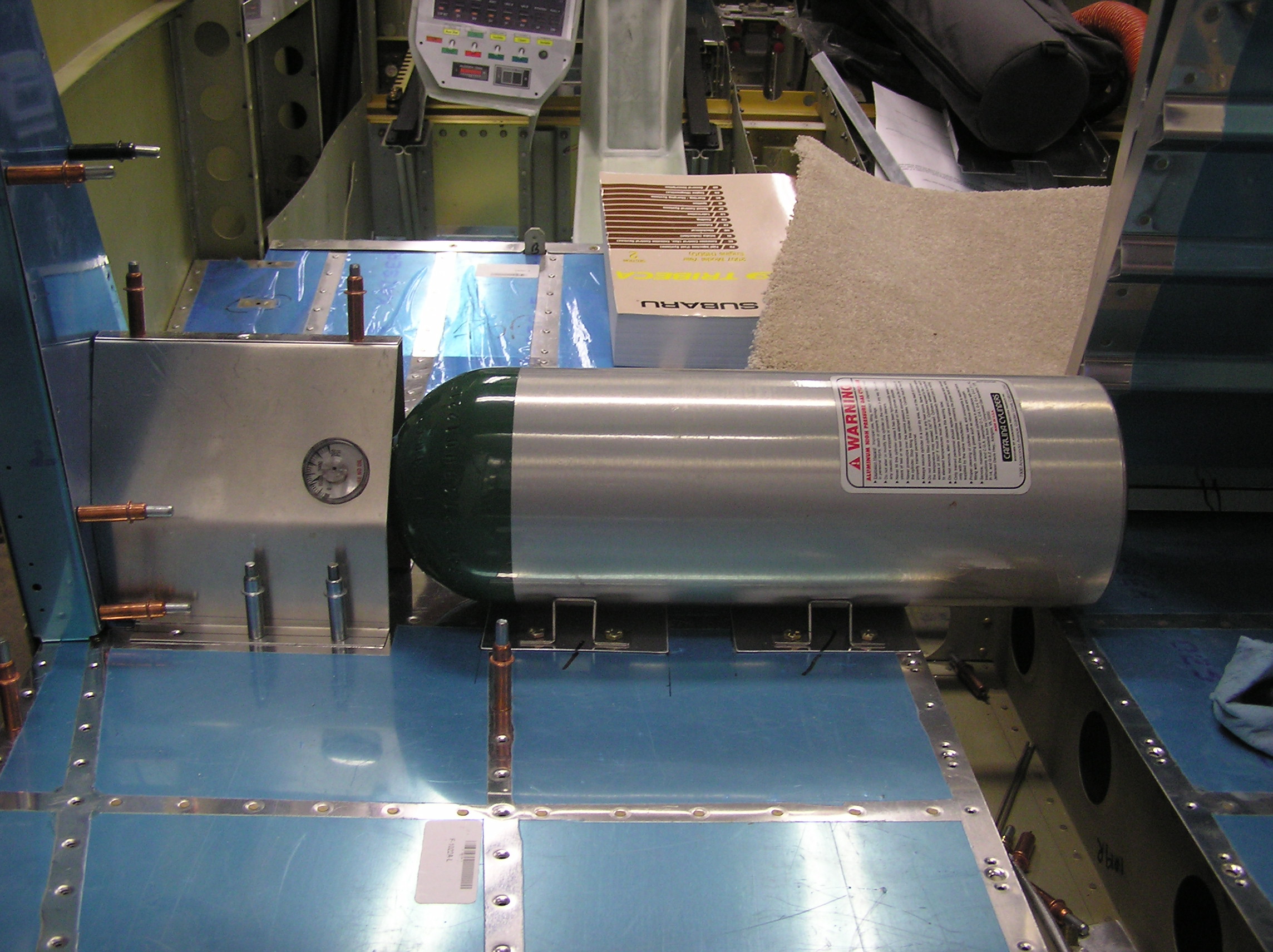

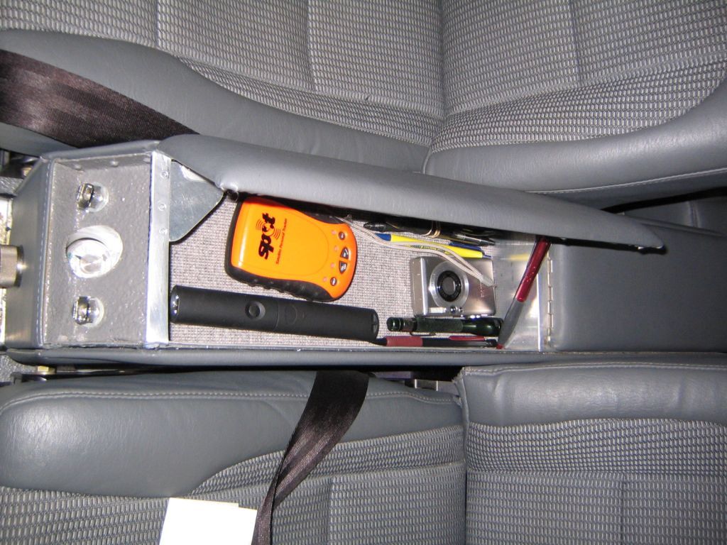

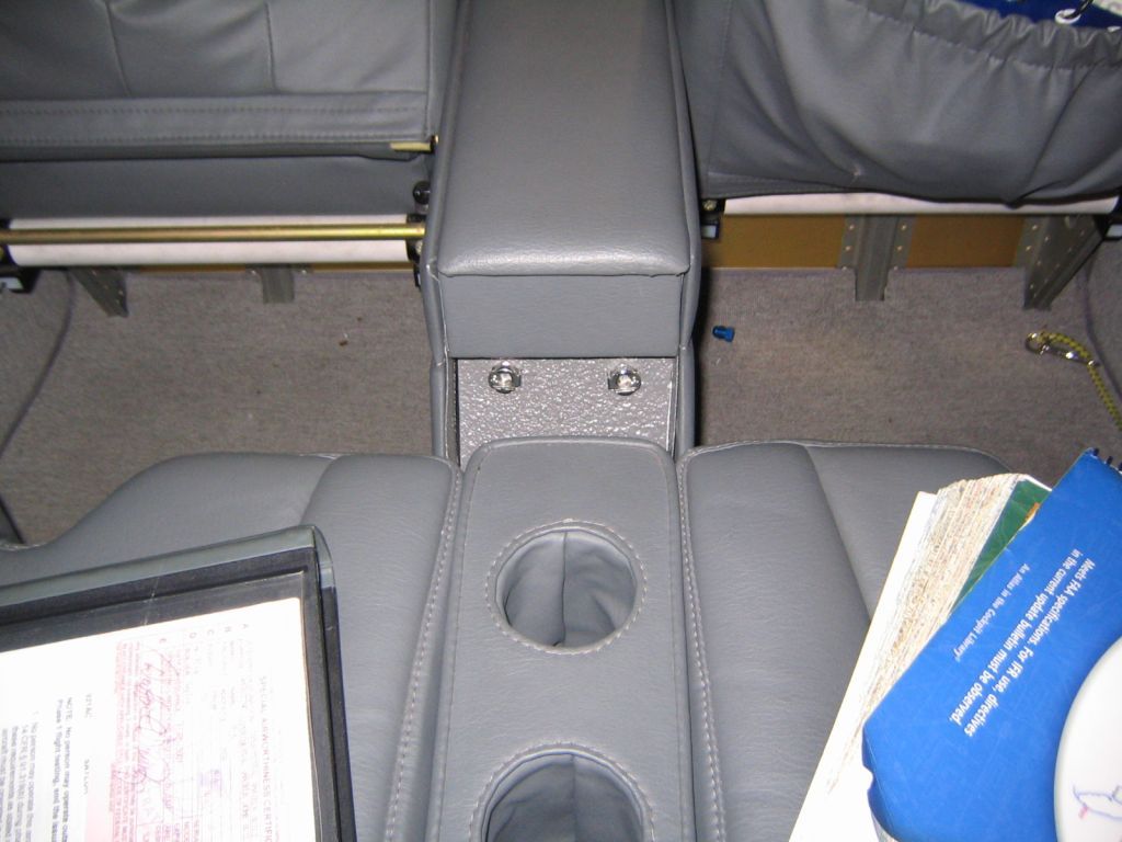

PostPosted: Tue May 26, 2009 8:39 pm    Post subject: Portable oxygen Reply with quote
Here are some photos of my center console. It has an E bottle inside, on top of the tunnel. All of the parts were mix-and-match from Aerox. The console attaches with two hinge pins up the sides (what else...?)
The ox system started as their portable kit. The standard valve protrudes from the front of the console, and the round tube loosely surrounds the quantity gauge, seen by looking straight down. It works really well, but I do plan to put a filler port in the console somewhere. Now I have to remove it for filling, which takes about 15 minutes in/out.
