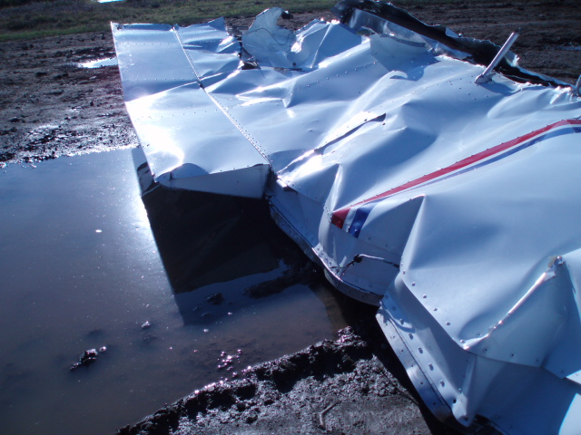

craig(at)craigandjean.com
PostPosted: Sun May 24, 2009 1:31 pm    Post subject: GVT? Reply with quote
“Someone on this site stated a month or so back that all of the 601XL accidents involving "suspected aileron flutter" were of the hinge-less design”
No, I don’t think this is correct. The Yuba City plane was built by AMD and had piano hinges. The post-crash photos show this (I’ve attached one). I believe there are hinged and hinge-less planes among the unexplained crashes.
-- Craig

(5) Someone on this site stated a month or so back that all of the 601XL accidents involving "suspected aileron flutter" were of the hingless design. Am I correct?
No, just the opposite. They were all of the piano hinged variety.
If I'm wrong, then I welcome a correction with supporting data.
Does anyone have a concrete example of an XL having gone down that had the standard hingeless design? If so, please share a photograph.
- Pat

PatrickW wrote:
- Pat
That would have been me. I did some research and could not find an proof of an example of a hingeless 601XL in the 6 accident aircraft. I even asked over at ZBAG and they couldn't provide an example. I've since learned that there may be one but the info came second hand and and I've not been able to confirm.
