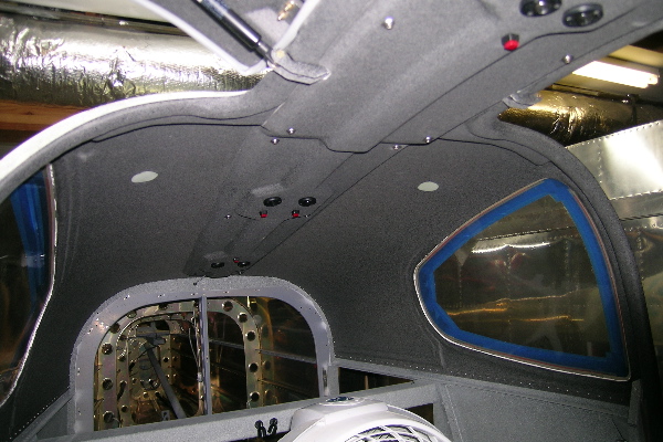

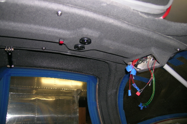

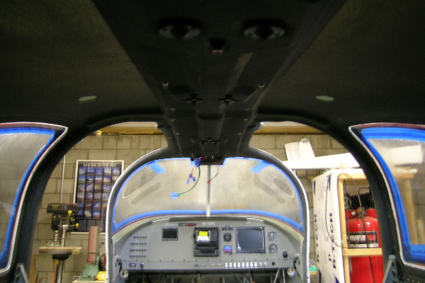

I used it and I like the results. Need the correct gun and follow directions. Even so I did not follow the directions perfectly and i still liked the result. I epoxied all the aluminum backing strips to the inside of the canopy so that I could paint that also while the top was outside. I was able to paint the door hydralic bracket later before the windscreen and doors went in.
JOhn G. FLying C the glider C not the 10.

PostPosted: Sun May 24, 2009 2:53 pm    Post subject: Zolotone - Anyone using it? Reply with quote
John
It looks like you used the same gray I am considering.
I have also benn looking at your console photos from a while ago with a view to doing something similar except I would like to duct overhead air in as well.
Thanks for the info and pix.
Cheers
Les
