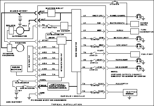

Not sure if this is relevant to your situation, but I just had a similar
experience with the EXPBUS output to the alternator. The IRF4905 MOSFET
that was controlling the 12V to the alternator was measuring 12V with no
load, but when connected to the alternator dropped to a low voltage.
Replacing that device on the EXPBUS resolved my problem, as of
today. Wink
The ammeter output was totally confusing during this time, in that it
was indicating 2A, but may have actually been indicating no charging
current at all. The battery was certainly discharging with minimal
loads.
If the LR3 "solid state" components include a similar device to the
IRF4905 it seems it's not so simple as just measuring the voltage at the
output, since it seems to drop as soon as a load is applied if faulty.
Good luck,
Ian Brown
Bromont
Quebec
Finally getting back to flying tomorrow!

At 06:09 PM 5/25/2009, you wrote:
--> AeroElectric-List message posted by: Ian <ixb(at)videotron.ca>
today. Wink
loads.
Not exactly . . . The mosfet in the EXP bus appears to
be used as a ON/OFF switch in the feature labeled OV CUTOFF.
It should be turned on hard at all times when not OV-tripped
so as to not upset regulator performance downstream.
[img]cid:7.1.0.9.0.20090526175330.01e5f6f8(at)aeroelectric.com.0[/img]
The LR3 does have a series control device used as part of
the voltage regulator system. The LR3 also features its own
ov protection that would NOT be compatible with an EXP BUS
installation. Bill cited a voltage reading on the order of
4.5 volts on the wire between circuit breaker and the field
terminal of the LR3 . . . this would cause the LR3 output
to be similarly depressed.
There's either something "unhooked" between the field supply
breaker and the field power terminal of the LR3 . . . or the
battery is REALLY soggy.
Bob. . .
