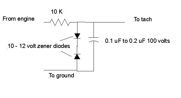

I used a standard VDO tach on my Stratus engine. The tach lead goes to
the ground side of the ignition coil. I did have some problems with an
unstable reading at around 3000 RPMs. I tracked it down to a short (2
msec) pulse that sometimes came from the system. I used the attached
circuit to tame the problem. Been flying over a year with a steady
reading tach.
