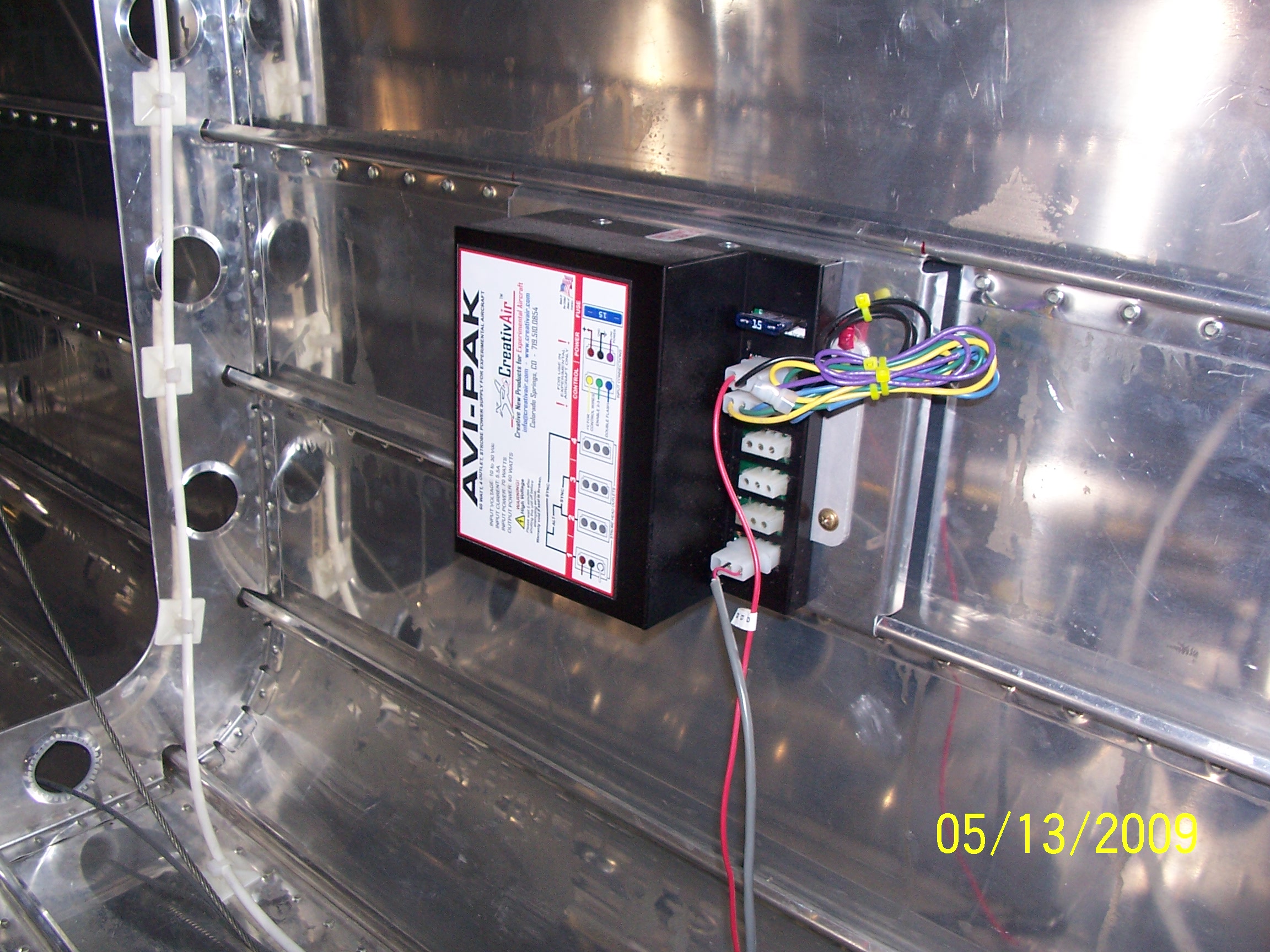

Does anyone have any installed or even not installed
photos of Van's sidewall mount for the tailcone where
you can mount the strobe supply to the wall?

Bob Turner
Joined: 03 Jan 2009
Posts: 885
Location: Castro Valley, CA
PostPosted: Wed May 13, 2009 10:47 am    Post subject: Re: Photos of Van's Strobe sidewall mount? Reply with quote

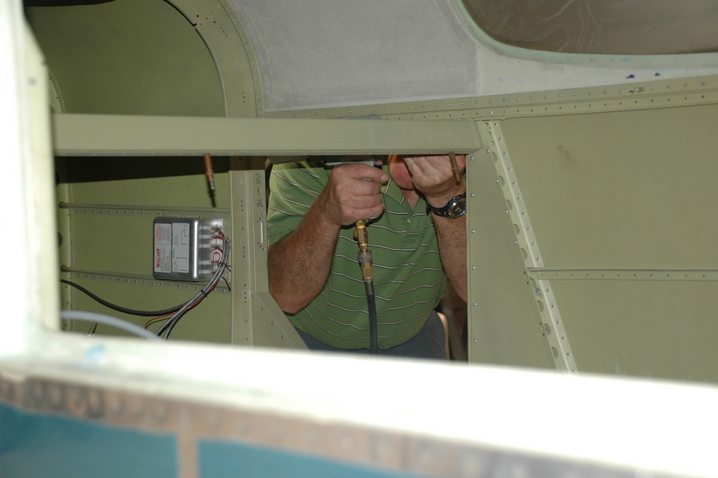

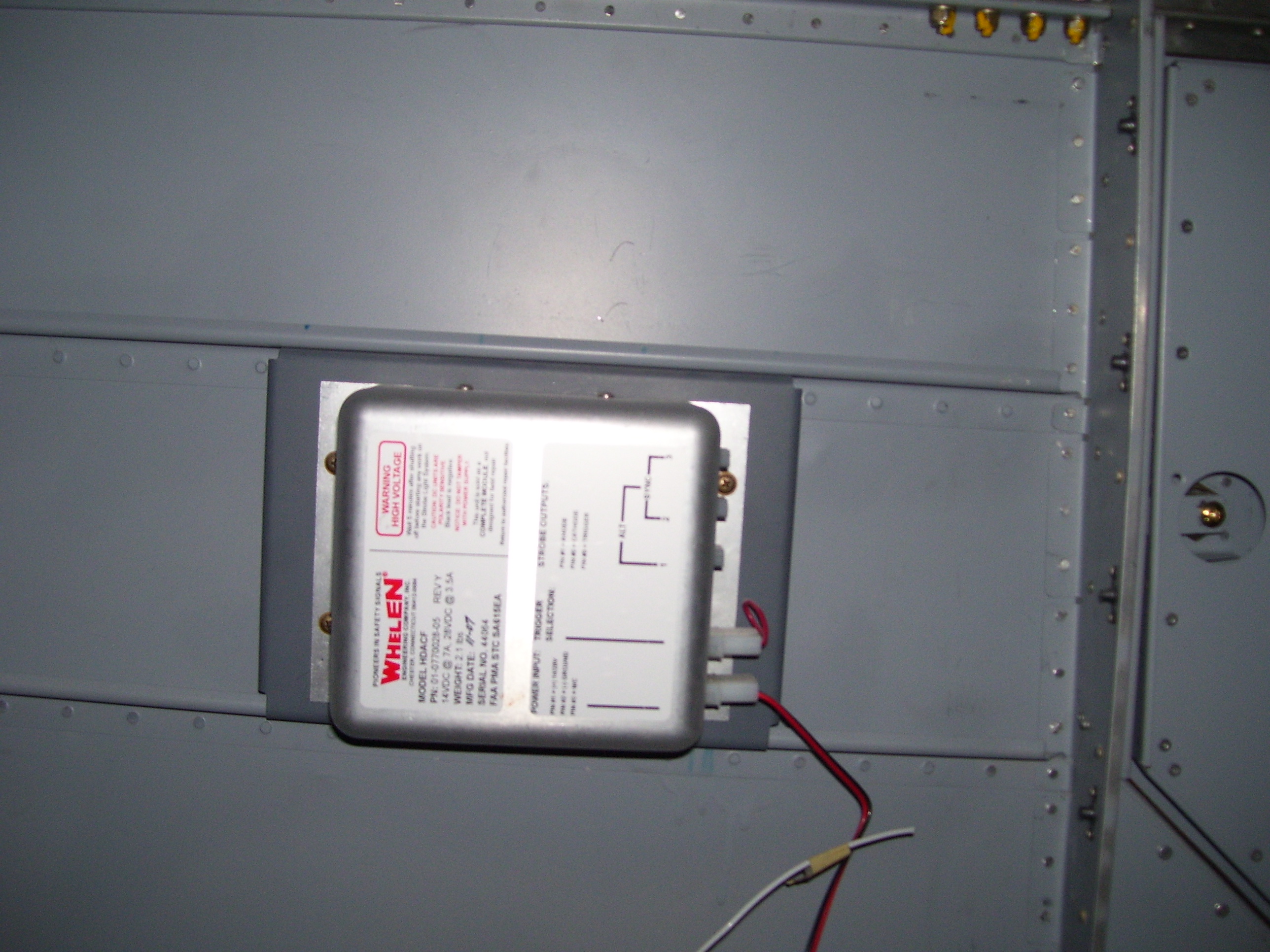

photos attached.
 Filesize:  1.23 MB
 Viewed:  5638 Time(s)
 Filesize:  1.25 MB

PostPosted: Wed May 13, 2009 11:04 am    Post subject: Photos of Van's Strobe sidewall mount? Reply with quote
Thanks Jesse. From you and another I've kind of answered my
question. That piece must fit between the stringers in
a taper so that it fits perfectly. But if I choose to mount
it lower to the floor, it may not do what I need, so I may
as well fashion my own.

daveleikam(at)wi.rr.com

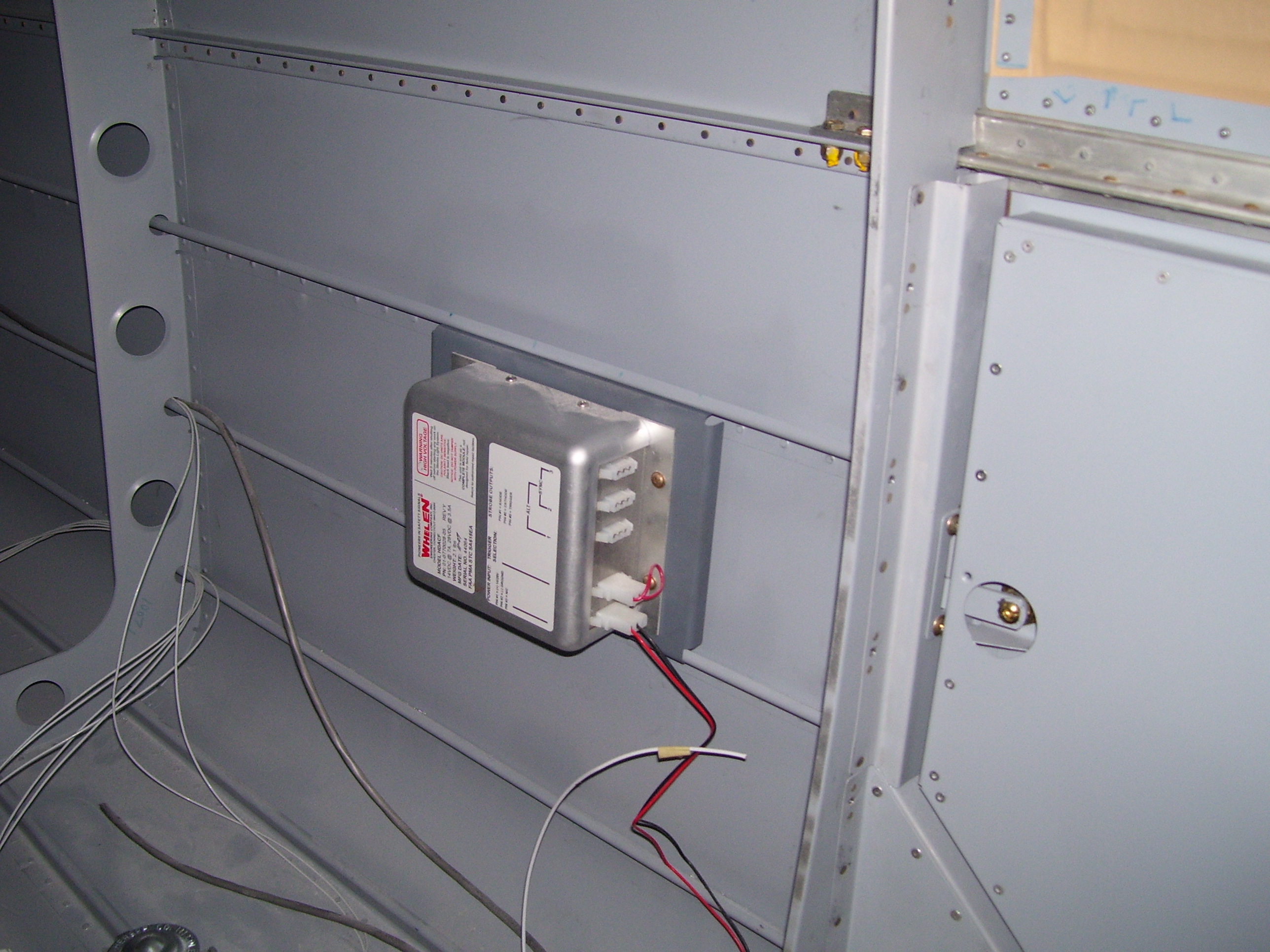

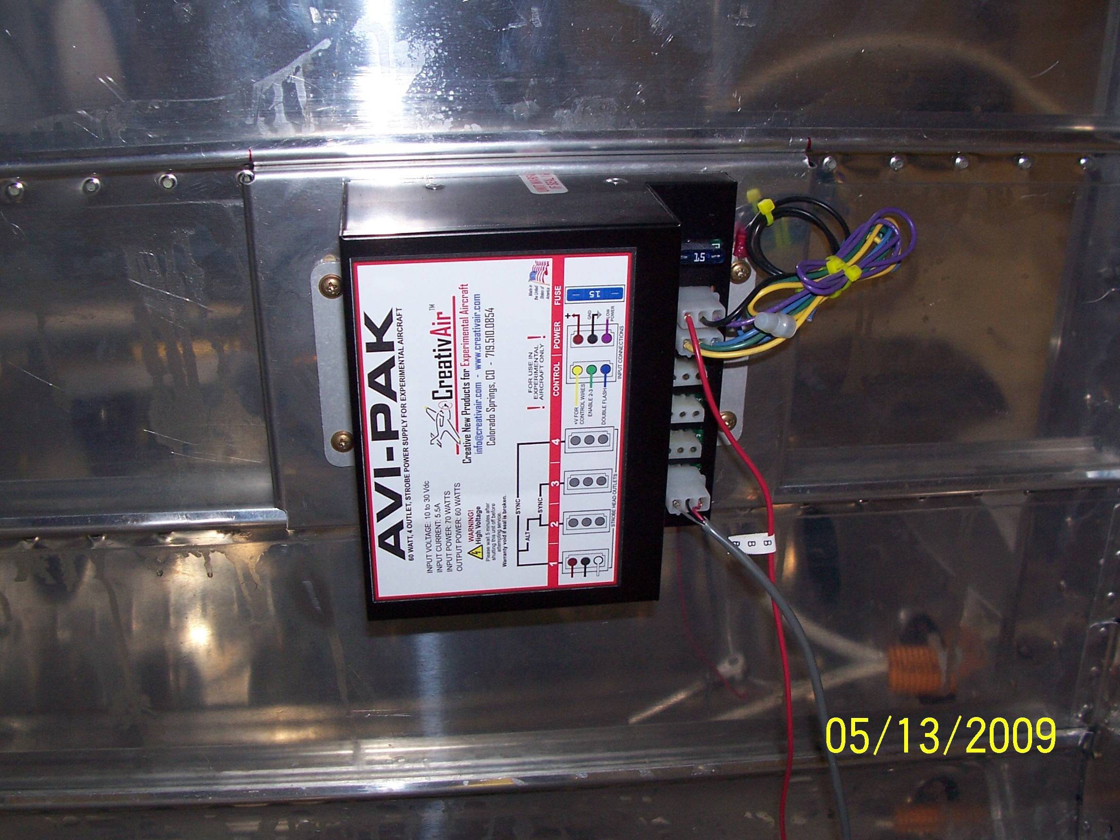

Here are some.
Dave Leikam
RV-10 #40496
N89DA (Reserved)
Muskego, WI
 Filesize:  902.68 KB
 Viewed:  5635 Time(s)
 Filesize:  891.52 KB

PostPosted: Wed May 13, 2009 12:35 pm    Post subject: Photos of Van's Strobe sidewall mount? Reply with quote

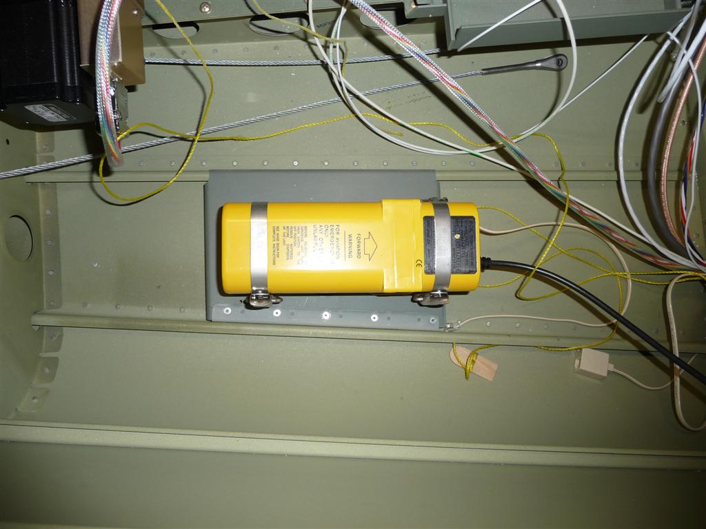

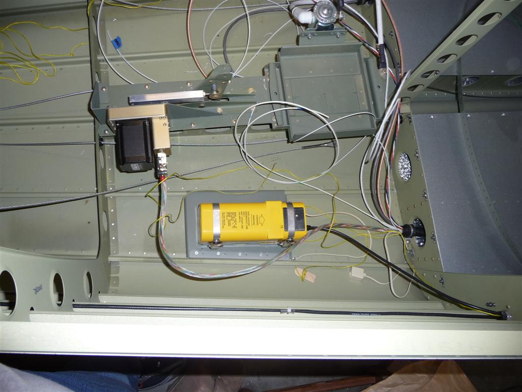

I modified one of the strobe/elt mount brackets to fit along the floor
attaching it to two of the J-Channel. I cut the end off parallel to the
J-Channel and used a piece of angle pop-riveted to the strobe bracket.
I suppose it would have been pretty easy to make one from scratch but making
the bends is sorta tough with hand seamers. I don't have any kind of a
brake. Van's is close (20min) for me so no shipping. The brackets are
pretty cheap.
Picture attached.
-Ben
 Filesize:  104.11 KB
 Viewed:  5625 Time(s)
 Filesize:  93.81 KB

PostPosted: Thu May 14, 2009 7:25 pm    Post subject: Photos of Van's Strobe sidewall mount? Reply with quote
Thanks for all of the great pics and stuff along the way guys.
That Van's plate would come in handy for mounting a bunch of
things. Wish they'd have had them when I built mine. But, it
wouldn't have been perfect for my needs anyway. I did get it
done last night though, and here is the result:
http://www.myrv10.com/N104CD/upgrades/20090513/index.html
The big difference is, I needed something easily removable.
Tim Olson - RV-10 N104CD
